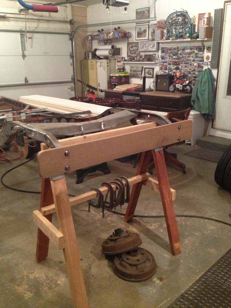

82 year old rusty frame
Discussion in 'The Hokey Ass Message Board' started by Runnin shine, Jun 27, 2014.
  1. Runnin shine
    Joined: Apr 12, 2013
    Posts: 3,385
    Runnin shine
    I need one more old fender to make a complete set to run with my PU
    I do have another spare but it won't match up, it's a four instead of a six.
    I've been wanting to make this lame joke forever now, it won't leave me be, Wyatt.
    "I need my mirror boy"
    blackandgold likes this.

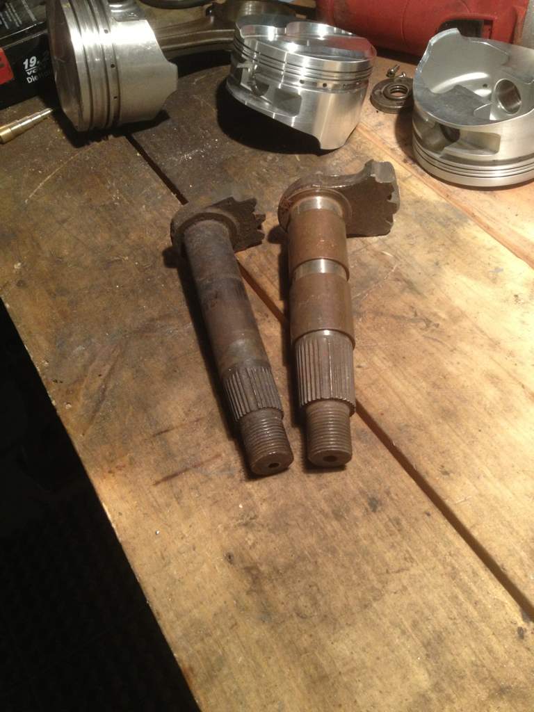

  18. Runnin shine
    Posts: 3,385
    Runnin shine
    So I've been scrambling up the pot quite a bit lately. I hope I don't loose my way. Monday I'm going to drop off my rear axle, front drums, four bones to get sandblasted. Then I'm gonna go mount and balance my wheels and tires.
    The real point of wasting any readers time with this post is this. I've begun to work on getting ready to ***emble the engine for my truck. I bought a bigger cam, short travel hydraulic roller lifters(i had solids before but i want drive this thing alot), H-beam rods, and am going to get a new longer stroke crank and lighter flywheel then take a trip to get the hole set up balanced. I didn't set out to build a 347 I already had a 331. I had found new pistons on ePay from a guy that when I got around to measuring the Compression height, i realized they wouldn't work with my 5.315 rods and 3.250 stroke crank. So now I'm working on a combo that may kick out another 25-35 hp. The reason for going with a bigger cam was to move the torque peak up to minimize blowing the tires off. I am trying to guesstimate all the variables of this build, gearing, tire height, truck weight, carb size and even cam degree to get this thing to perform the way I want ahead of time to limit tearing back into it. After the first of the year I think I will get at porting my new heads and intake so I can build the engine this winter.
    So now I am looking for another pair of 15" Mercs that are 6" or 7" wide for slicks. My ch***is fab buddy is going to bend me a chromoly hoop I can tuck away real good in my cab. Finally I've begun to plan out the final rear piece to my x-member that will tie the to halves reward of the tail shaft together and the drive shaft will go through to act as a safety loop, why all this you ask? Why? because I want to go to them there HAMB DRAGS!!!

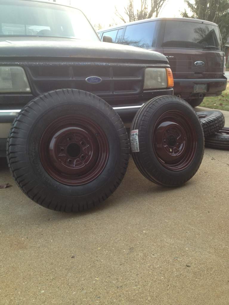

  22. Runnin shine
    Posts: 3,385
    Runnin shine
    Is it childish to find excuses to sneak into the garage to check out your fresh wheels and tires when they work out like or better than you hoped for?
