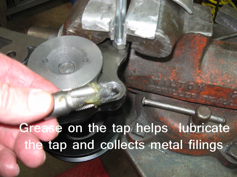

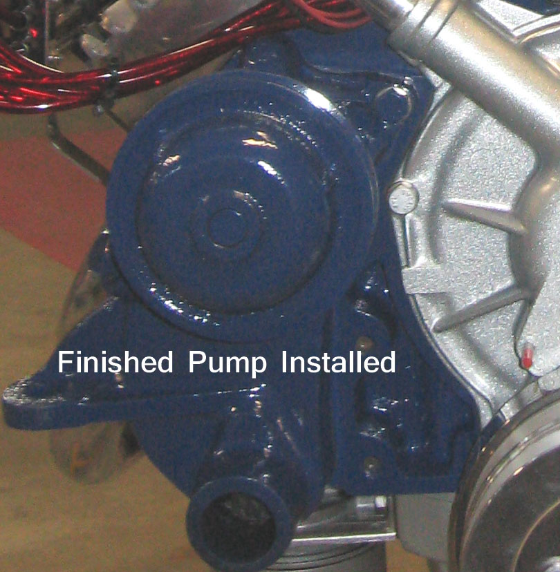

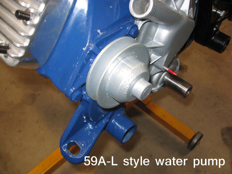

    WATER PUMP MODIFICATIONS:
    Uncle Mike wanted to run the 8BA style MSD electronic distributor on this engine instead of the crab style used on the 59 type engines. I initially installed the early 59 style pumps on the engine but soon discovered that there would not be enough clearance for the fan belt.
    Not the best picture but you can see that belt would have interfered with the distributor. [​IMG]

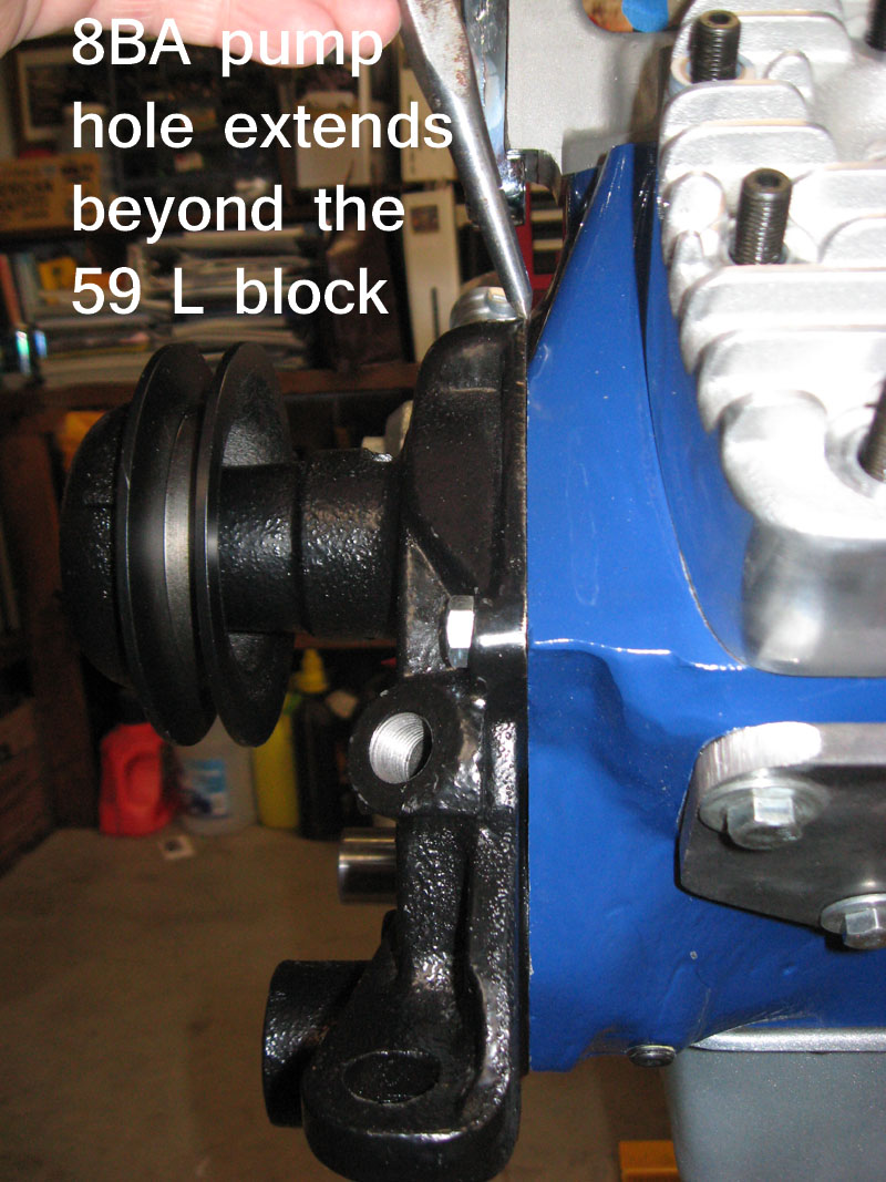

    So I ordered a new set of 8BA truck water pumps from Bob Drake. The first thing I noticed is that 8BA have and extra water outlet to the block that the 59 style pumps do not. [​IMG]
    You can barely see the drill punch pointing to the extra water outlet extending past the block. [​IMG]

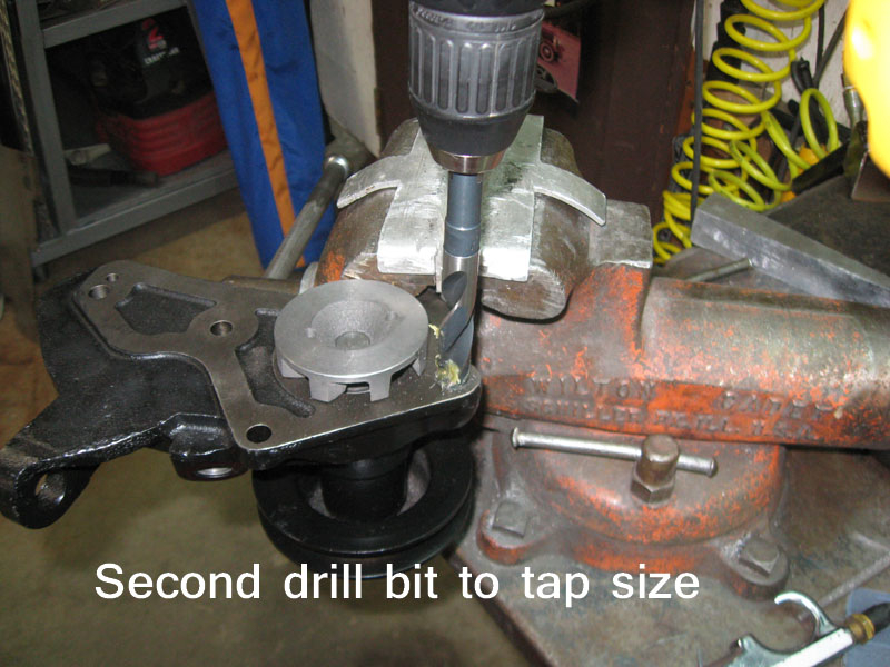

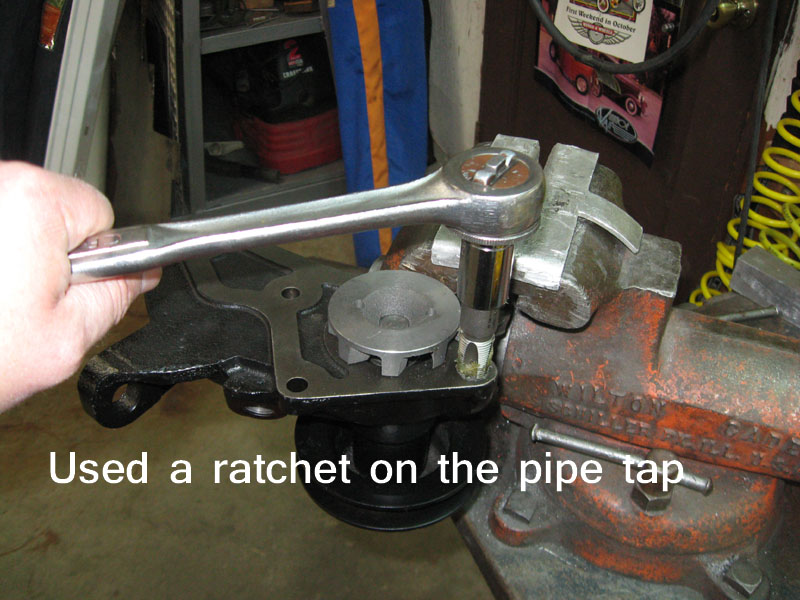

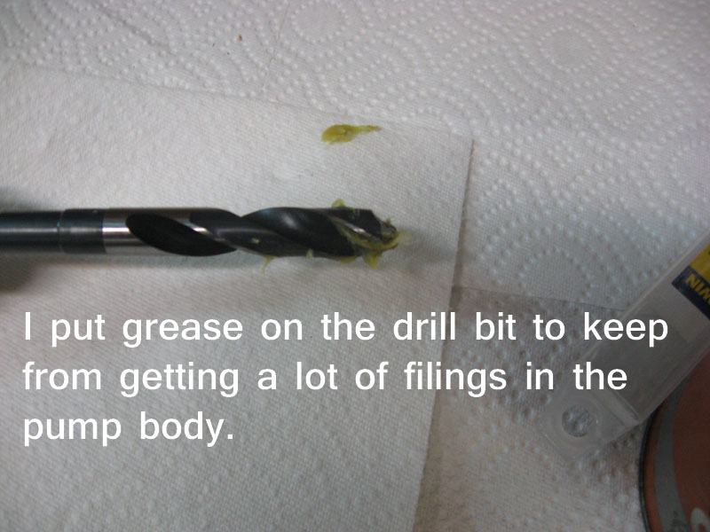

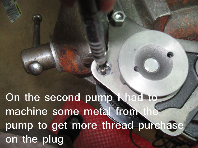

    So the decision was made to plug the extra port. The plan is to drill out to tap size and put a pipe plug in the hole.
    [​IMG] [​IMG]
    I think this pipe plug size was 3/8"

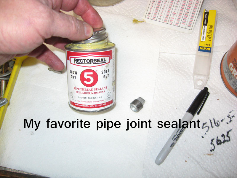

    I use this stuff on most pipe joints and especially any time fuel or oil are involved. [​IMG]

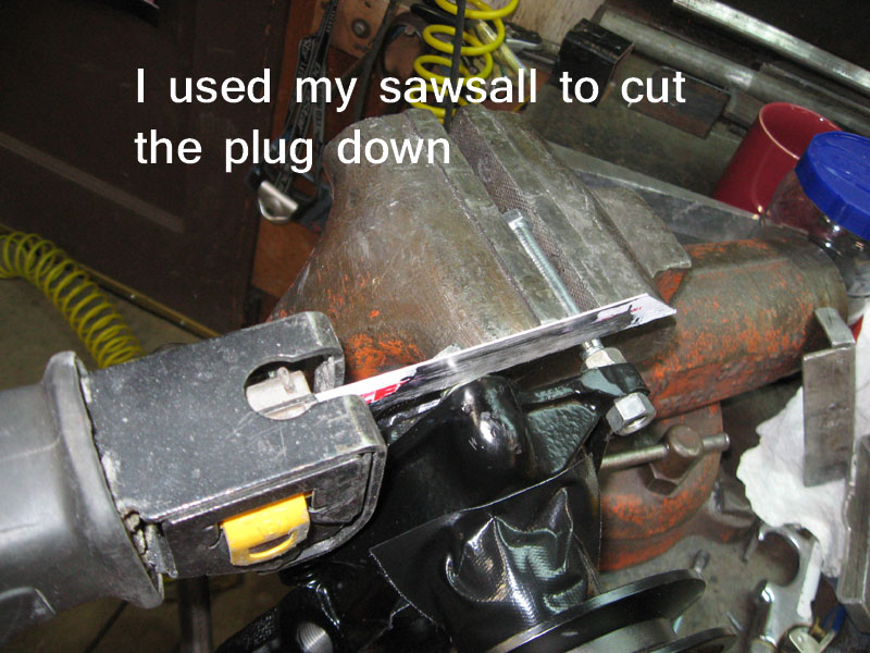

    Holding one of these pumps in a vice can be problematic I finally used this idea of inserting a bolt through one of the holes and clamping the bolt in the vice. You would not want to apply too much torque to this arrangement because you could brake the cast flange off. [​IMG]

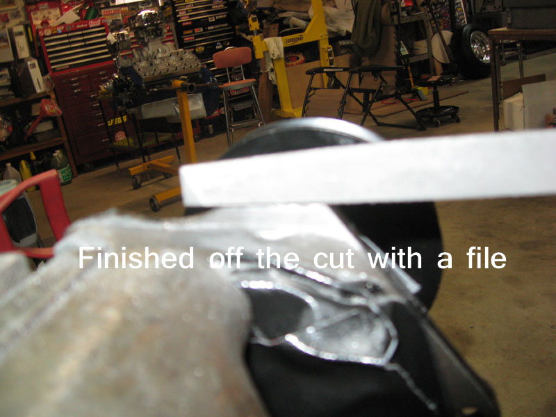

    The plug needs to be filed of flush with the pump sealing face.
    This pump gets the pulleys out where they need to be for the alternator. As usual each change you make seems to cause another part to need a modification. You can see a an aluminum pulley to the right in this picture. I had buy that pulley to work with theses water pumps. This modification also changed the alignment requirements of my alternator bracket. I will cover that modification next.
