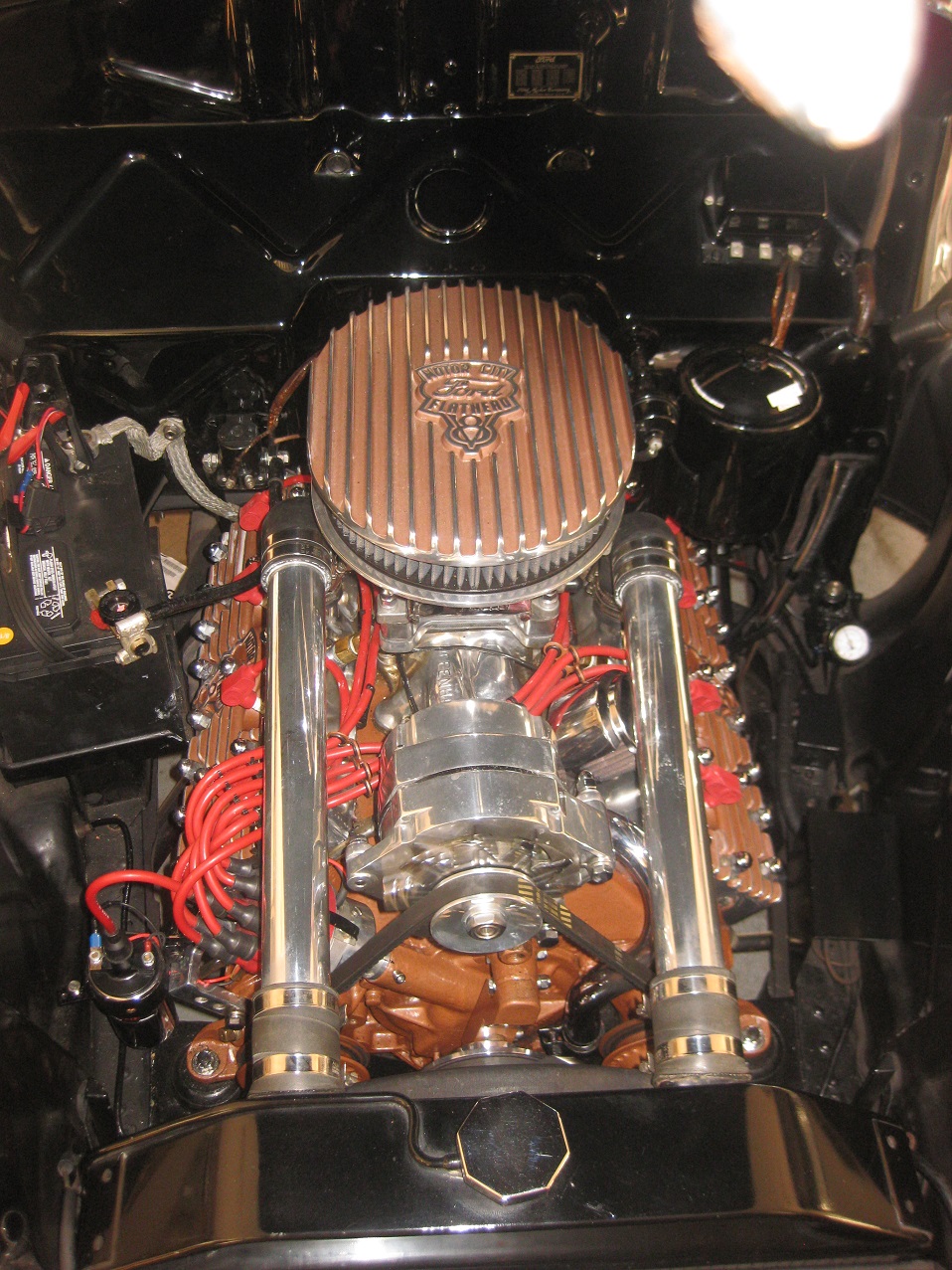

  14. 19Fordy
    Joined: May 17, 2003
    Posts: 8,371
    19Fordy
    3/19/24 Yes, I have the cast iron 8BA twin narrow belt pulley. Below is a photo of the 1951 mercury engine it was on along with the offset 1951 Mercury narrow belt water pumps that permits the use of 2 belts - one for each pump.
    A single narrow belt pulley is used on the alternator of both the Ford and the Merc.. The same offset narrow belt set up was also used on the 1951 to 53 Ford v-8 except the Ford narrow belt water pumps have different style mounts. Ford uses dual narrow belt crank pulley and single sheave narrow belt water pumps. Each pump is driven by a separate belt as shown in pictorial below. 51 Mercury water pumps are expensive and getting rarer everyday so if you can use the Ford narrow belt pumps you will save some $$. Because each narrow belt drives a different pulley using a power steering pump would not work on a flathead.
    1953 ford 8BA engine photo - Search Images (bing.com)

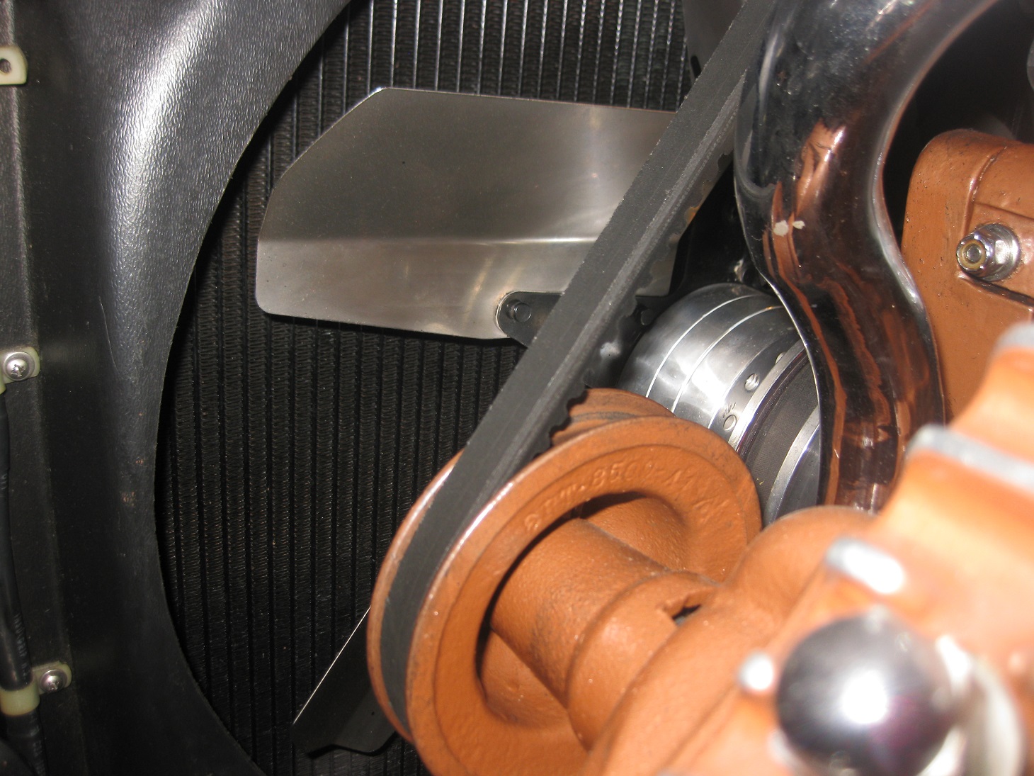

    I used wide belt 8RT water pumps, a wide belt alternator pulley, a wide belt 1949-50 Mercury (or 8RT wide belt dual sheave wide belt crank pulley) all driven by one wide belt. At first, I used the 8RT wide belt fan hub pulley but later made my own wide belt fan hub pulley and bracket so as to have better fan/ radiator hose clearance. So, the bottom line is that I have one long wide belt that goes around the crank pulley, the alternator (or generator) pulley and both water pump pulleys like shown in the red engine in this link. Then, there is a second wide belt that goes around the crank pulley and fan hub pulley and drives the fan on my engine. This is not shown on the red engine.
    Ford Flathead: The First Performance V-8 — TorqTalk
    At the time (1971), I did not consider switching narrow belt water pump pulleys onto the 8RT pumps because already had the rest of the needed 8RT wide belt components that I knew would work for me and give me the radiator fan clearance I needed.
    The last photos shows home made aluminum fan pulley with belt that goes to crank pulley.
    Hope this helps.

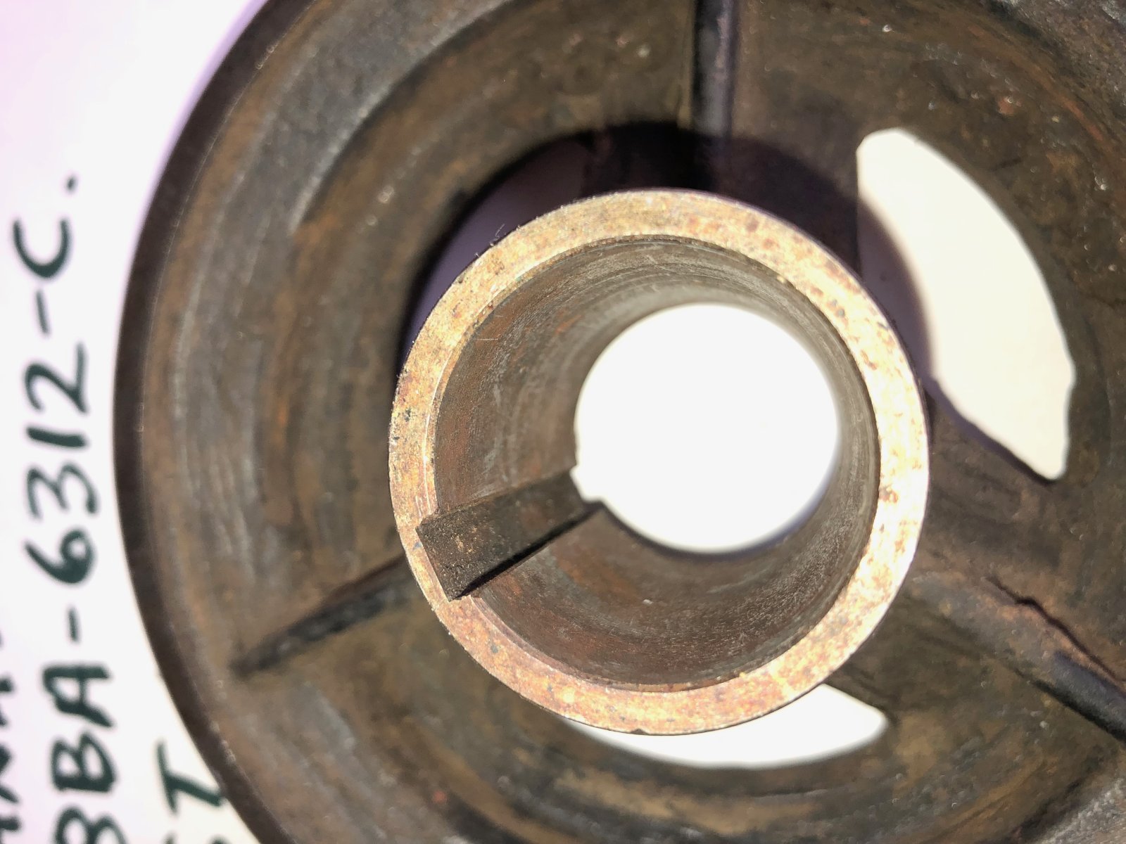

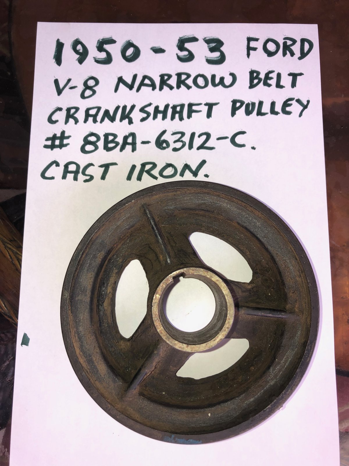

    3/19/24
    Here's photos of the 8BA crankshaft narrow belt pulley I still have. It was on the engine on the engine stand (last photo) that used the narrow belt set up.
