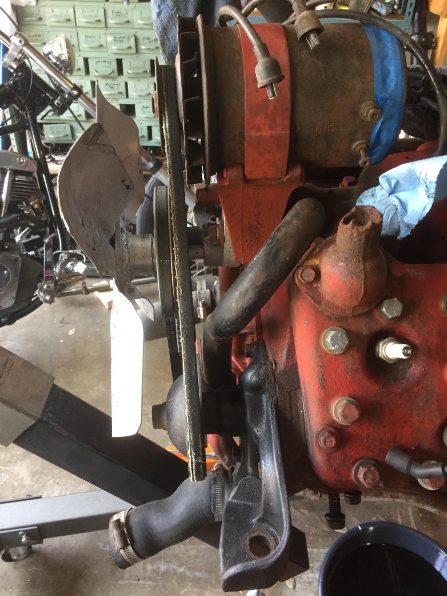

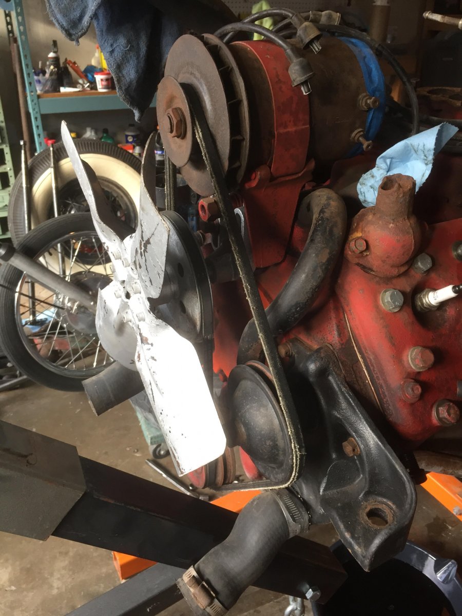

    So I am trying to swap a '49 8BA into my coupe that is currently equipped with a 59AB. I thought the 8BA water pump pedestal mounts would be the same but after taking some measurements I realized the 8BA is 1.5" wider. Before I go buy a bunch of parts that wont work, can someone please point me in the right direction?
    I saw the Speedway pumps are wide belt, where mine is narrow. So if I put the Speedway pumps on then I would have to change the crank pulley. It looks like the wide belt pulley (link below) has the wide/narrow belt locations different than my motor is set up. Would I have to change by fan pulley as well? I dont even know if this motor is a runner! I'm trying to get out of this as cheap as possible if anyone has advice.

    Yes. You will have to change out the crank pulley. You can find the wide belt crank and fan pulleys all over the place. The trucks had wide belts on them. These truck pullies are what we like for the AV8 builds. You can still use the narrow belts if you want to make your self some motor mounts for them but this would be a waste of time and effort.
    The wide belt pulleys are longer in the nose of the water pump pulley. This is why you need to change out the crank pulley to match.
    Also, you will no doubt go from a six volt system to a 12 volt and will need to swap out the generator pulley for a wide belt. And if you do, you will need to go to an alternator instead of a generator for best results.

    FWIW. From the picture looks like the generator on it now has a wide belt pulley and possibly misaligned, maybe why the front edge of the belt is frayed?

    With the speedway pumps, your motor mount issue will be solved. It looks like your pumps would lower the engine in the frame quite a bit too, definitely need to change those.

    Boy, from the looks of the erosion on the water outlets, that engine may be in sad shape. I've never seen them that bad. Hopefully, you'll get lucky!

    The pumps you have are narrow-belt '50-'51 Mercury . You can use them by finding original Mercury, or fabing U-shaped spacers about 1 5/8" high that will relocate the mount holes to the 59A/8BA truck spacing. This will save having to change the pumps and crank pulley. But, as RidgeRunner pointed out, the generator pulley is for the 5/8" wide belt and should be changed for a 3/8" narrow belt, and then correcting the belt alignment.
