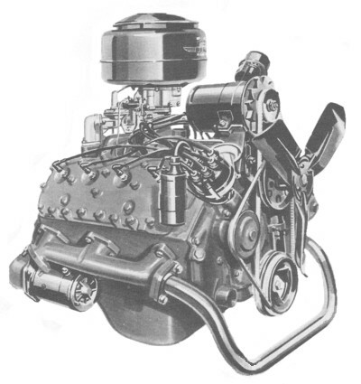

  4. AVater
    Joined: Dec 9, 2008
    Posts: 3,496
    AVater
    H'mm--found this picture as well where it looks like one belt drives the generator and the other belt drives the water pumps and fan. the other picture was the 59AB style

  9. AVater
    Joined: Dec 9, 2008
    Posts: 3,496
    AVater
    Here's what I did--ran them all with one belt. My generator hangs off to the distributor side but similar mount. I am running the wider belt, not sure but yours looks like maybe the narrow belt. Sorry about the picture but couldn't get a full frontal.

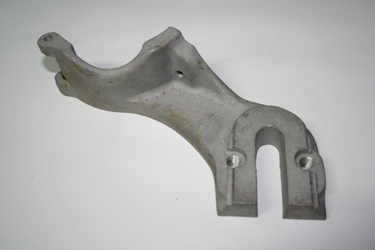

  13. If you put the Generator bracket on the correct way the pulleys will line up. YOU HAVE THE BRACKET ON BACKWARDS! I just hope you have not destroyed the intake manifold by grinding it!
    The flat side faces that Radiator/Grill Shell GenBracket2.JPG

    If I flip mine around like you say its supposed to be nothing lines up at all. The way that I have it lines up the best. But I still don't understand why the belt is rubbing.

    You guys rule! I went back into the shop and tired it again and got it all to work! I guess the guy's who had the engine before had it on backwards as well. Now I just need to figure out what length belts to buy and I'm set.

    The belts rub because they are on wrong. this is how my 8 BA stone stock looked the day we pulled out of the Jeep wagon it powered for about 30 years.
    The generator belt was loose for one reason or another but you can see that the front belt drives the water pumps and fan and the back belt drives the generator. I'd think on your rig an Idler pulley would give you a route around the fan mount shaft and make life simple.
  19. He already figured it out, but since we're still talking about it, the pumps he has have two different pulleys, the driver side pump pulley lines up with rear sheave on the crank pulley. The p***enger side pulley lines up with the front crank sheave. So running both pumps with one belt will not work unless the pulleys were identical. The front belt is crank+p***. pump+fan, the rear belt is crank+driver pump+generator, just like he has it, and shown as a drawing in post #4. My only concern now is does the intake still have enough mounting groove to keep the bracket straight up and down and in place during operation? Sounds like he ground it perfectly flat to move the bracket rearward.
