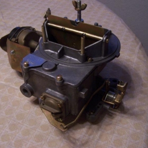

    Working on ***embling my 8BA motor. I have the rebuilt (by a professional) carbs on the manifold (carbs also marked 8BA) and noticed there is a threaded port on each that seems to be missing something. I had two junker carbs of the same type and they were missing it too. Looking at carbs for sale on line some seem to have a br*** plug threaded in there and others do not.
    Not sure what it is called, blown up parts diagrams I have found don't seem to call attention to anything that fits in there?
    So, what should be in there if anything?
    Can I run without it?
    If no, where can I get two of them and what's it called ?

    There is nothing missing. Any carb with a br*** fitting in there is either a mistake or an attempt at a repair. That orifice requires a special compression fitting called (appropriately) a "Ford Nut". They are available from several sources. I believe "Third Generation Auto Parts" in Tennessee is one.
    That port is to control the advance on a Ford "Load-a-Matic" distributor. This is a type of advance system that is unique to Ford during the period and requires a special carburetor and distributor that work together. I see you mentioned "carbs" (plural) in your post. Be advised that the "Load-a-Matic" system will not work properly on anything but a "bone stock" engine. If you haven't already done so, you should familiarize yourself with the unique properties of the 8BA system.

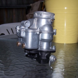

    Here is the 8BA carb I ran on my 8BA when using a Mallory mechanical advance distributor.
    Notice the use of the br*** plug to block off the vacuum advance port .

    Gergstuff; That plug was already installed on the carb when I bought the carb. They are 1/8-27 br*** plugs that you can buy on line or at NAPA. You can make the saw kerf with a hacksaw blade or thin cut off wheel, if desired. 1/8-27 br*** plugs - Search (bing.com)
    The plugs are almost 1/4 inch thick and the bottom is flat with a slight taper for starting the plug in the threaded carb hole. You could even make a plug out of another 1/8-27 fitting if you cut off and solder the hole closed ( See last photo.).
    Be very careful when you screw in the plug as the threads strip easily. DO NOT OVER TIGHTEN. It should start to fit easily by hand. Here are some photos I just took showing 1/8-27 pipe thread tap and die and plugs. Use oil on the threads.
    You could also use a 1/8-27 Nylon plug. That way there is no chance of stripping the carb threads. Look here: 1/8-27 nylon plug - Search (bing.com)
