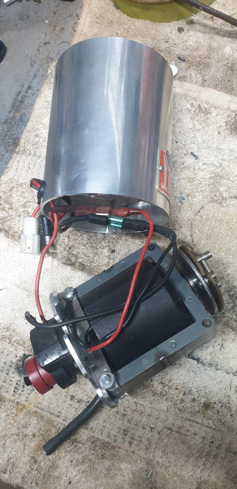

    It is relatively easy to convert your Joe Hunt Mag look distributor to an external coil. I am no wordsmith but will try to explain it as best as I can.
    Basically the Joe Hunt mag look distributor functions the same as any other ready to run electronic distributor. The point of difference is that rather than use an external coil it has an internal coil, which keeps the main high tension coil lead inside of the distributor and in turn allows you to use the ***y magneto cap (and yes you can use the Joe Hunt or a Vertex Cap).
    Unfortunately it appears that the internal coil is also the weak point in the design. If you read through the negative posts on these distributors the most common complaint is that the coil overheats and fails. Which is exactly what happened with mine – and yes I did follow all of the installation instructions down to the letter – and no I did not attempt to send it back to them for repair as I am in Australia.
    Fortunately it is pretty easy to convert these.
    There are at least 2 ways to the conversion.
    The first way in my view is pretty agricultural, quick and dirty but it does work. Basically take the cap off and remove the spring that contacts the internal coil. Cut coil wire short so it doesn’t go into the cap. Drill a hole into the cap where the coil wire goes and put a screw into the cap with a nut on the top of the cap to hold the screw tight. You can then attach your high tension coil lead to the top of the cap. You also need to disconnect the wires that go from the ignition module to the internal coil and reconnect them to your new external coil that you can mount anywhere you please. The ting I don’t like about this method is it means that you have the new coil lead coming out of the top of your distributor cap.
    The second way is a bit more elegant. When you take the cap off you will see 4 hex socket cap screws (2 hold the ignition module in place and 2 hold the aluminium internal plate in place). BEFORE YOU DO ANYTHING ELSE SCRIBE MARKS INTO THE ALUMINIUM TOP PLATE TO MARK THE EXACT POSITION WHERE THE SCREWS ATTACH - SEE ARROWS IN PICTURE BELOW). You will see that the plate has slots in it which allows for the plate to be rotated to change the advance curve. You do not want to change it by altering the position of the plate. When you put it back you want it to go back into the same position. That way the distributor advance will remain as it was set at the factory.
    Carefully remove, the rotor, electronic module (2 SCREWS), the trigger for the module and then the top plate. The internal coil is bolted to the top plate and when you lift the plate out the coil will come out with it. Unlike most other distributors the main shaft that runs through the Joe Hunt unit is in 2 parts. The bottom part of the shaft (that has the drive gear attached) remains attached to the bottom housing. The top half of the shaft has the centrifugal advance weights on it, p***es through the coil, the top plate and has the pressed on bushing to which the magnet ring attaches. Note the magnet ring presses onto a bushing, the bushing is held onto the main shaft by a cap screw. Whilst the bushing has a flat side (so the magnet ring only goes on one way) the bushing itself is a tapered fit – there is no keyway on the internal shaft for the bushing it is a tapered fit so if not maked your rotor position will be out of alignment. Once you have gently removed the magnet ring you can undo the cap screw and remove the bushing. BUT BEFORE REMOVING THE BUSHING MARK / CLOCK THE FLAT SIDE OF THE BUSHING IN RELATION TO THE ADVANCE WEIGHTS). You can then remove the main shaft, cut the wires to the coil. Before you throw the internal coil over your shoulder you will need to make a bush the length of the coil to fill the space where the coil went and to stop the shaft moving up and down.
    You then drill a hole in the outer casing of the distributor (in an unobtrusive place) so you can run your new external coil main lead through the body of the distributor and into the cap. Basically your new coil wire goes inside the cap the same as where the Joe Hunt one went. You will need to make up some fixing points to keep the wire away from the rotating parts ant to keep it in place.
    Then it is a simple matter of re***embling in the reverse of how you dis***embled it. Provided you marked position of the bushing in relation to the advance weights and the top plate in relation to the cap screws then you will not have altered the set advance of the distributor.
    So if disaster strikes and you did not mark the position of the tapered bushing to the centrifugal weights all is not lost. You can set up the whole unit on your workbench with a coil spark plug and battery. With the main bushing loose on the shaft (with the magnetic trigger attached you rotate the central shaft by hand and note where unit makes the spark plug fire, tighten the central cap screw down once you have clocked the rotor so that the pointer aligns with the position where the sparks fly.
    The process is not easy to describe but once you start pulling the distributor down you will be able to work through it.

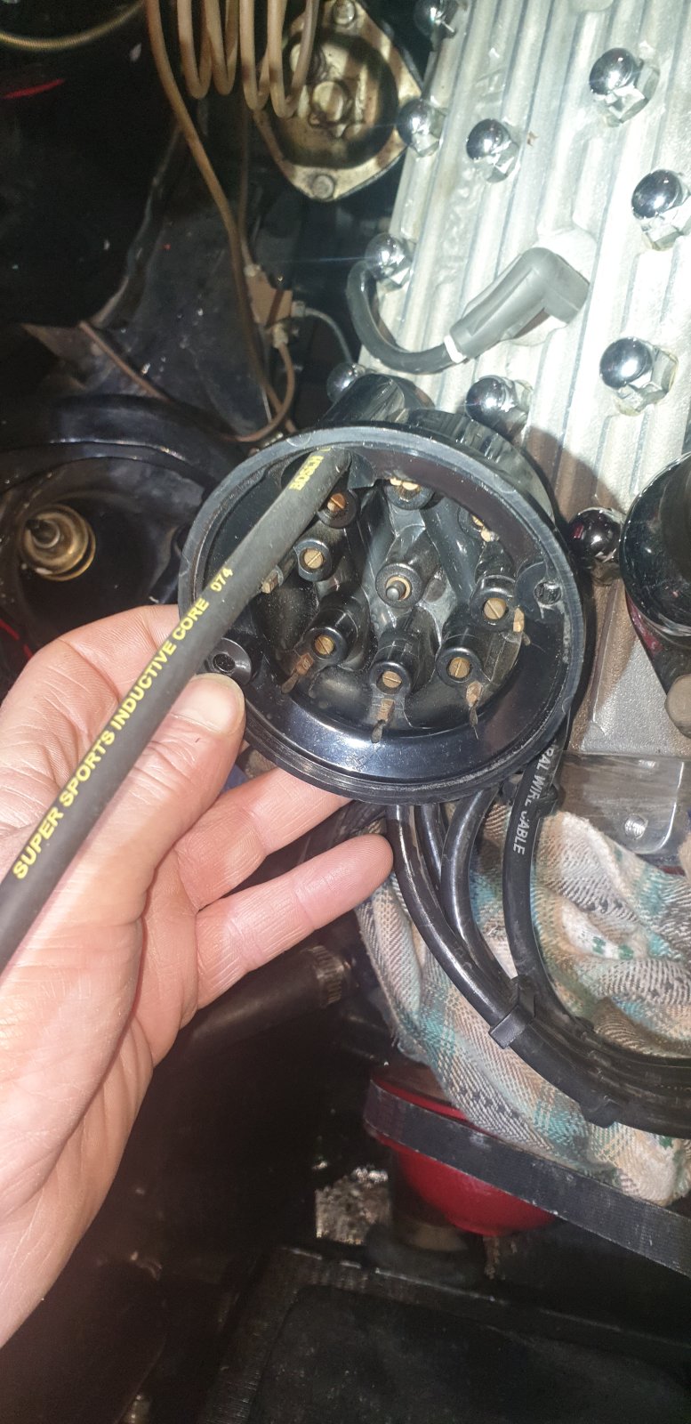

    I have had my Mainline on the road since December 2021 and hadn't experienced any issues with the Joe Hunt unit, but a few weeks ago, and only one week before I had a Unique Cars magazine scribe coming to prepare an article on the ute, the flame went out on me whilst driving locally.
    Changed down to 2nd gear and nothing.....pulled over and checked the spark and there was big fat zip.
    A couple of days later I found some threads on here about the Joe Hunt unit and was ready to throw in the towel until I saw your post and saw a glimpse of hope.
    I headed to Burson Auto and bought a GT40R and a carbon lead.

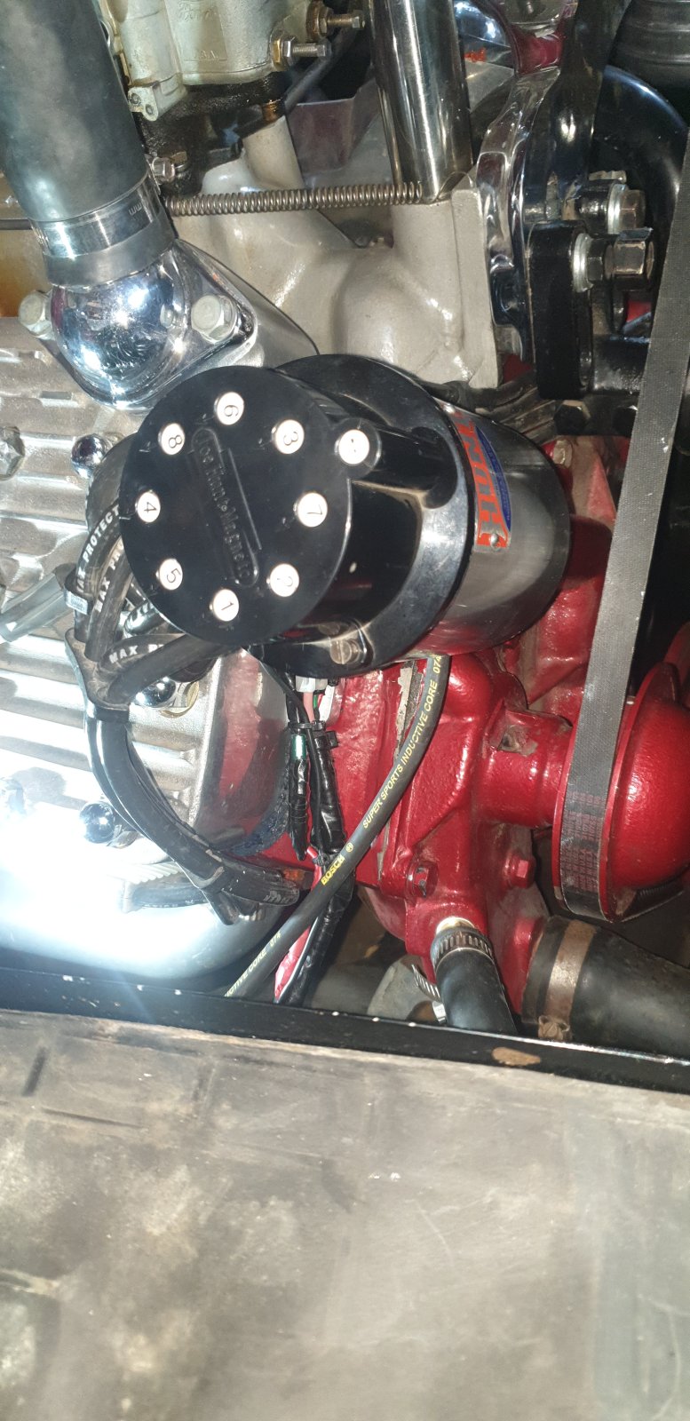

    By Thursday I had pulled the mag look unit out and ***essed the situation, made some changes to the wiring, disconnected the internal coil but left the wiring in there just tied up.
    After carefully drilling a perfect size hole in the side of the unit for the external coil lead to p*** through, I fitted the coil under the battery tray and ended up with a very neat install :)
    The engine fired up right away and sounded better than it had. But, that probably had a lot to do with finding numerous cracks on the inside of the mag cap. Those things must be made of absolute garbage plastic.
    I didn't have a spare one of those to throw on, so I have sealed all the cracks with black high temp silicone for now.
    I will persist with the Joe Hunt unit because I love the look of it and it owes me a bit of money........but if it screws up again, I might have to go for one of those Stromberg units and go back to vacuum advance.

    No drama man. Great that it worked out for you. In regards to your cap... The Joe Hunt is a copy of the vertex cap. I am led to believe that the vertex is much better quality and is certainly going to be easier to obtain in Australia.
    Also make sure you do your research on here before you go for the Stromberg apparently the earliest ones were good but maybe not so much now that they are manufactured elsewhere.

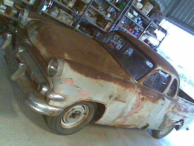

    If my dad had his way, the engine would have been completely stock standard original, and the ute would have stayed pale blue in colour with a red vinyl interior :eek:.
    This is what it looked like when we found it, awesome patina but horrendous rust issues......
    And what it looks like now :)

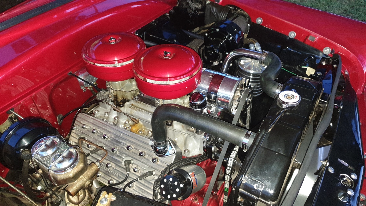

    I had no idea someone was going to the trouble of making mini versions of the air cleaners, that's awesome.
    But mine are old oil baths and had to have the tiny rust holes in the base brazed up, as they had sat on old sidevalve V8's out in the weather for God knows how long with the water that got inside getting under the oil.
    Think British Ford......

    In regards to the Vertex cap in OZ I think your best bet is to talk to some of the speedway suppliers (not Speedway Motors) but actual speedway / drag racing performance parts suppliers. If you get stuck there are
    unbranded caps on ebay Aust NSW seller AT Racing World https://www.ebay.com.au/sch/i.html?...ngworld&_oac=1&_trksid=p4429486.m3561.l161211
    Item https://www.ebay.com.au/itm/1321407...X2VGEZ&hash=item1ec433be2a:g:DTAAAOSw~G9mnXse
    I purchased my Vertex cap at a local high performance swap meet from a random seller.

    Sorry to leave you hanging, those oil bath air cleaners were taken from Thames Trader cab-over truck engines. Nice and small so they fit under the engine cover!
    And the air cleaner elements I fitted are for a CF Bedford van, it took hours scouring an air cleaner parts book to find the right dimensions.......
