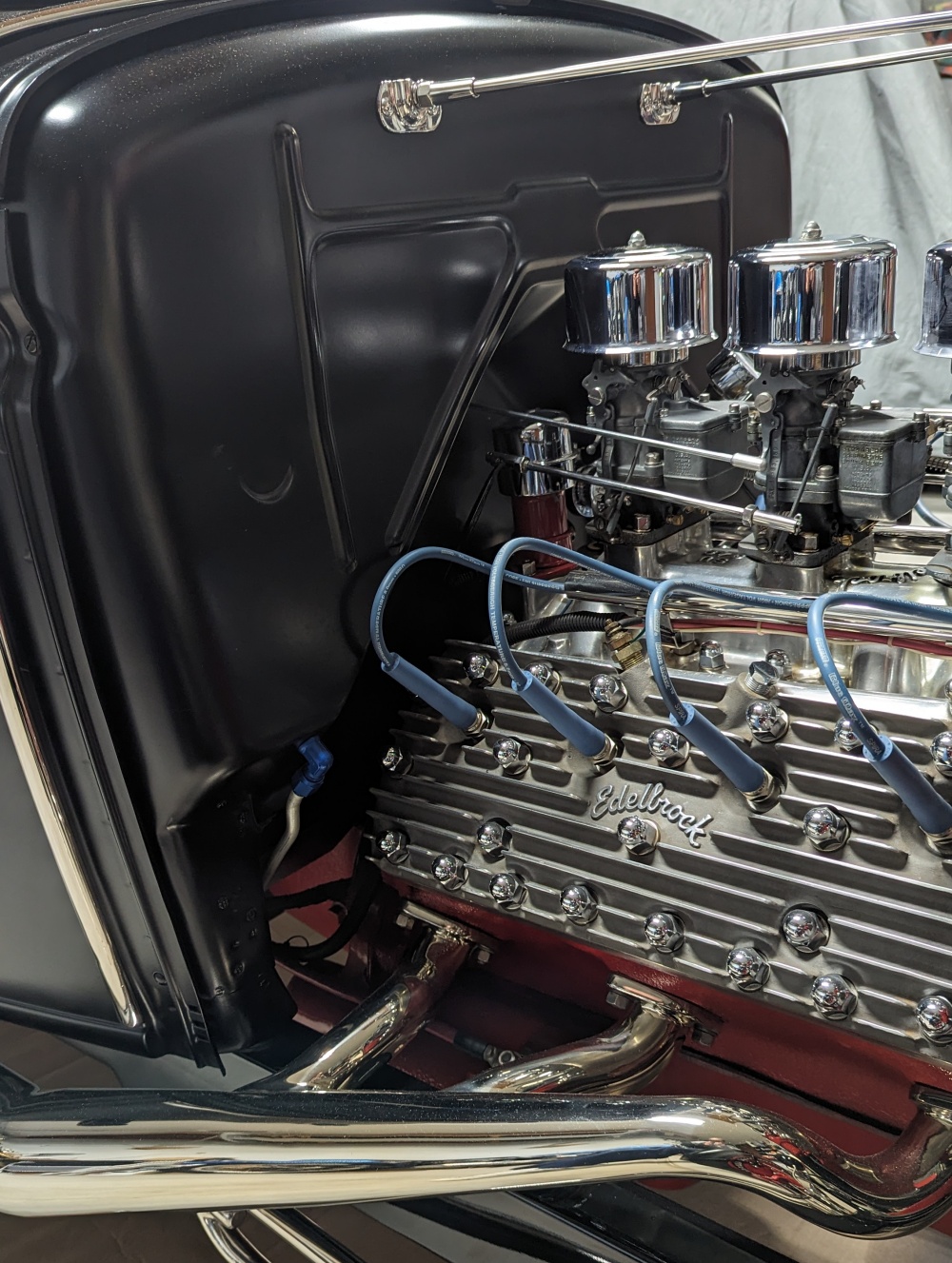

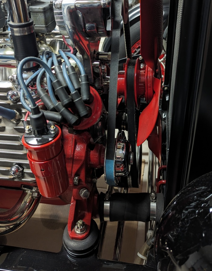

  5. flthd31
    Joined: Aug 5, 2007
    Posts: 601
    flthd31
    It will fit.
    Just needs some minor firewall work. I just recessed this 8-BA only where it interfered with the firewall. Most people that aren’t familiar with Model A’s think its stock. It cools very well also. And there is still plenty of leg room inside. There’s nothing sacred about a model a firewall…just cut it.
    I've done a few like this.
    Here are a few pics of my ’31 coupe. Stock frame wheel base. That’s a stock 8-BA fan set-up. All belts, pulleys and fan blade are stock. The hood fit fine before I built the over the rail headers. Now its off for good.

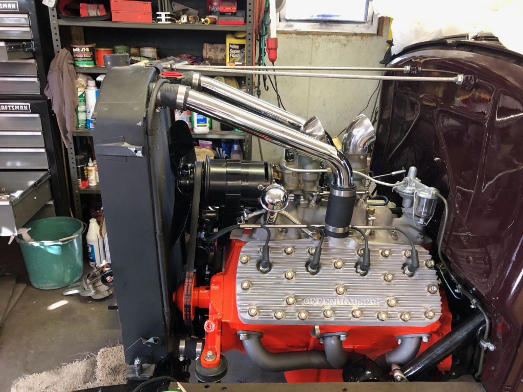

  6. Model A Gomez
    Joined: Aug 26, 2006
    Posts: 1,843
    Model A Gomez
    I did away with the front pulley on the crank and mounted my fan on the generator with a 37 Ford fan pulley. Four blade and allowed me to just put a small notch at the bottom of the firewall. I'm running a closed drive line on a 50's style V8 A and this is the second one I've done this way.
