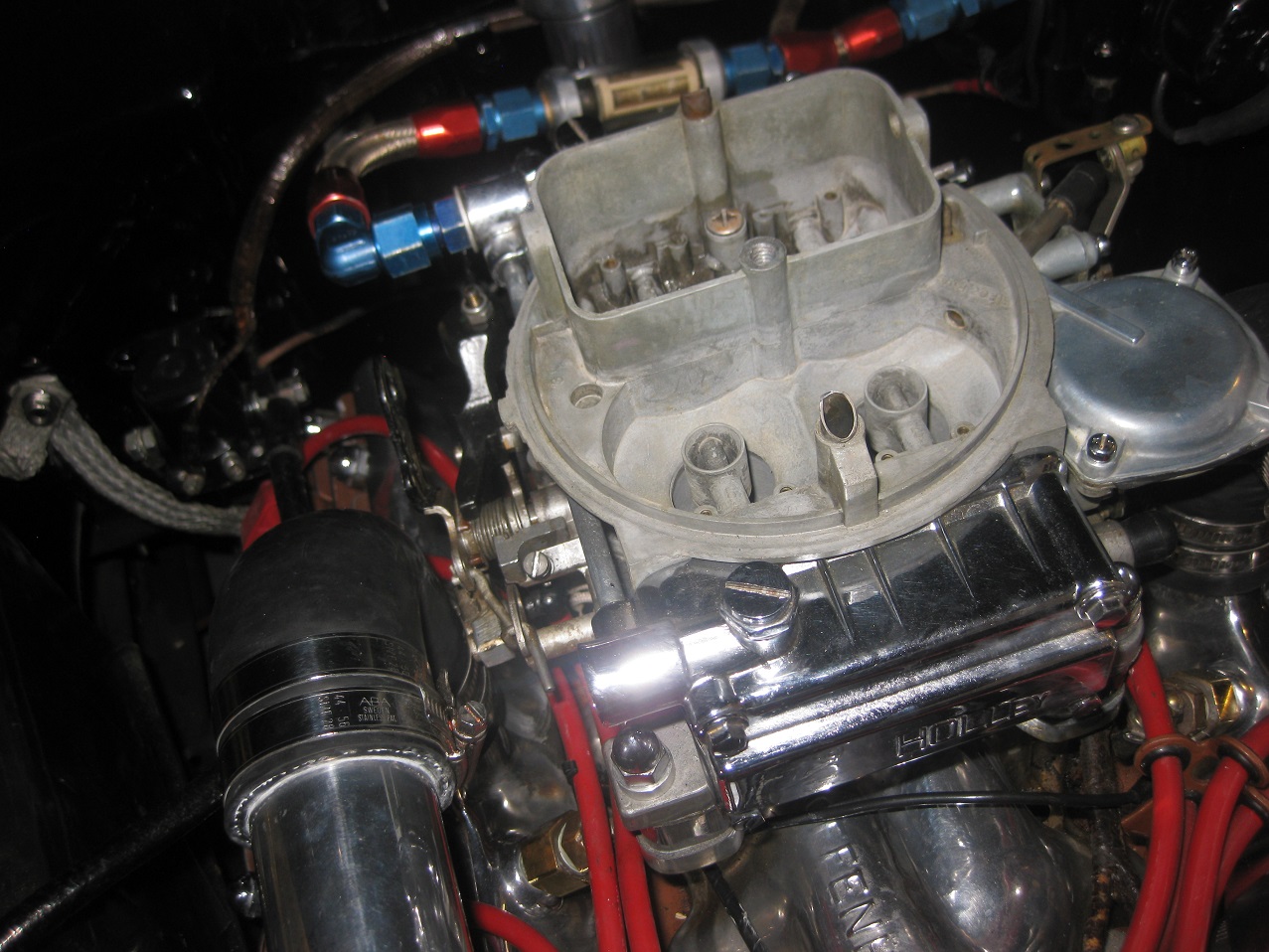

    Here's the 390 Holley number 8007 , model 4160, I have on my 8BA.
    holley 390 #8007 - Search (bing.com)
    Don't confuse a Model 4150 with a Model 4160.
    Also, Holley 390 reproductions are being made in China. Be careful.
    To run a 390 on a flathead I had to install the carb. backwards so the linkage was on the p***. side.
