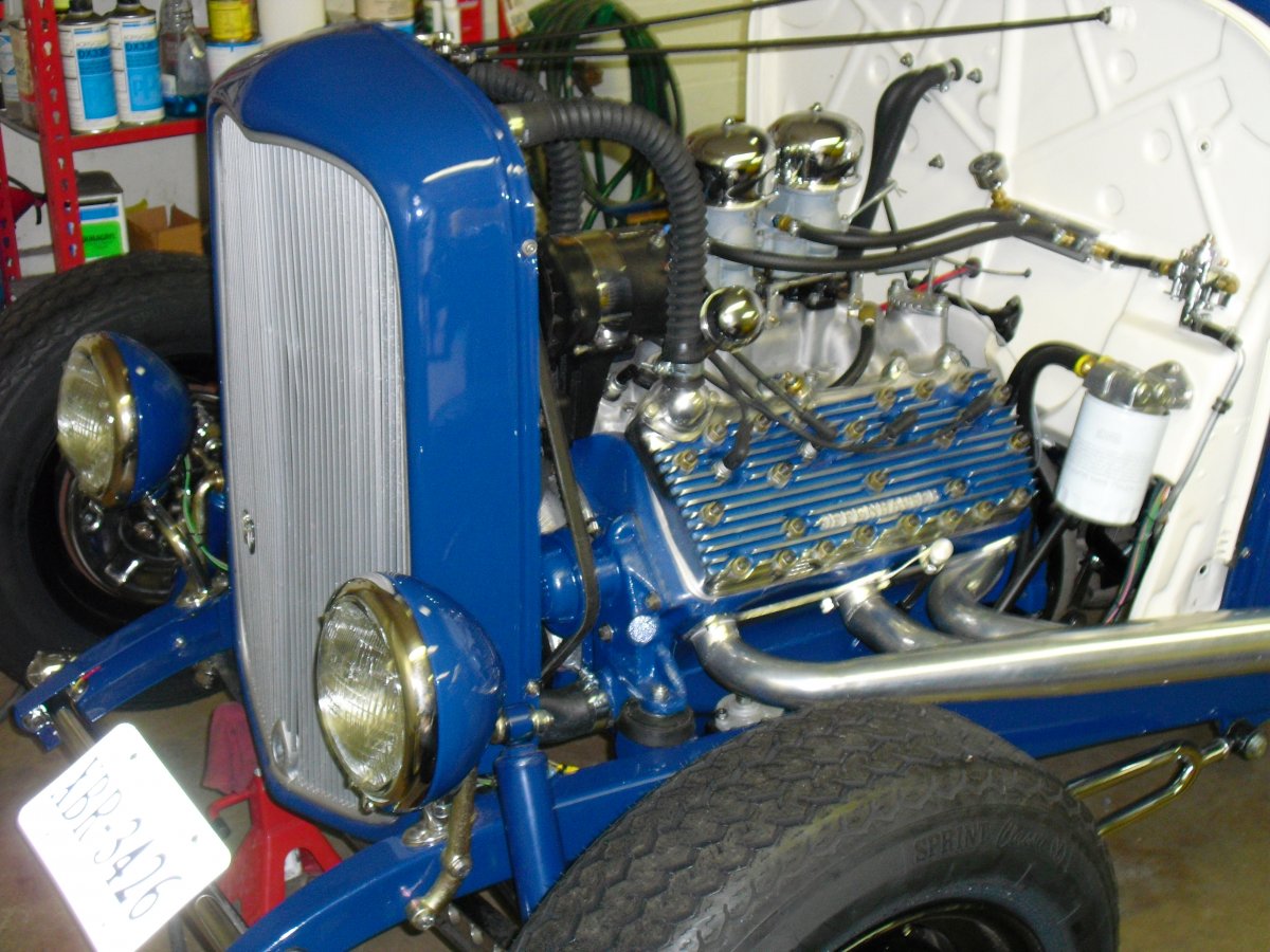

    I am using a stock-type fan on mine. It is the old 8RT type that you need to oil. Works well for me and has never overheated. It runs pretty damn close to the radiator but it clears the bottom CIMG1046.JPG hoses just fine.

    My fan seems to touch near the bottom of the radiator, maybe a wider fan when viewed side on, compared to the post above.

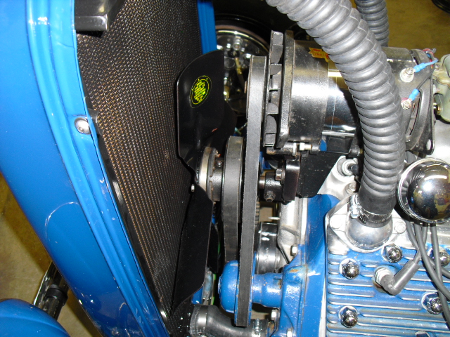

    Yeah, I'm not sure I've seen the pulley you're speaking of. Is the generator & DS water pump narrow belt? Looks narrower than the fan belt in your photo.
    3blap.
  12. sidevalve8ba
    Joined: Jun 16, 2009
    Posts: 2,578
    sidevalve8ba
    No, they are all wide pulleys and that is a wide belt. That angle in the photo does seem to make it look like the one belt is narrower but they are both the same width.

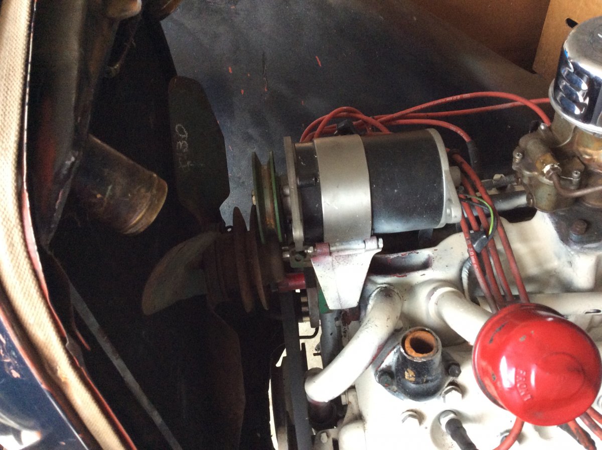

    Is this what you had in mind?

    Yes, that's what I had in mind. Just wanted to see if anyone had put an 8BA in an aftermarket (non original) 32 chassis using the double crank pulley and fan carrier (as in the pic above) without cutting the firewall or other major surgery.

    As you can probably see from this photo I did not have to alter the firewall. I am using one of Gary's chassis from Cornhusker Rod. I am using a stock 8BA fan which does not offer a lot of clearance with the radiator but does a very good job of cooling.
