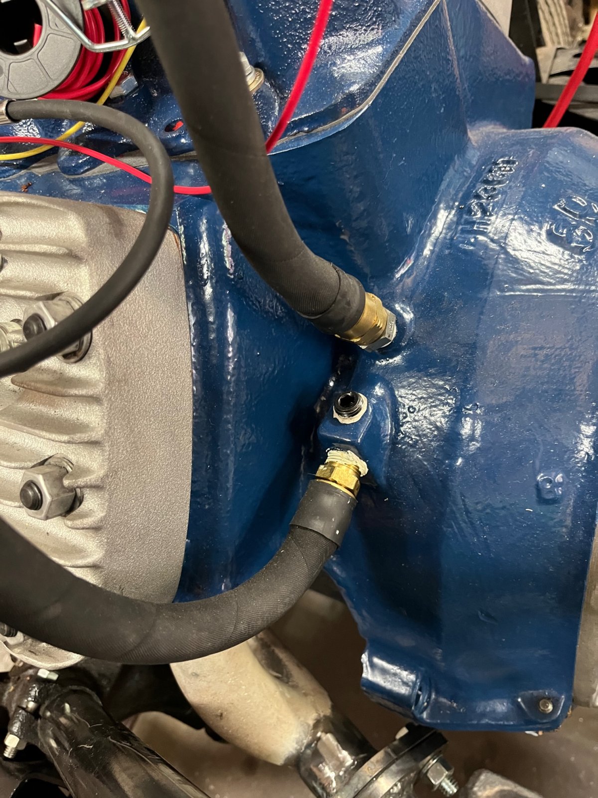

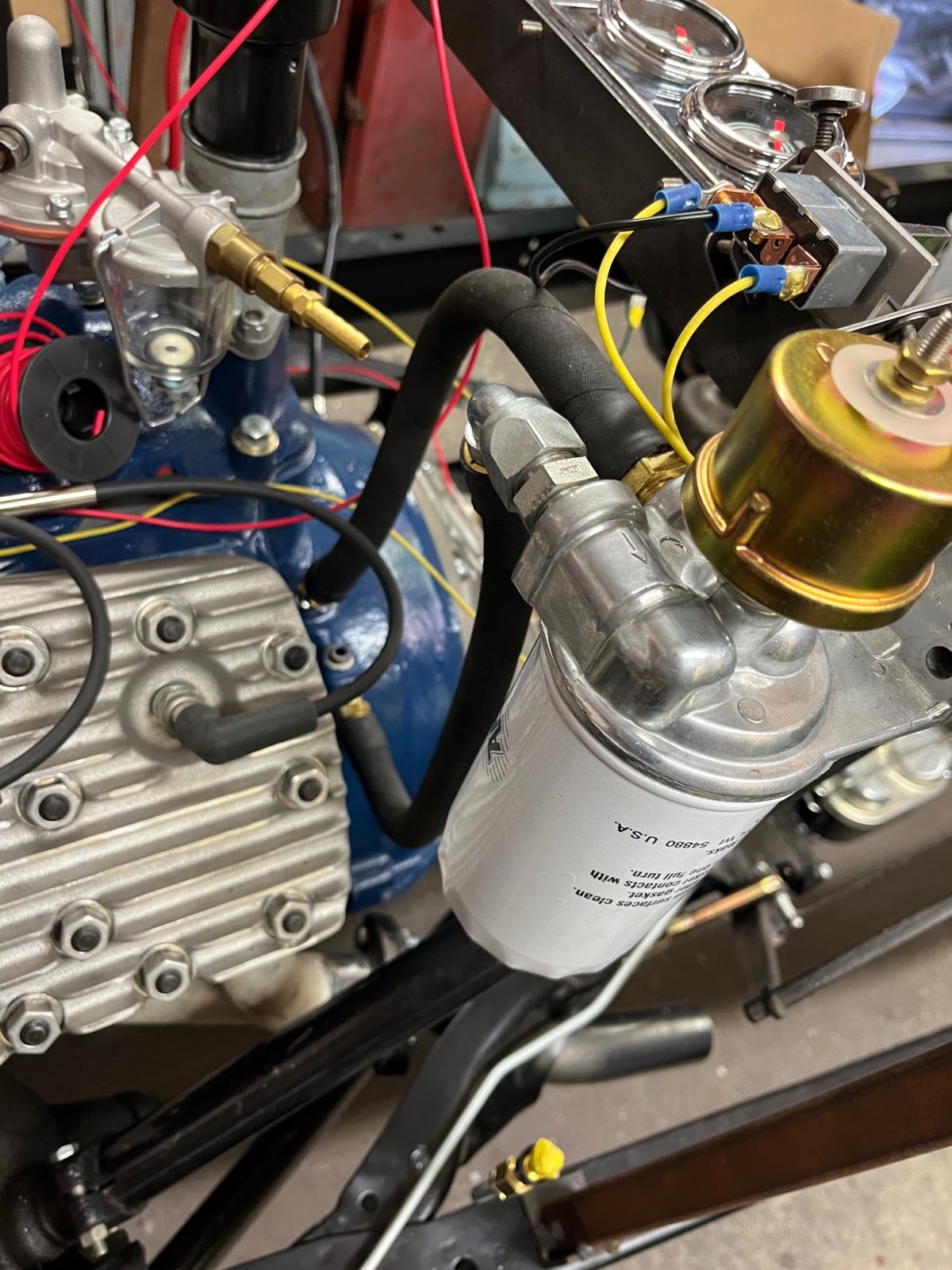

    I would recommend using the 95% system as it appears the block has been machined for. Originally the top hole on the casting boss was for the oil pressure sending unit ans the side hole was either plugged or had a hose going to the byp*** style oil filter (original).
    IMG_2605.jpg My engine with filter; you can see the lines connected to the block.
    IMG_2606.jpg Connections to the block. The lower is directly out of the pump to the inlet of the filter and the upper is the return from the filter to the extra hole in the block to feed the main oil galley. There is a pipe plug in the original p***age between the black plug (in picture) and the upper fitting to force oil to p*** through the filter.

    Seems pretty straightforward, do you happen to know the manufacturer and/or part number of your spin on oil filter adapter? I think I was confusing the three different types of systems (95%/100%/ by p***) I was envisioning having to rip apart the engine and make all the modifications to the oil pump and so on to do the 100% system. Seems as if I am set up for the 95% set up here and I am hoping I can fabricate something to use a set up like you have to the mounting spot on the drivers side cylinder head. What size are your hoses?

    I believe I bought the remote filter mount from Summit and I used "push loc " hose. I also bought some of the -8 ( 1/2 ") fittings there . I also got some from Aeroquip ( now Eaton Aeroquip). The large size hose is to minimize the pressure loss from the pump to the bearings . I didn't use a high volume pump as I don't think it's necessary. I do have a PCV system.
