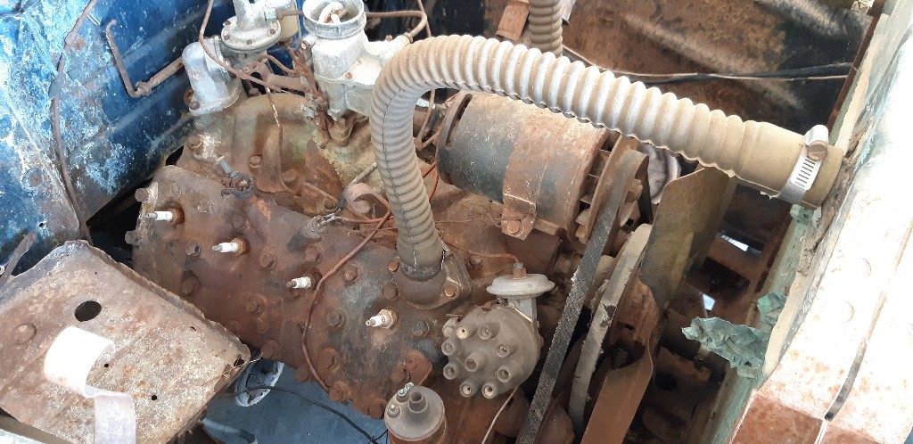

    Hey Gang,
    I redid a 1952 Ford F1 for a guy, and he didn’t want the flathead so I placed it on a stand in the corner of the shop after I pulled it. The intake has 8BA on it, but the heads don’t have anything. I pulled the intake and heads off, and since I knew I was planning on some sort of speed parts for it, sold off the intake and carb but kept the heads just because.
    So, a few questions for you guys; How do I tell what year flathead it is? Where do they typically crack and is it obvious to see? Any good shops in the DFW area that could check it out?
    Also, it’s locked up right now so any advice on unsticking it?
    thanks guys!

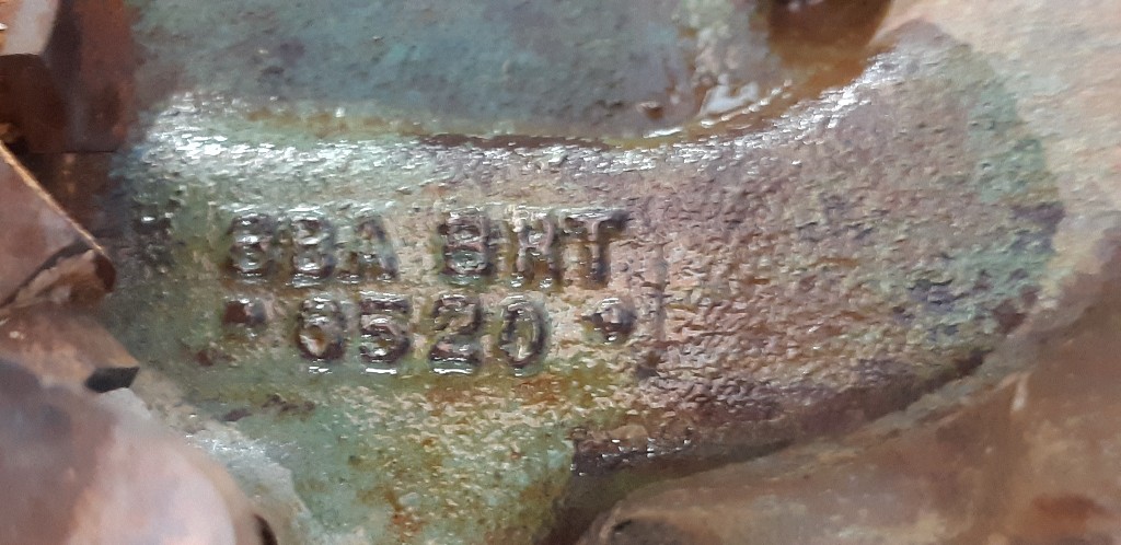

    Some late flatheads have a date code stamped on the rear of the intake surface... I said some. One of mine has a code but it doesn't match anything that's been published. Other than that; you have a late flathead, 49-53 and that's all that matters.

    Found a few pics of the engine, so the intake has both 8BA and 8RT and has the green paint on it. So looks like it’s the original 52 Truck version.
    I’ll start looking for the “factory cracks” later this week.:p

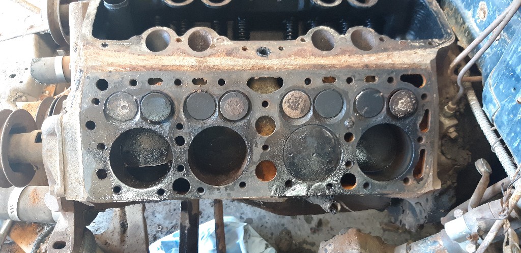

    Tore it down, and two of the water jackets to head bolt holes have those cracks. Valve seats to cylinders don't have any, but I do have the pan rail crack but it doesn't extend into the side wall, it's only on the face of the rail.
    What do you guys think? Fixable with a pilot hole on either end to stop the crack then fill with JB weld, or take to a shop and see about welding it up..... Or junk?
    Cheers
    Dave

    That’s a great thread, thanks for posting it. It looks like it’s debatable whether it’s fixable or not depending on how bad. I’ll drop the block off for a cleaning to see if there’s anything else I’m missing before proceeding.
