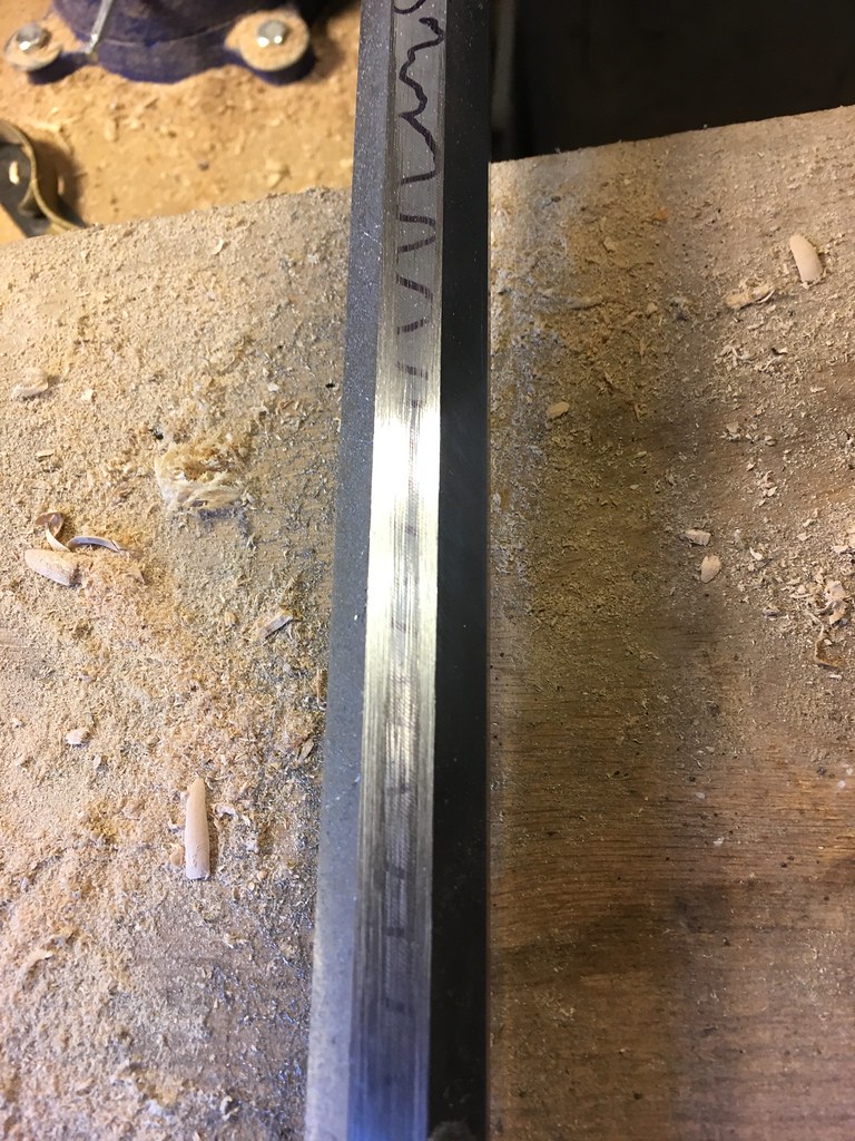

    1. Check the head surface with a straight edge.
    2. Check and true the surface with a good flat file and a sharpie marker.
    [​IMG]Un***led by Travis Brown, on Flickr
    The photos above are of a flintlock rifle barrel but the concept is the same. I did the same thing to my 8RT...(truck version 8BA) and a set of Mercury EAB heads I literally dug out of the dirt. A gave my Edelbrock Heads away and used those Mercuries.
    Check the head on that side and make sure it's true...paying close attention to 3-4.
