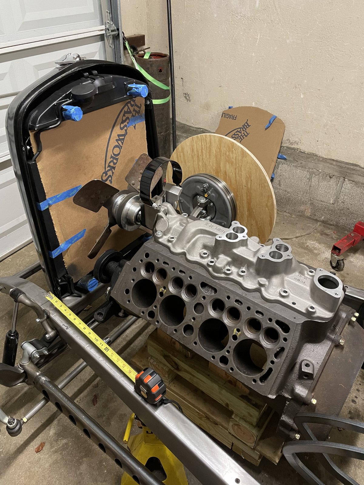

    I am mocking up my 32 roadster project and got to the point where I was positioning the engine with the fan mounted and the radiator in position. Quickly learned that the 8ba is a long engine and for the stock style United Pacific firewall to fit, I’d need to find about 3/4” somewhere or modify the firewall. I looked at the options of electric fan, single pulley system for fan and alternator, mounting fan on a generator, or doing the mods to make my 8ba take the shorter 59 block water pumps in order to gain the space needed to have the firewall fit without mods.
    Lots of thought and a desire to get better at patch panels and welding pushed me to go ahead and modify my firewall (plus I have a lot of the parts for the standard double pulley setup already and did not want to spend more money to go in a slightly different direction). So this is what I had to do to make the firewall fit for an 8ba with a double pulley setup. My fan is about 5/8” away from the radiator.

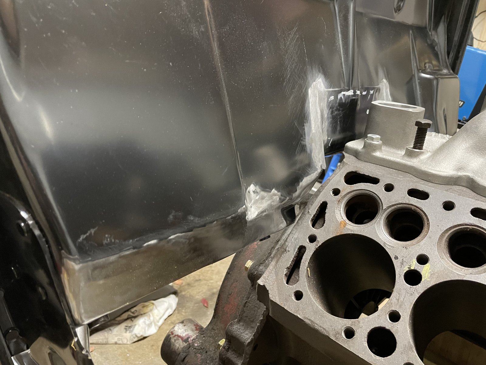

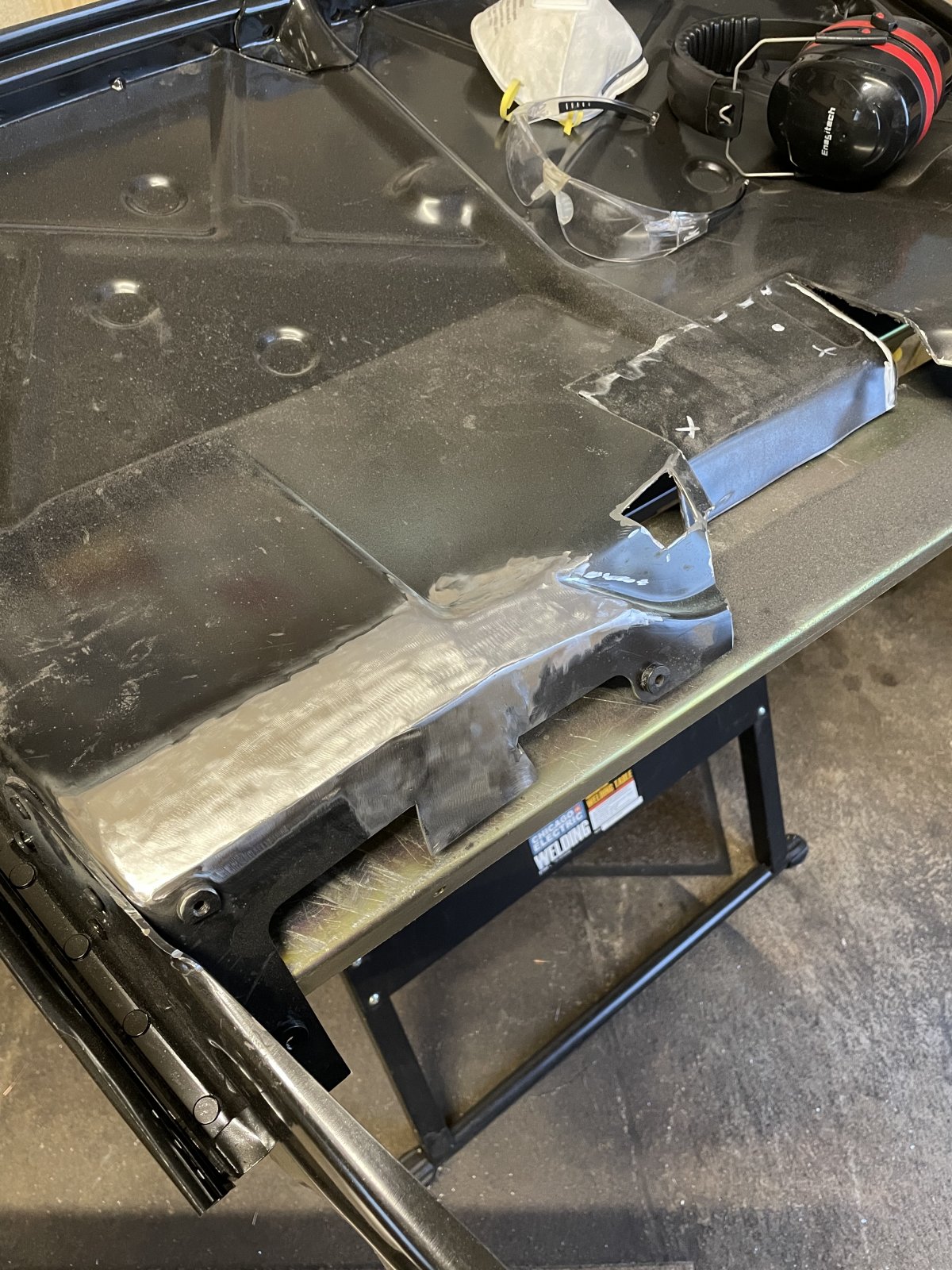

    The bump on the p***enger side footwell area was hitting the head, so I zipped that off and welded on a flat panel.

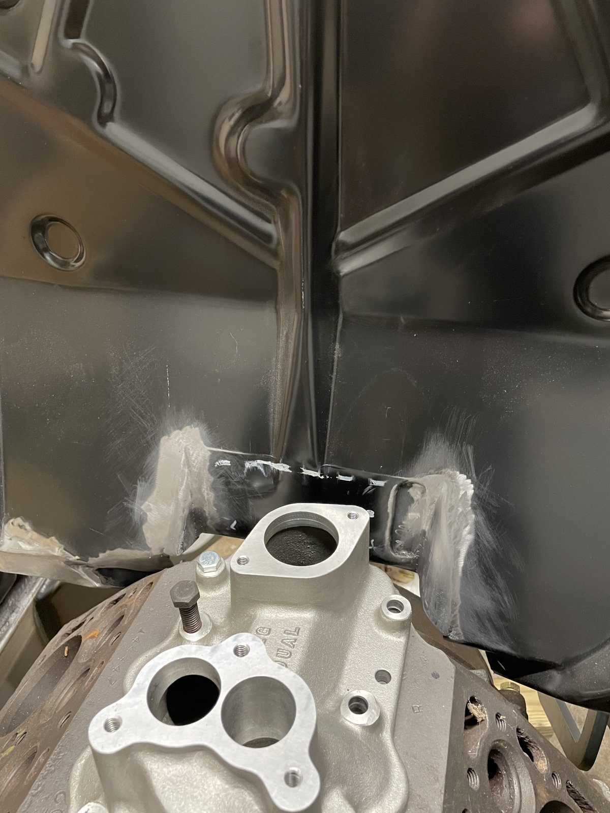

    You can see another square cut out closer to the middle of the firewall - the block was just barely hitting there. So it was also cut and a flat piece was welded in.

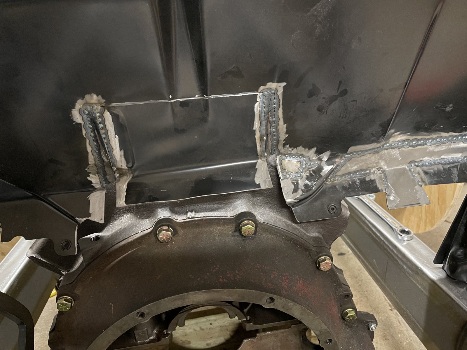

    The intake manifold area was hitting as well as where the 8ba bell housing bolts onto the block. So I cut off the bottom area to clear the bell housing bolts; made some vertical cuts up the firewall a bit wider than the intake manifold; scored the backside of the firewall where I wanted to bend the metal back to clear the block/intake. I made and bent some patches to make a more gentle transition from the stock firewall to the bent-in middle area.
    Welded and ground down, I think it turned out pretty darn good for my first time doing any panel patches and welding (other than practice welding and a shoe rack I made 6 months ago).
    Should be a perfect fit now.
    Here’s a pic of the backside to show my lack of welding and panel-fit experience.

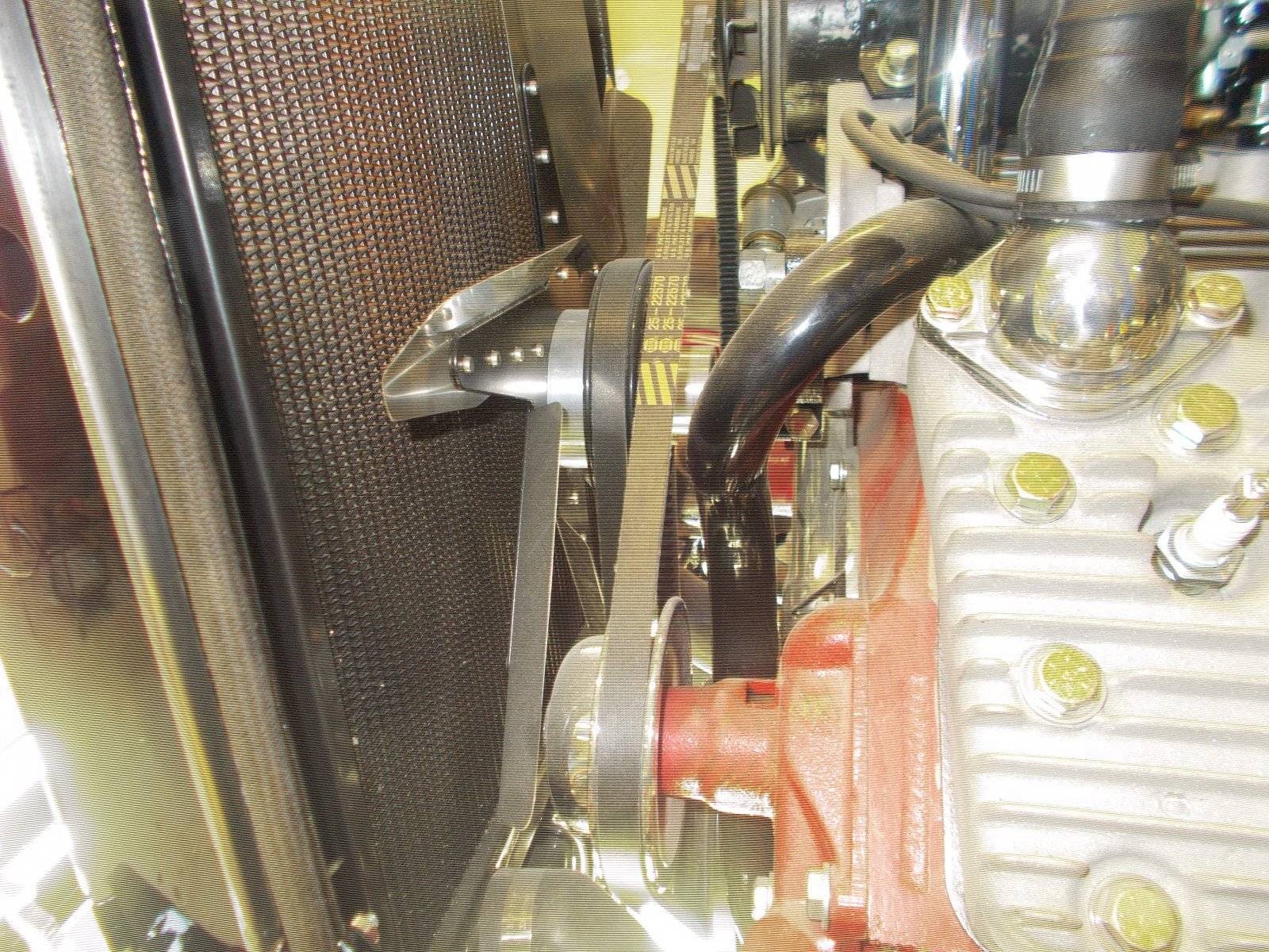

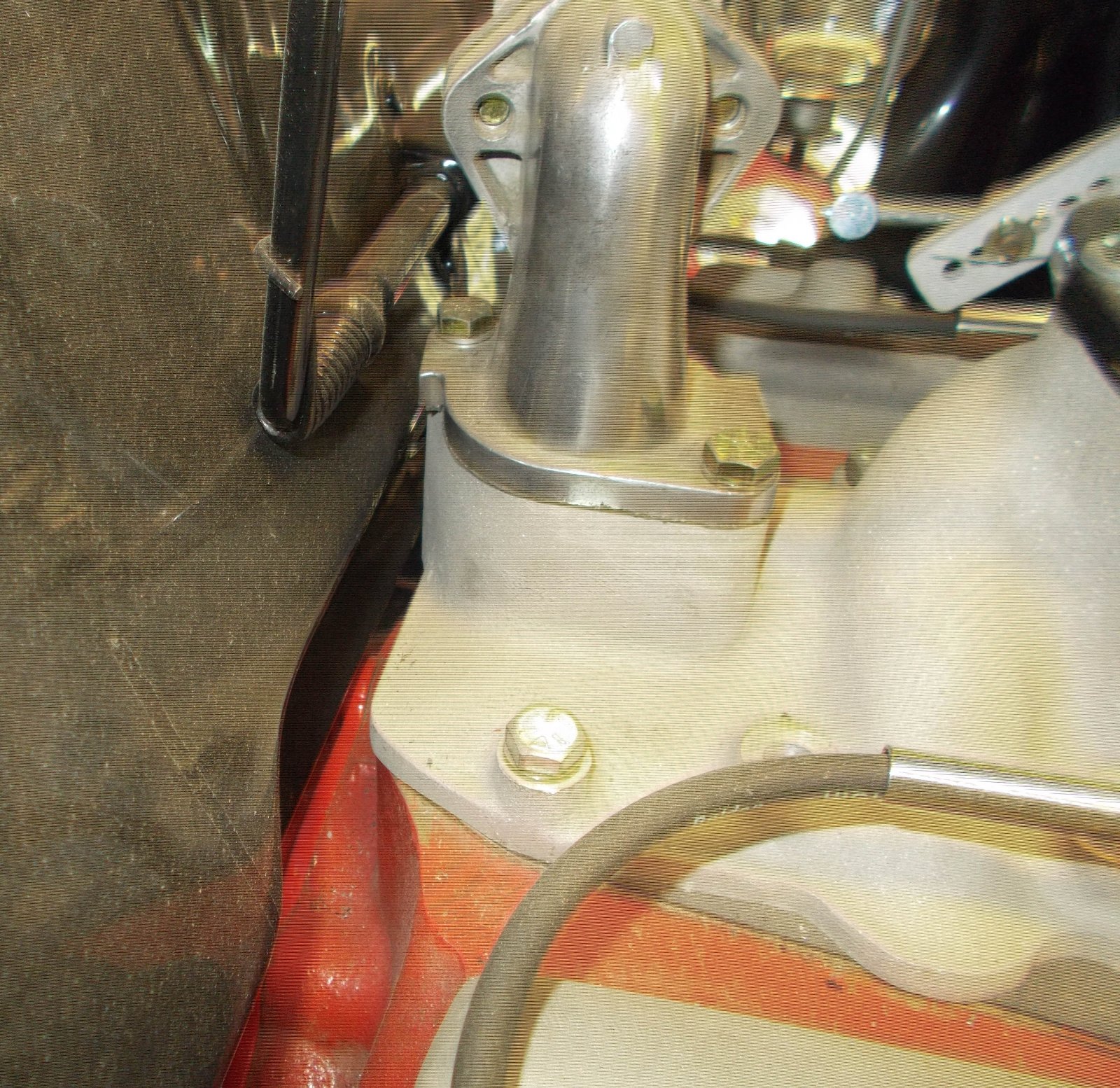

    Crotty, feel the need to add this. I have a stock '32 body on the original frame. The firewall is original to the body.
    My deuce has an 8BA hooked to a '39 box using the original '32 transmission mount.
    Can the United Pacific firewall be that different from stock?
    Pictures added to show my fit.
    I did fabricate a fan hub to tuck the fan in as close as I could. Can never 8ba5.jpg 8ba4.jpg 8ba3.jpg 8ba2.jpg bring myself to use an electric fan. Ron

    I've done dozens of 32 ch***is with a stock firewall and Flathead. I use an 8BA with truck pumps for my mockup engine. I've never had any complaints about clearance problems to date. I leave about 1/4 of an inch of clearance between the firewall and right head. I suppose what you have for a radiator will make a difference. I have a United Pacific firewall in my new Flathead deuce roadster and it looks identical to the nice original I have. I have a new Br***works radiator coming, hope it fits?
