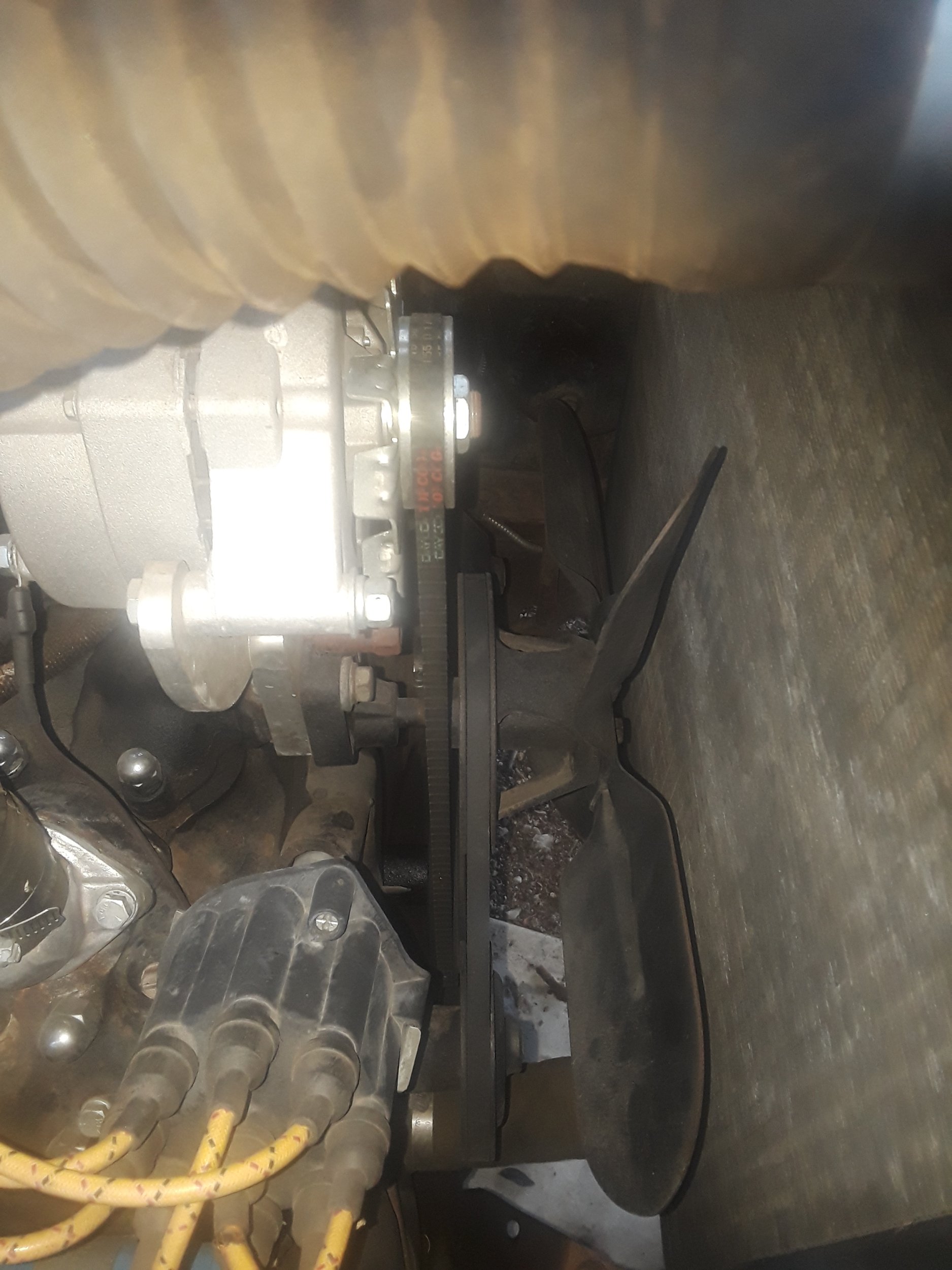

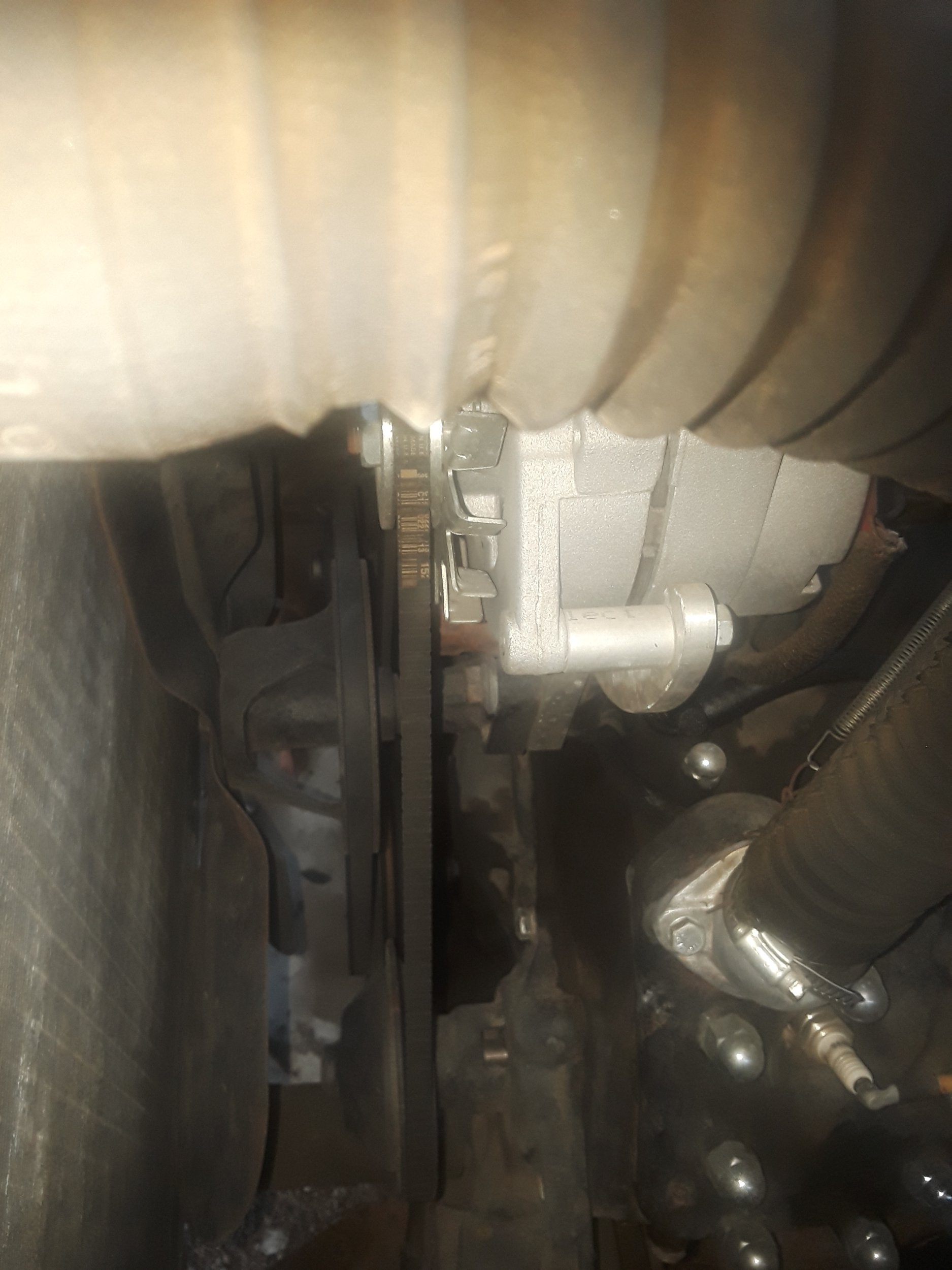

    My '39 p/u has an 8ba. I just use the stock 8ba fan set up. Sorry, not the best photos.

  5. That is exactly the set up on my engine, except I have the stock generator which has been converted to 12 volt, was told it wouldn't work because the fan would be to high. Guess ill stick the engine in like that and see what happens! You three guys are the only ones who responded to my question with the same answer, if it works for you it's gotta work for me! Thank you guys!!
