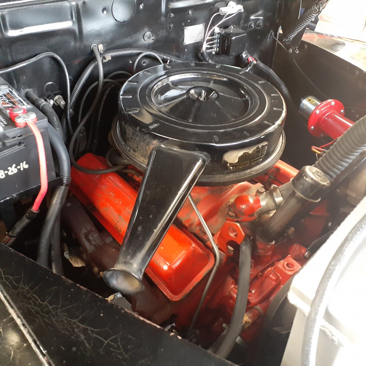

    Hey Hambers. I just found a 1951 8BA out of an F1 for what I consider a very reasonable price. Complete ***embled engine with everything back to the trans output shaft with lots of extra parts. I have no use for the 4 spd creeper trans. Been a few years since I played with a Flatty. My question is will the 8BA bolt to my stock 47 trans ? Thanks in advance. 20200601_182149(1)(1) (1).jpeg 20200601_181811(1) (1).jpeg

    Using the F-1 bellhousing, yes. It should also have the correct water pumps, and oil pan, for the swap. The side trim on your coupe looks like 1946.

    What's wrong with your SBC. That's a better choice budget wise over the long term.

    you will need the belhousing and it will fit the stock trans. When I got my 47 it had a 8BA in it.
    BUT if you are putting it in place of that SBC, you'll need motor mounts, radiator, exhaust, etc, etc to finish it. All that will be about the price of a SBC rebuild
