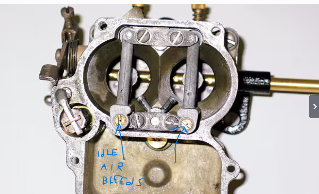

    Yuppers, running too rich on the idle circuit and pulling the line off causing what is basically a vacuum leak that leans it back out to where it wants to be. I'd try shooting some carb cleaner down the idle air bleeds in the carb throat and pull the mixture screw and shoot some carb cleaner though them to see the air p***ages are plugged up.

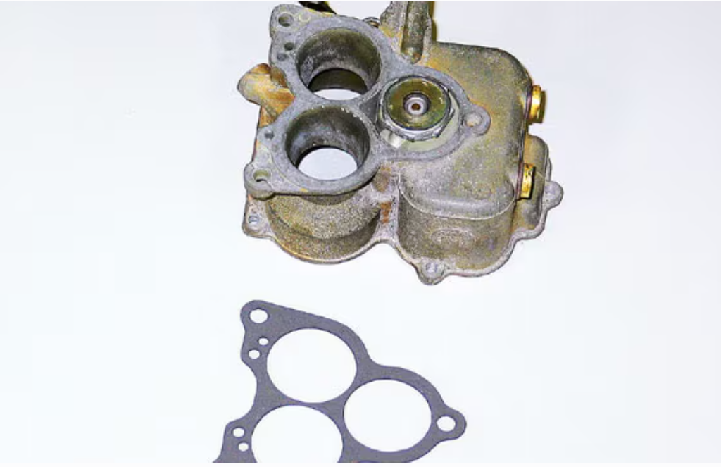

    If that carb is a Holley 94 like my 8 BA came with it also has a power valve that might be leaking. Screenshot (1568).png Screenshot (1573).png
