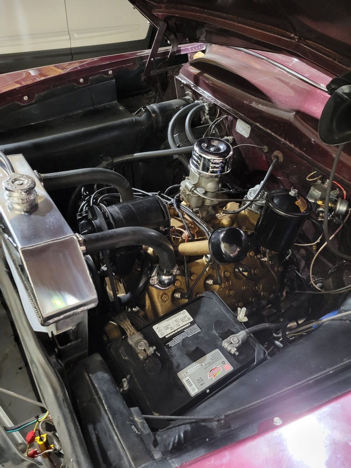

    Hey guys,
    Wanted to give you all an update. After installing all the new parts the car is running like a dream! I took it out this morning and ran it for about an hour and it never got over 180. I am super stoked to finally be able to cruise it after dealing with all this mess. Thank you all so much for sharing your wisdom and experience with me, I am so grateful to have found this community.
    Here is what I did in case anyone is curious or runs into a similar situation:
    Parts Purchased:
    Champion 3 row aluminum radiator
    https://www.jegs.com/i/Champion-Coo...CUSTOM&submodel=BASE&engine=V8+(+3.9L+/+239+)
    160 degree Thermostats
    https://shoebox-central.com/1949-1950-1951-1952-1953-ford-flathead-v8-160-degree-thermostat
    Water Necks
    https://www.speedwaymotors.com/1949-53-Flathead-Stock-Angle-Water-Neck,7313.html
    I followed the steps in the shoebox-central thermostat youtube video, drilling 3/16 holes at the 12 and 6 o'clock positions on both thermostats. I installed them using some napa auto parts gaskets and let them set for a day. I removed the temperature sending units I had previously installed from both sides and with a narrow funnel, poured about 10 quarts of coolant into the heads (until they started overflowing). I replaced the temperature sending units then filled the radiator with another 11 quarts of coolant (until coolant was about an inch below the radiator cap) and covered it with a 7lb radiator cap. I let everything sit overnight and checked for leaks in the morning. Everything ensuring I had no leaks I started it up with the cap on and took it out for a cruise. Today it was around 65 when I left the house. It took about 25 minutes for it to even get up to 160 degrees while driving. I noticed the thermostats open up at about 180 because it cooled down significantly back to around 160. I continued driving for a little over an hour, getting on the highway and then getting into neighborhoods where I could do some stop n go. Both SW mechanical gauges never went over 180 through the duration of the drive. I checked both gauges before installing them in some boiling water against a digital thermometer, they were accurate. I waited for the car to cool and checked the coolant levels and they didn't change by much so I left it as is. Overall, couldn't be happier! The radiator never spat any coolant out and there were no leaks even after the drive. Cant thank you guys enough!

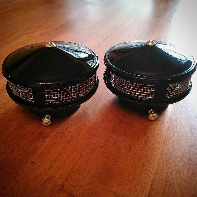

    Glad it all worked out for you. Only thing I have to offer is that if it was mine I'd ditch the tiny helmet air cleaner and go with something a tad bit big bigger. This is what I'm running on my stock 8ba with EAB heads. Engine 1.jpg But that's JMO.

    Thanks man, what brand/model is that?

    I believe it is off a Chevy 6 banger but not positive. IIRC there is/was someone who was making similar ones. There was a posting here about them, I think by Buba.
