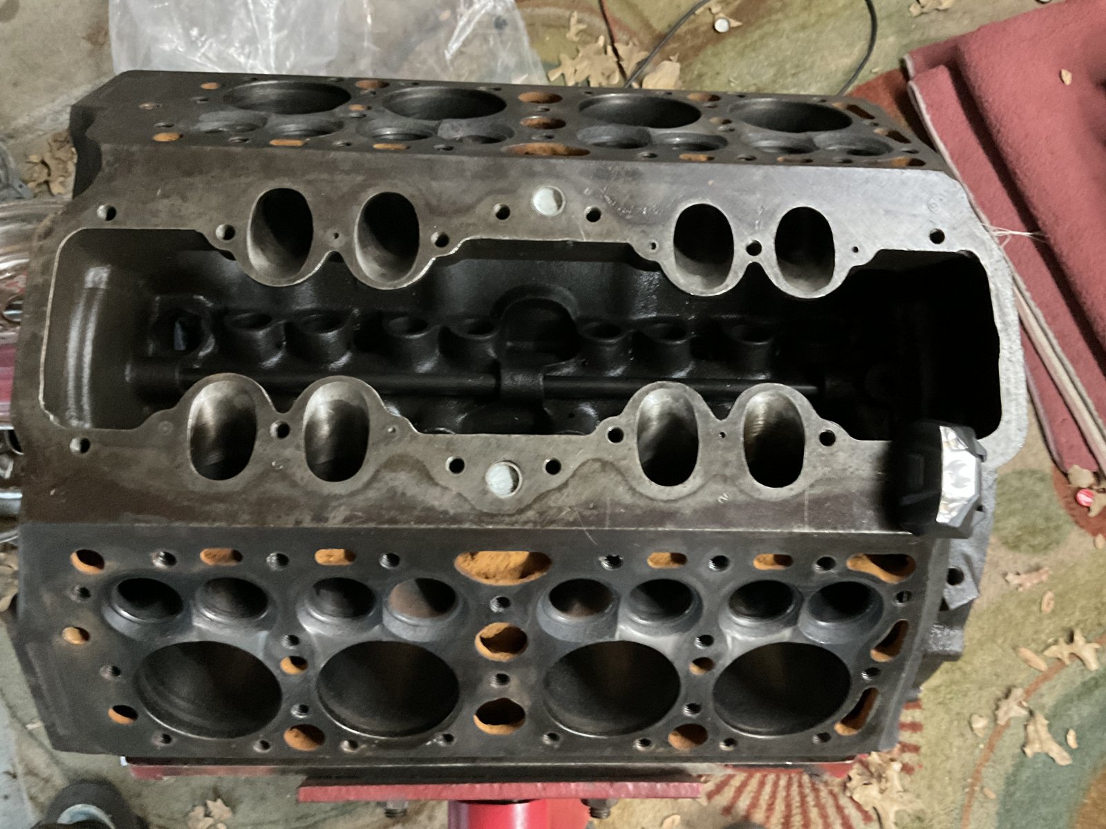

    Hello , I have a 59A Block and Crank will rods from a 8AB Work/fit with a 59A crank and block?

    Ok, my block has 59 on the bell housing. The heads have 59AB( but I don’t know if they were originally came off the block and I just mic’ed the bore at 3.210” I need rods and found 8BA rods and I can get a 8BA crank

    I got this engine from a guy that bought a ‘47 pickup and the engine came with it and in the middle of a rebuild. It has been relieved and has adjustable lifters, I’m missing 2 rod caps that’s why I’m looking for rods which brought me to my original question

  28. 26 FlatRod
    Joined: Sep 22, 2004
    Posts: 167
    26 FlatRod
    Thanks for all the comments and info. I am building a 59ab engine as well and I had the same exact question. My 59 ab rods were oval on the big end so I’m going with a set of 8ba rods that checked out. My 59 ab crank is fine but I have 2 other 8ba cranks to choose from so I’m going that route instead.
  29. 26 FlatRod
    Posts: 167
    26 FlatRod
    Where did you get the engine stand mount to bolt into the side of the engine? I need one of those.
