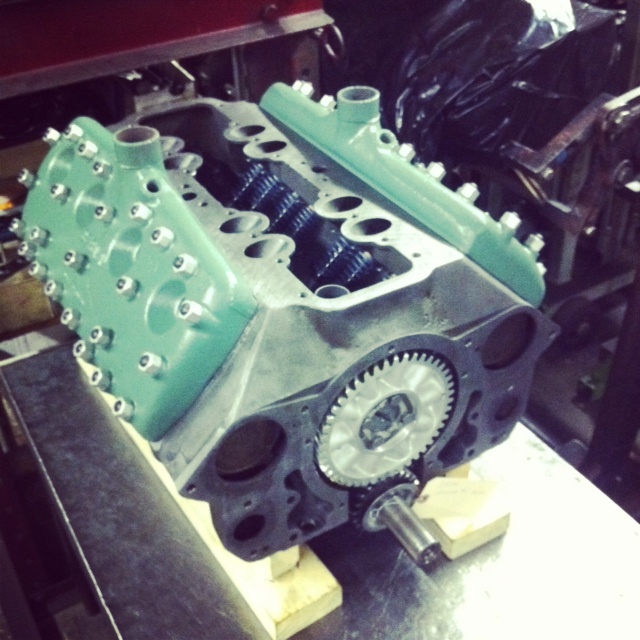

  10. kegmon
    Joined: Jan 11, 2013
    Posts: 9
    kegmon
    Just as a thread closer here, I finally got the oil pump out last summer. I ended up prying it up a little from the small end with a crowbar and some small wood blocks leveraged against and to protect the block casting. It moved about an 2" and stuck again. Shining a light into the cavity from the other side, I could see pieces of the shattered oil pump casting lodged in the passageway next to the pump. Once those were removed, the pump slid right out.. but now need new pump. Live & learn... Block is now thermal cleaned and at the machine shop awaiting delivery of some 3 ring Egge .125 oversized pistons and boring.. Assembling parts now, new water pumps, new radiator, considering putting a PCV valve in as opposed to the original down draft tube. Also a dual 94 carb setup...
