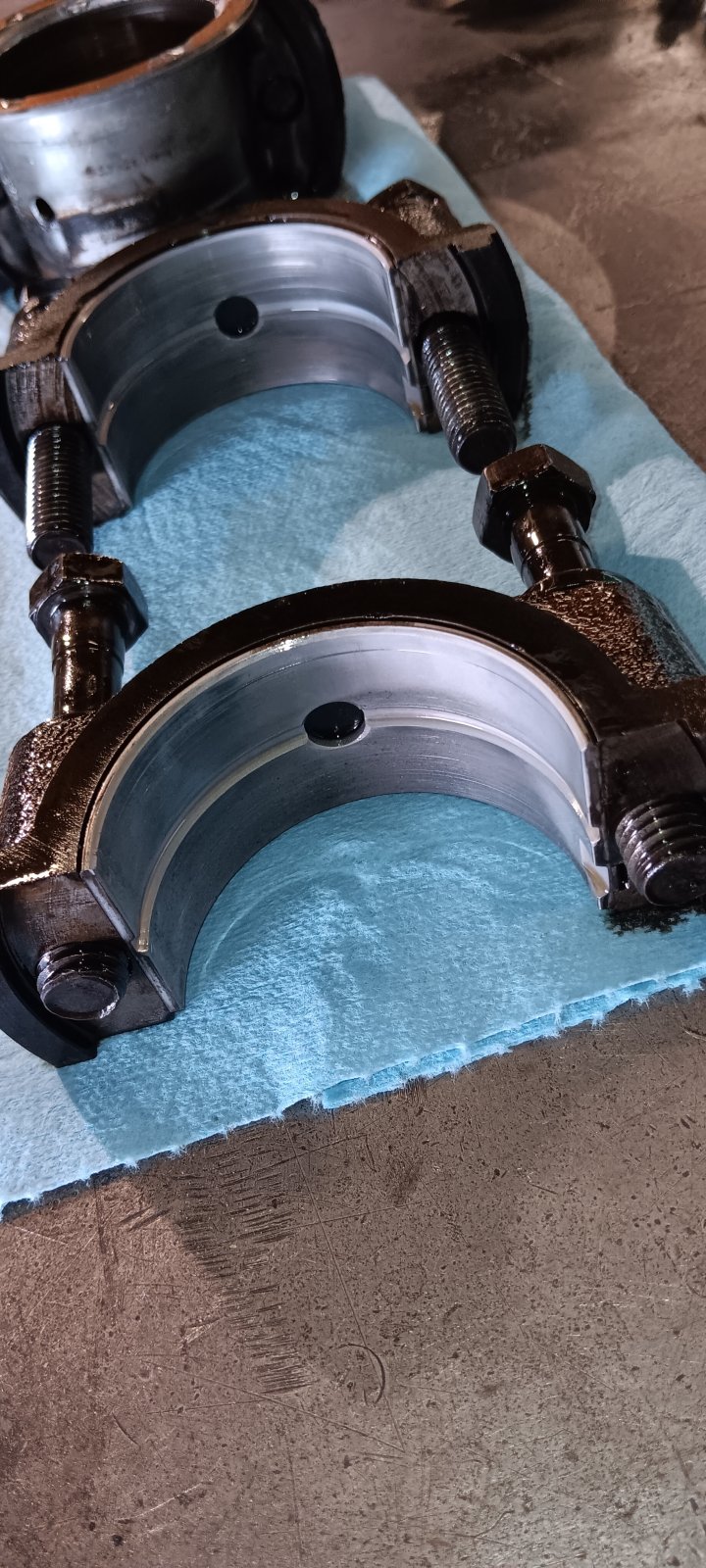

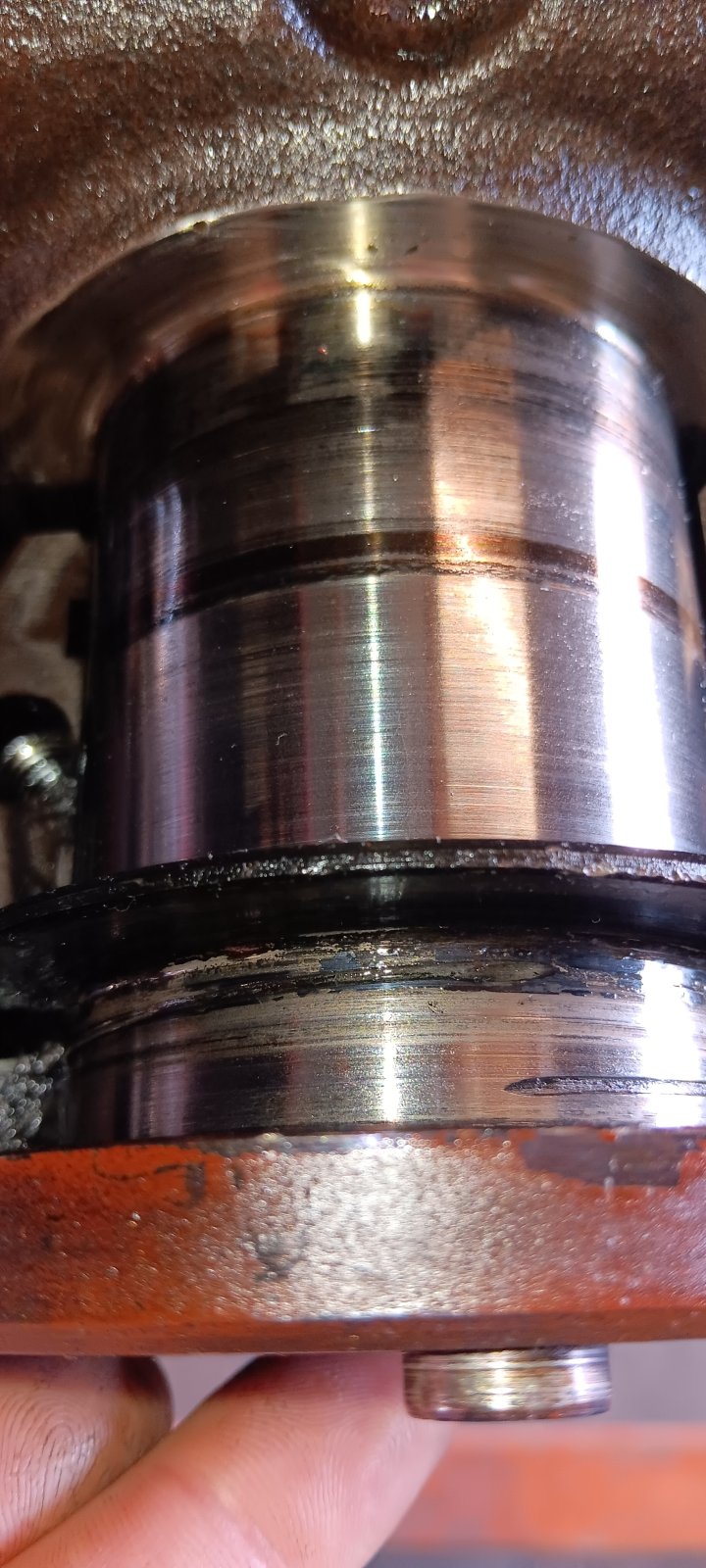

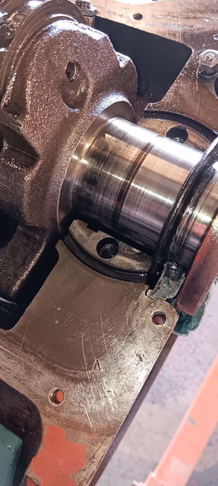

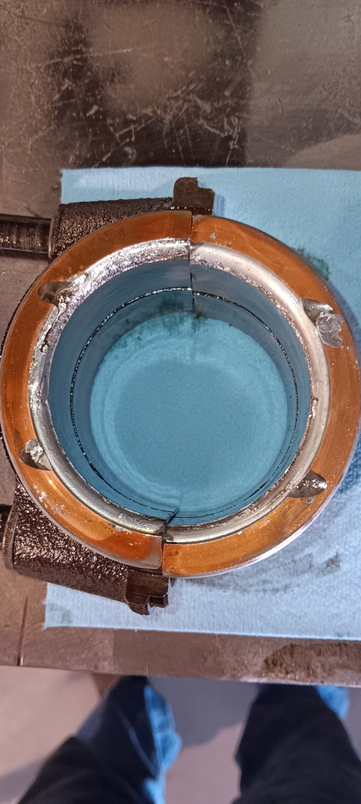

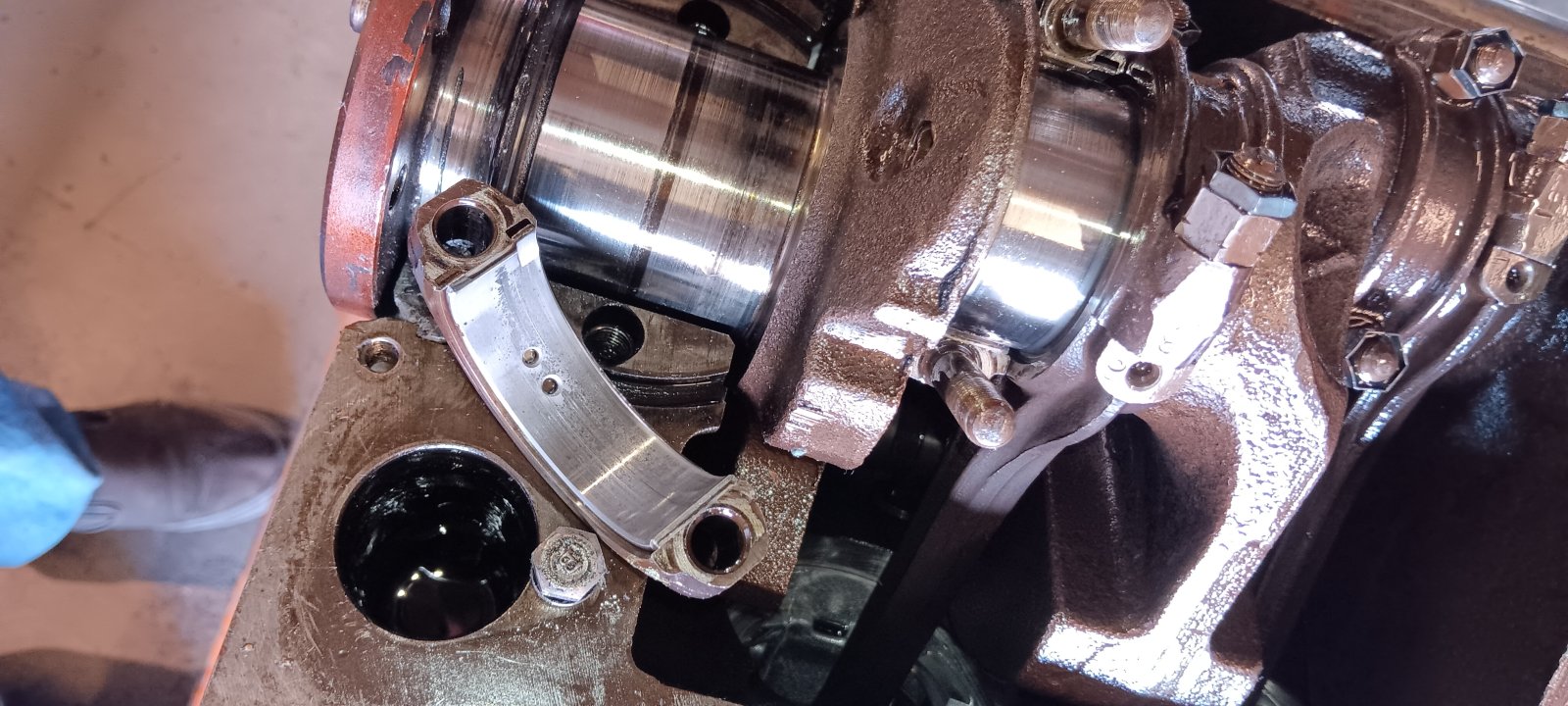

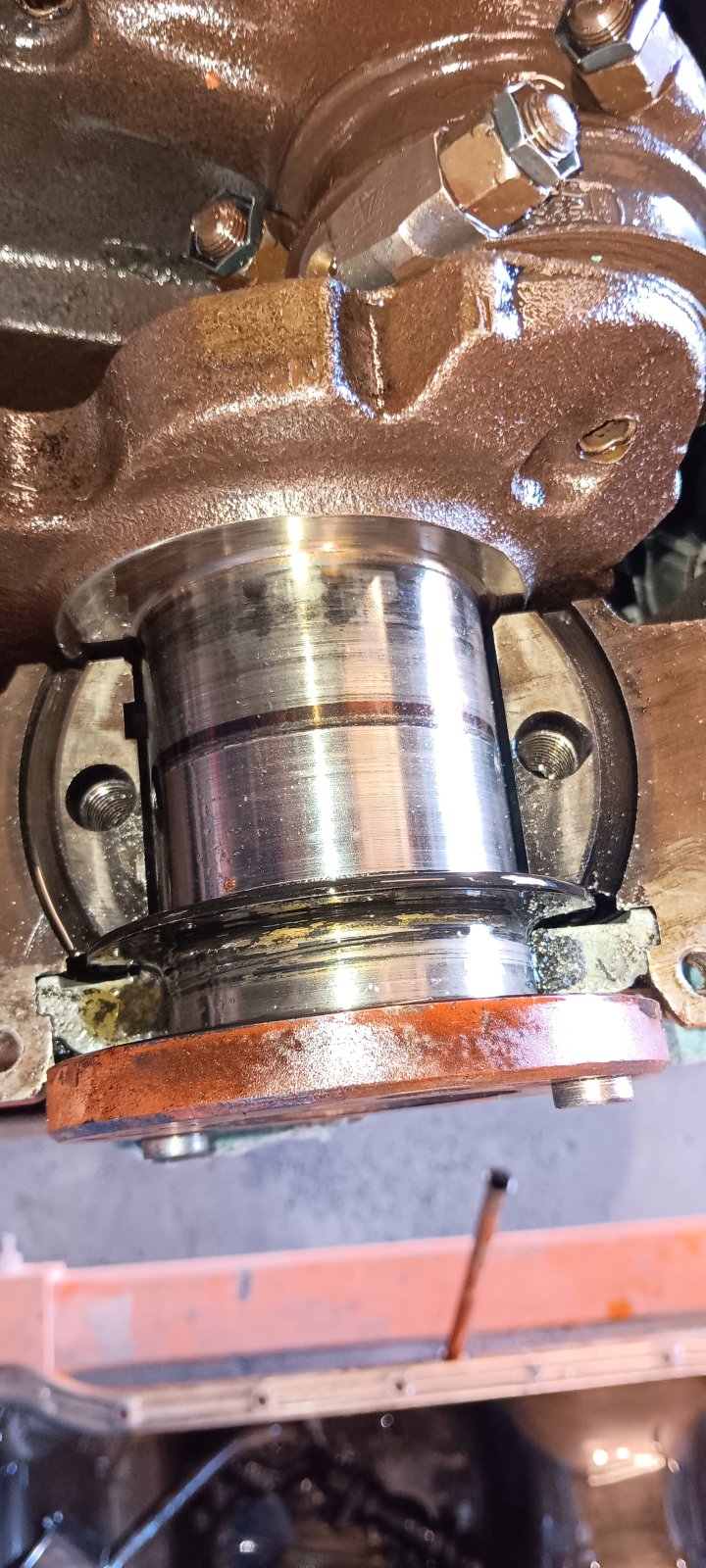

    customer states flathead is leaking ALOT. So it is leaking badly out of the rear main seal area.I pulled the motor and found that the rear main seal has moved and there is about a three eighths inch gap. Okay That's the oil leak problem. I pulled the main bearing To check. And the rear main bearing is wasted, as is the thrust surfaces. The crank seems to be fine As far as gouging, but has a dark spot on one side.. It had very low oil pressure, but it was using the stock shoebox Ford gauges. It was rebuilt at some time as these are 10 under bearings. What say you? Toss in a new main bearing and good oil pump and let it go or tear down. 20241010_090938.jpg 20241010_090953.jpg 20241010_091005.jpg 20241010_091012.jpg 20241010_091040.jpg 20241010_091056.jpg 20241010_091306.jpg

    In the images, that crank does not appear to be "fine" at all. Looks like it needs to repolished at a minimum, and more likely recut to the next size under, depending on the geometry. In addition, it needs to get taken out and thoroughly cleaned to get all the bearing material out of the galleys.

    By fine, I meant no gouges, but yes, it doesn't look great, but it still feels smooth.

    Looking at the images, especially the close up, it looks like the bearing started to delaminate. Possibly due to a manufacturing defect, possibly due to a crank journal that is slightly oversized and did not leave adequate clearance for the oil film. I also don't like what appears to be uneven wear between each side of the bearing, possibly pointing to incorrect journal geometry, or a bent crank. Journal bearing failure root cause is one of the most difficult things to identify because the bearing is typically destroyed in the process.

    To me ,it looks like the bearing shells were not fully seated or the rear main bore was not uniform in diameter. I'd clamp the rear cap on and check with a dial bore gage .

    I turn the crank around a few times to see the worst part. And it seems to have chatter marks for lack of a better word. 20241010_112837.jpg

    Crank journal looks bad, that’s probably the cause. Make sure it doesn’t go back to whom ever rebuilt it last time.
