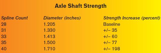

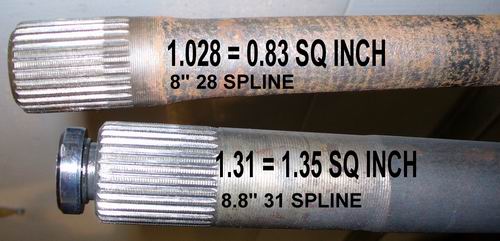

    A good 8.8" has 31 spline axles and not 28 spline.

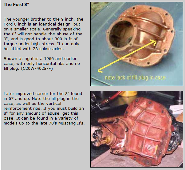

  7. mgtstumpy
    Joined: Jul 20, 2006
    Posts: 9,279
    mgtstumpy
    Comparison of pre 1967 (Single) and post (Twin) rib case
    fredeuce, Deuces and lake_harley like this.

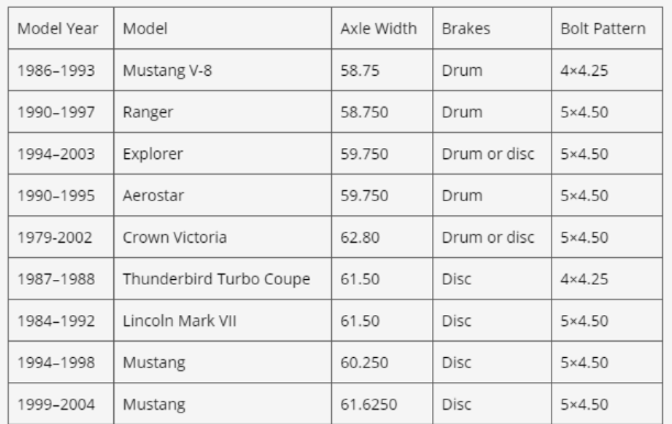

    Look at it like this.........Everything you do to the eight inch will be as expensive as everything you would do to a nine inch. You will probably find some things for an 8" actually cost more because of less availability.
    With a 9" people always want to find one thats narrow. When/if you find a narrow one, people want more money for it. Then it usually has 28 spline "small diameter" axles comparible to an 8".
    Best thing to do is find a wide 9" and get the axles machined or buy some new Moser axles and narrow the housing. No matter which way you go, doing it right will get expensive......but it will hold up.

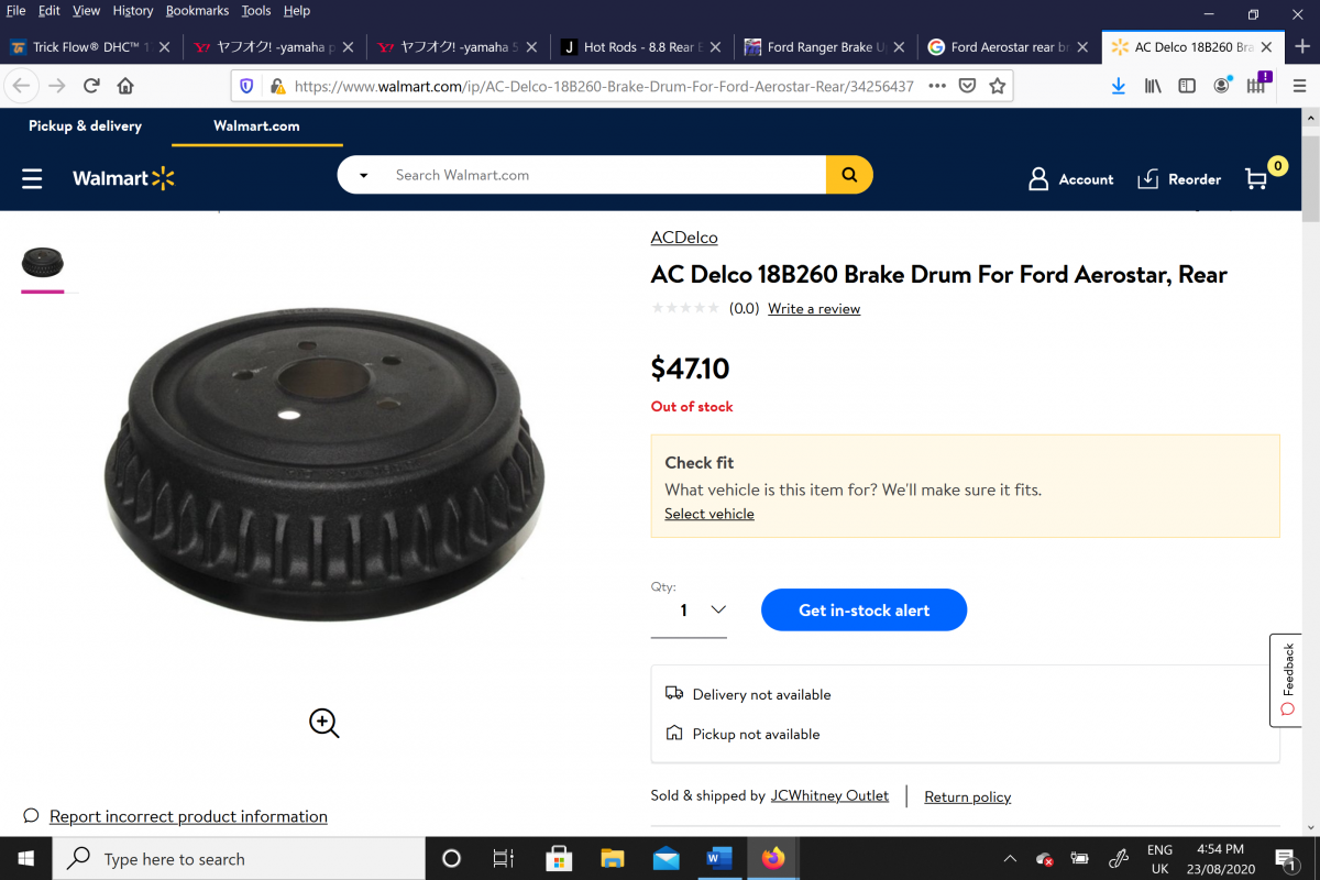

    For a decent option at a lower cost I would look at some of the 8.8s and see if I could find one that was the correct width and had factory posi in it. Thats the cheapest way to get a decent rear thats pretty strong ......if you can find one.
    Here is some helpful info: Go to Amazon and get this book. Lot of info on where to find what you want as well as rebuilding.

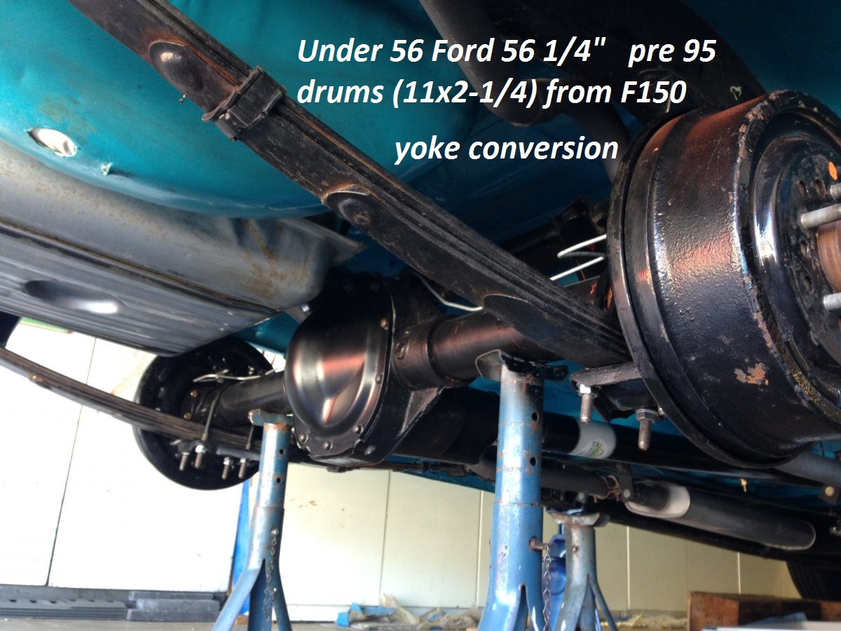

    You tube 8.8 narrowing. Pretty simple. Thanks for showing mine in our 56 Ford. One side narrow 2same axles. The 8.8 is more efficient do to a raise of the pinion over a 9”. Not a big deal to most.
    9” are obsolete by Ford standards even though aftermarket has covered all of it for years..
