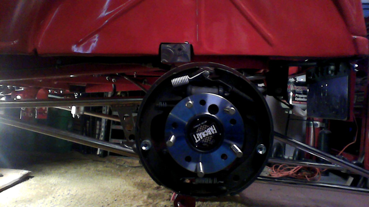

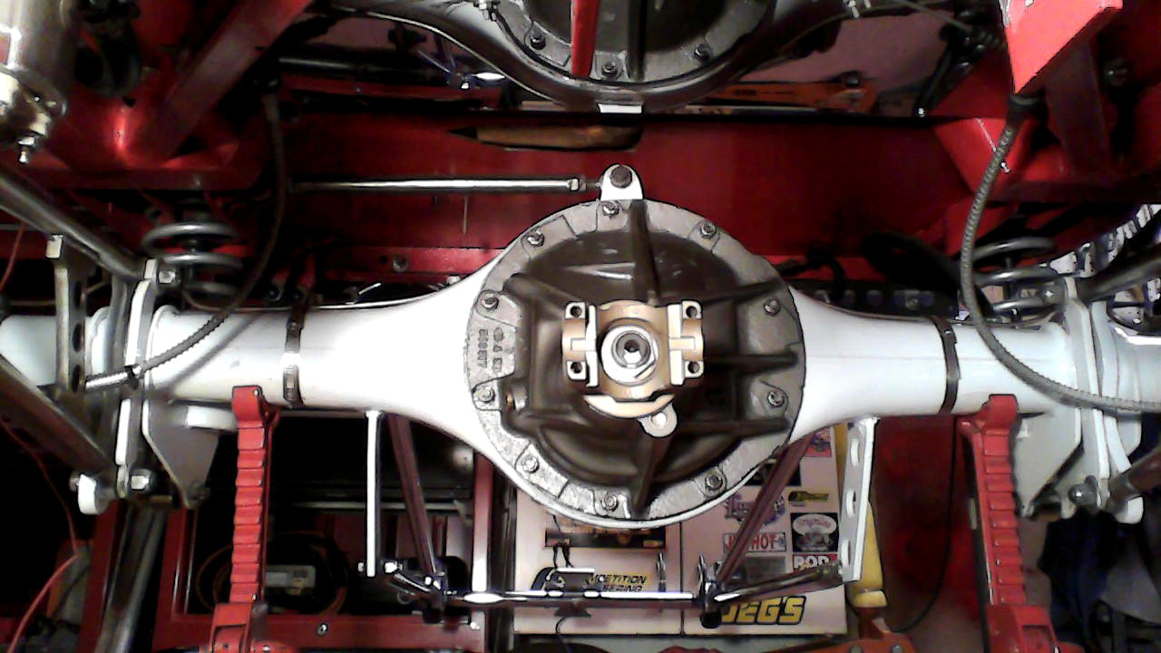

  4. WIN_20180318_12_53_50_Pro.jpg Yea. FabCraft did my entire 9.3. 4:88 gears, chrome moly heat treated axles, seals, bearings, everything. Not cheap , but damn near indestructible.

  7. A few more pictures of the FabCraft 9.3 in the coupe. WIN_20180318_12_53_31_Pro.jpg WIN_20180318_12_52_33_Pro.jpg

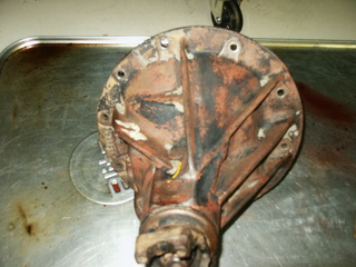

  15. Does a casting number of 30942 on the case give any insight on what a unit is? I have a line on a posi, thanks
  16. saltflats
    Joined: Aug 14, 2007
    Posts: 13,285
    saltflats
    from Missouri
    That doesn't sound like enough numbers for a casting number.

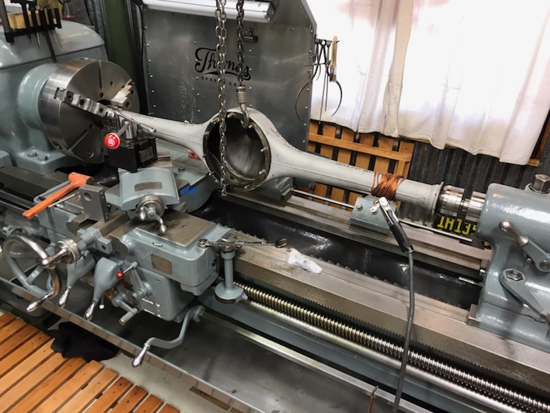

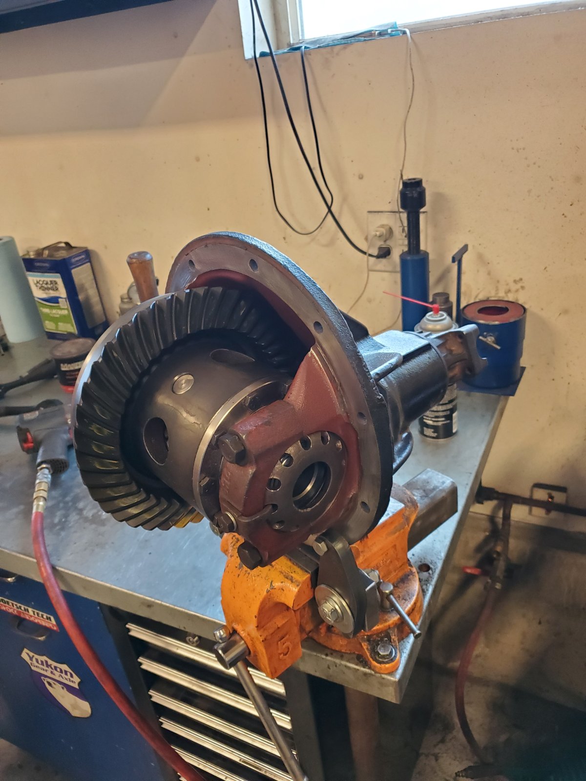

    What operation are you doing here?
  21. -Brent-
    Joined: Nov 20, 2006
    Posts: 7,719
    -Brent-
    Narrowing it.
    mad mikey and GuyW like this.

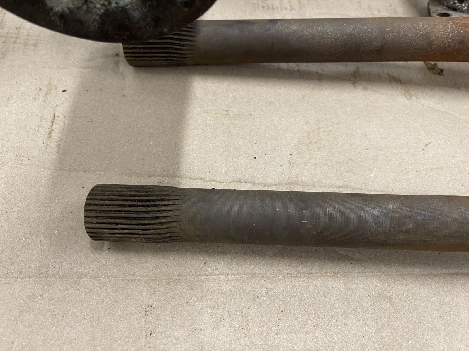

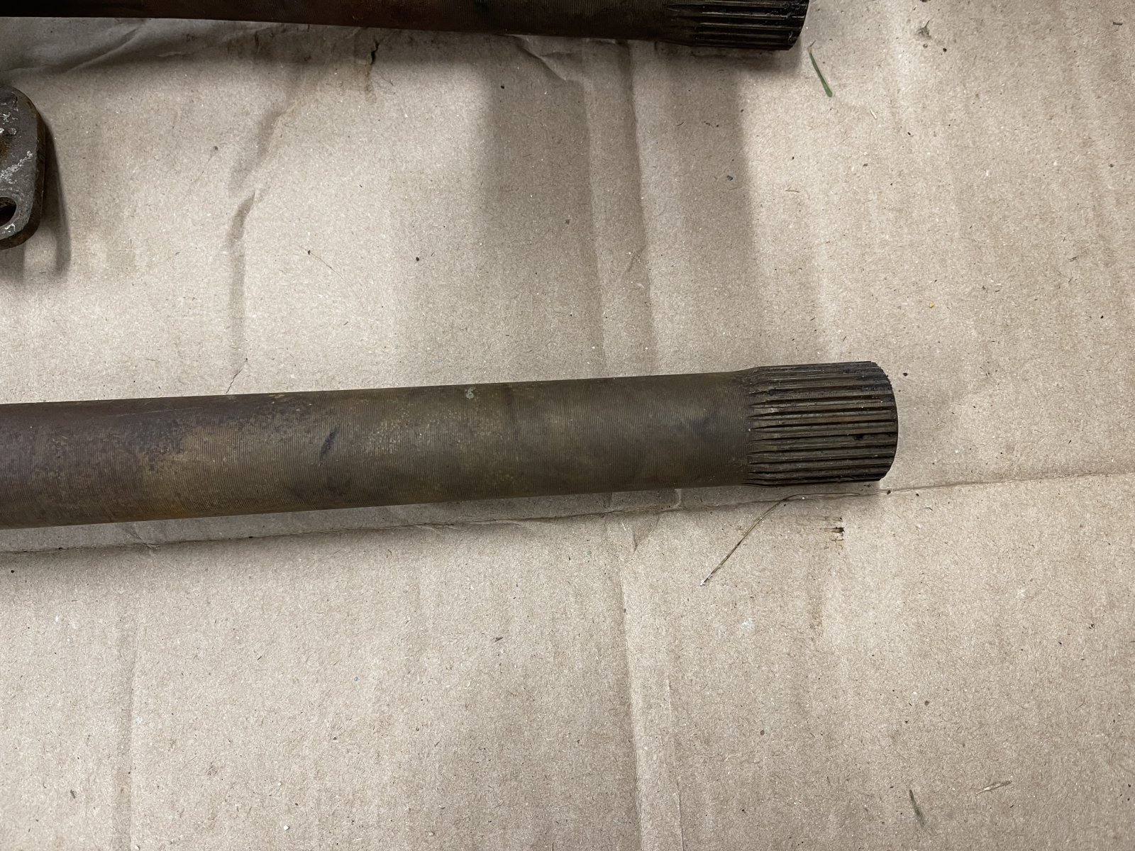

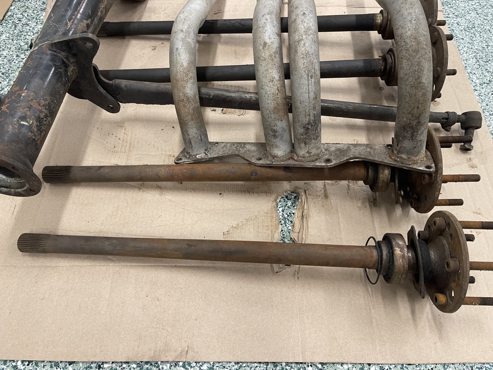

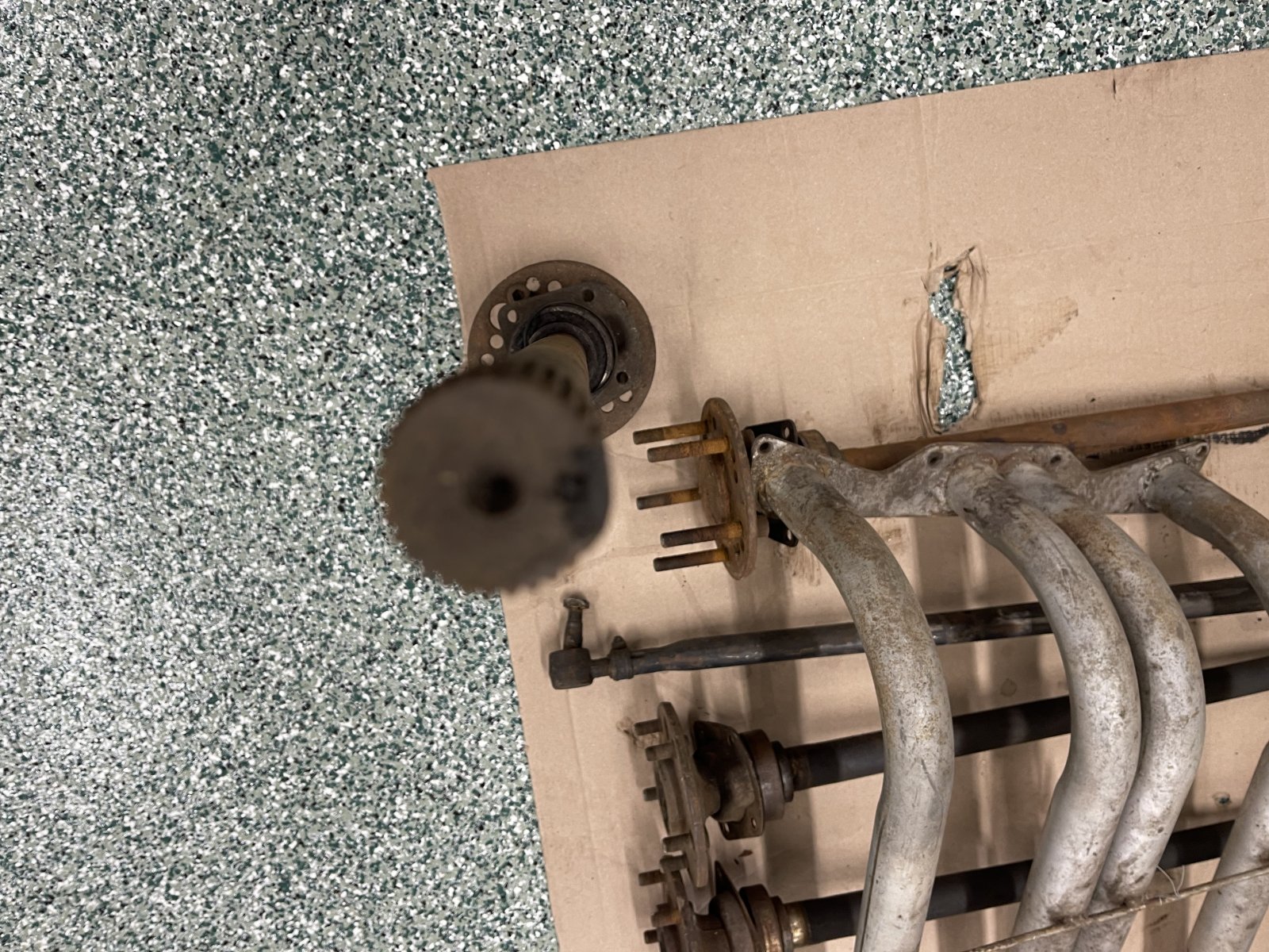

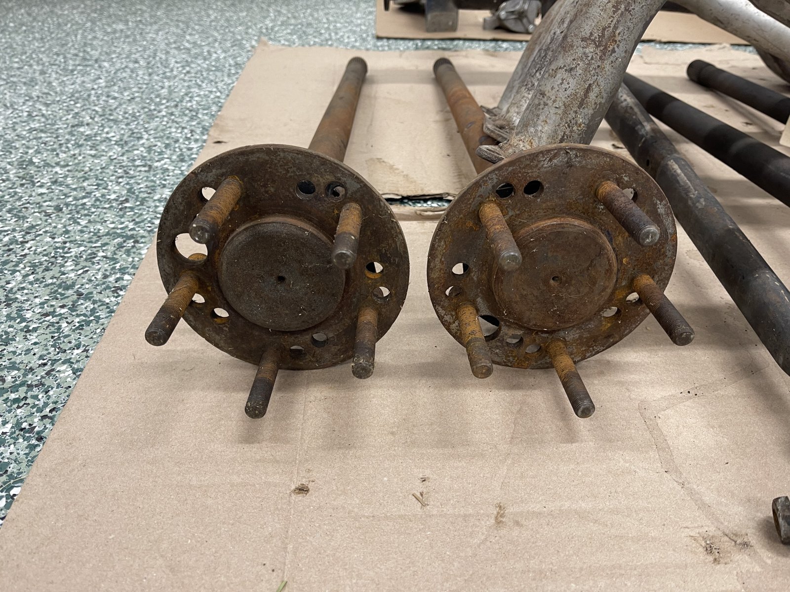

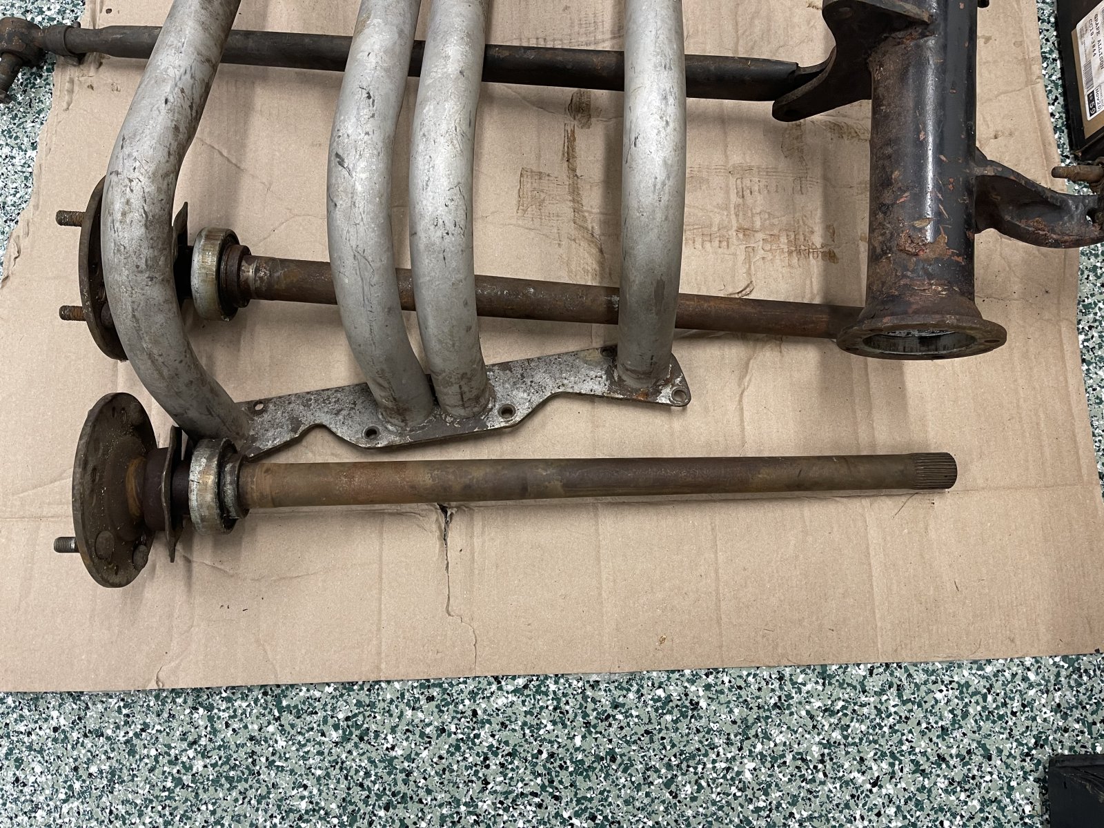

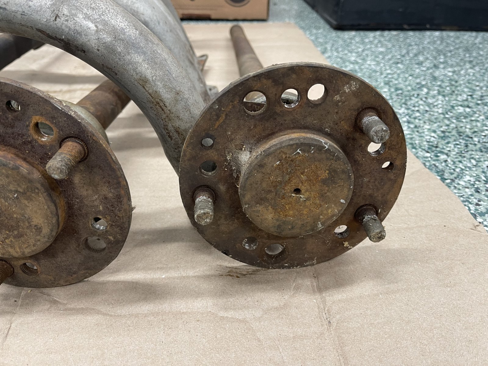

  22. Anyone have ideas of what brand axles these may be? guessing early aftermarket, they are 31 spline 9.3
  23. Scott Younker
    Joined: Feb 3, 2022
    Posts: 335
    Scott Younker
    57 & 58 9.3’s are 29 spline and width of housing was narrower. That’s why tri five guys like the 57/58. 9.3’s went to 31 spline in 59 & up and axles were a little stronger but also wider.
    BOSTONCAMARO likes this.
  24. mad mikey likes this.

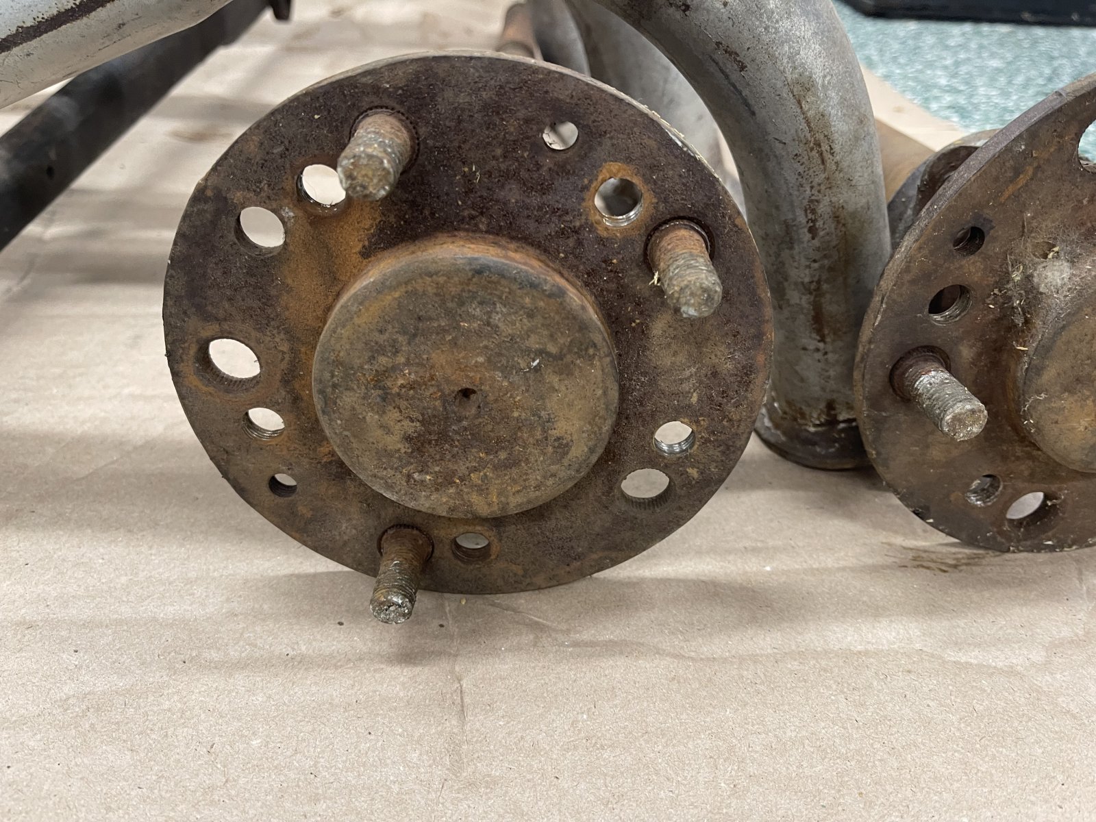

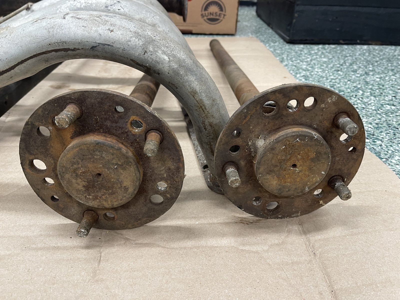

    If you are right there is a good chance they were made by Henrys in L.A.
    They were IT back in the day.
    BOSTONCAMARO and mad mikey like this.

    427 sleeper

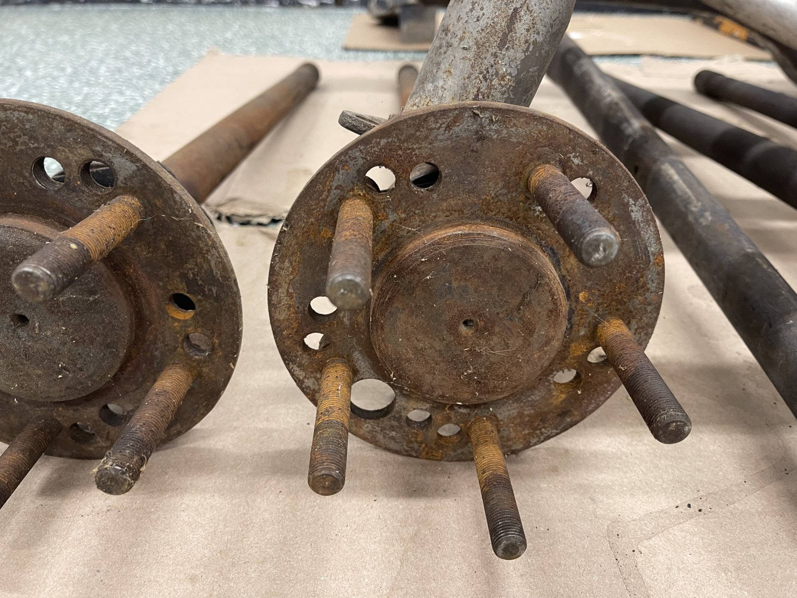

    Don't know what brand they are but they don't look too useable with those twisted spline's.
    They might just be redrilled stocker's.
    SS327, mad mikey and BOSTONCAMARO like this.
  27. yes, saw the splines, these came with a big 9.3
    parts buy I did
    427 sleeper and mad mikey like this.

    In the late 70's I owned a former pro stock Ford drag car (OT), it had been powered by a 427 SOHC.
    The nine inch rearend had Henrys axles that had twisted splines, when I asked around I was told they were known for that but they would not twist further.
    BOSTONCAMARO and 427 sleeper like this.

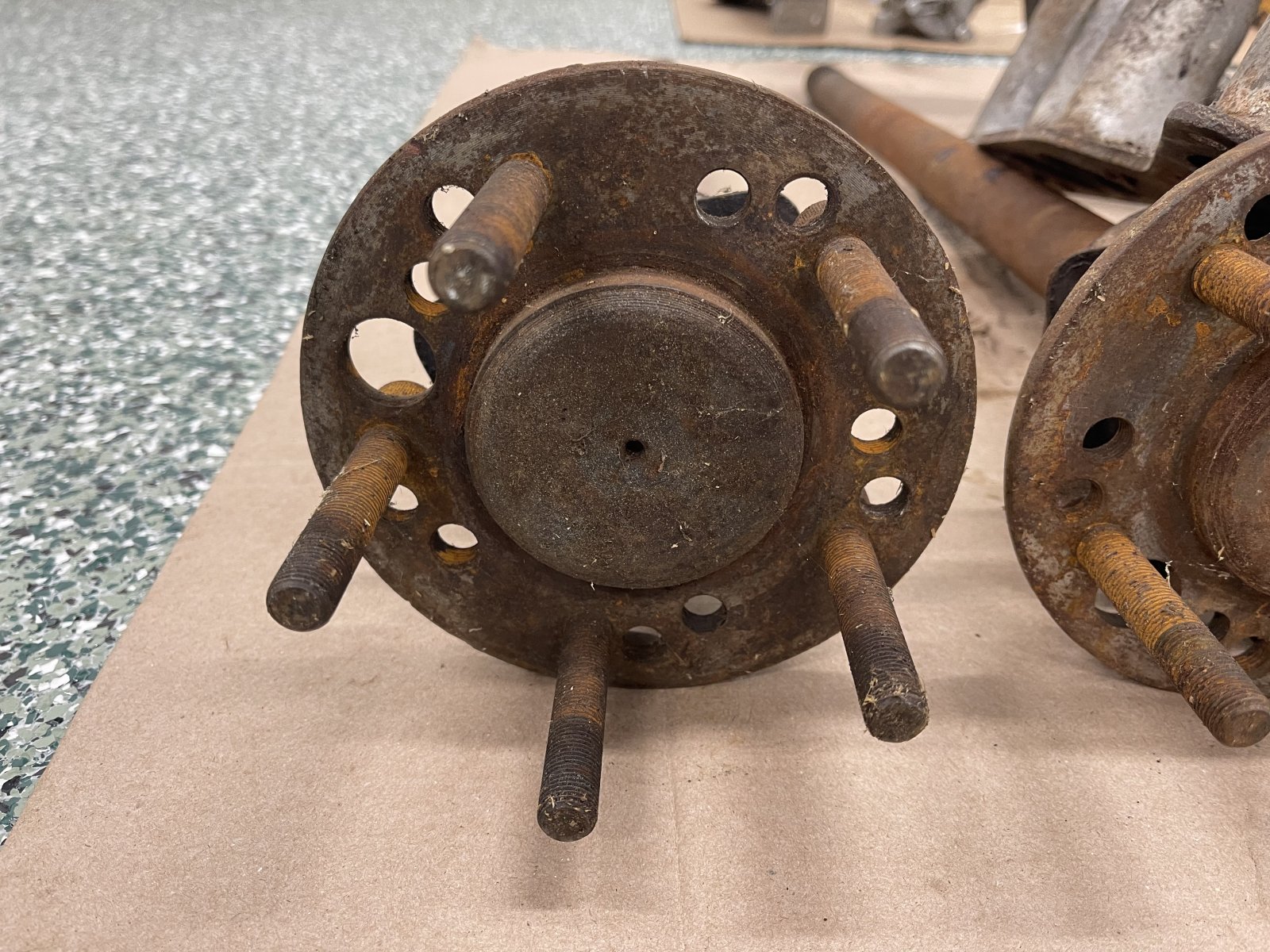

    The hub portion doesn’t like any thing like the stock ones I have. Could they be Summers?
