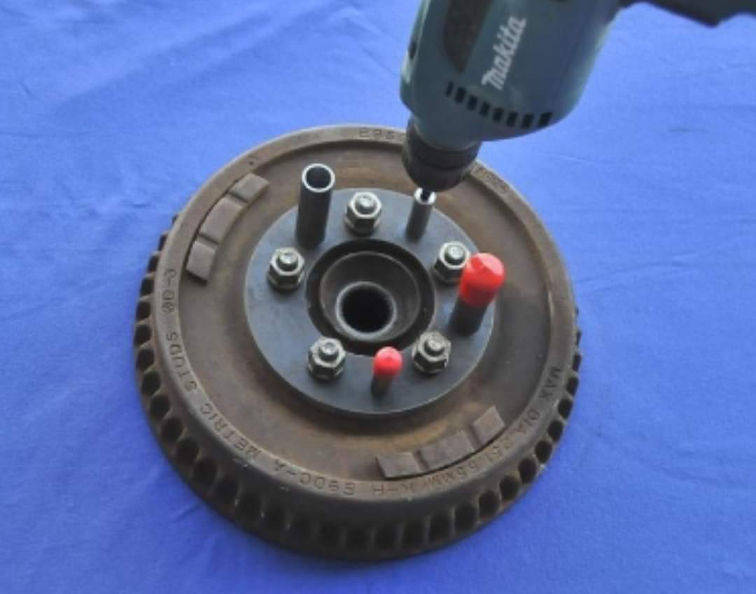

    This was my first consideration but a brake upgrade would be icing on the cake. The '63 1/2 drums are pathetically small for a fast car.

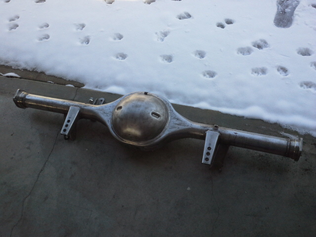

    Getting as rare as chicken lips but this is a 57 1/2 ton housing, you never know, you might stumble onto one if you know what you're looking at, the braketry and ends have been changed and it has been narrowed.
    Edit
    Now that I think about it, I had to add 2 inches to one side due to my wheel backspacing.

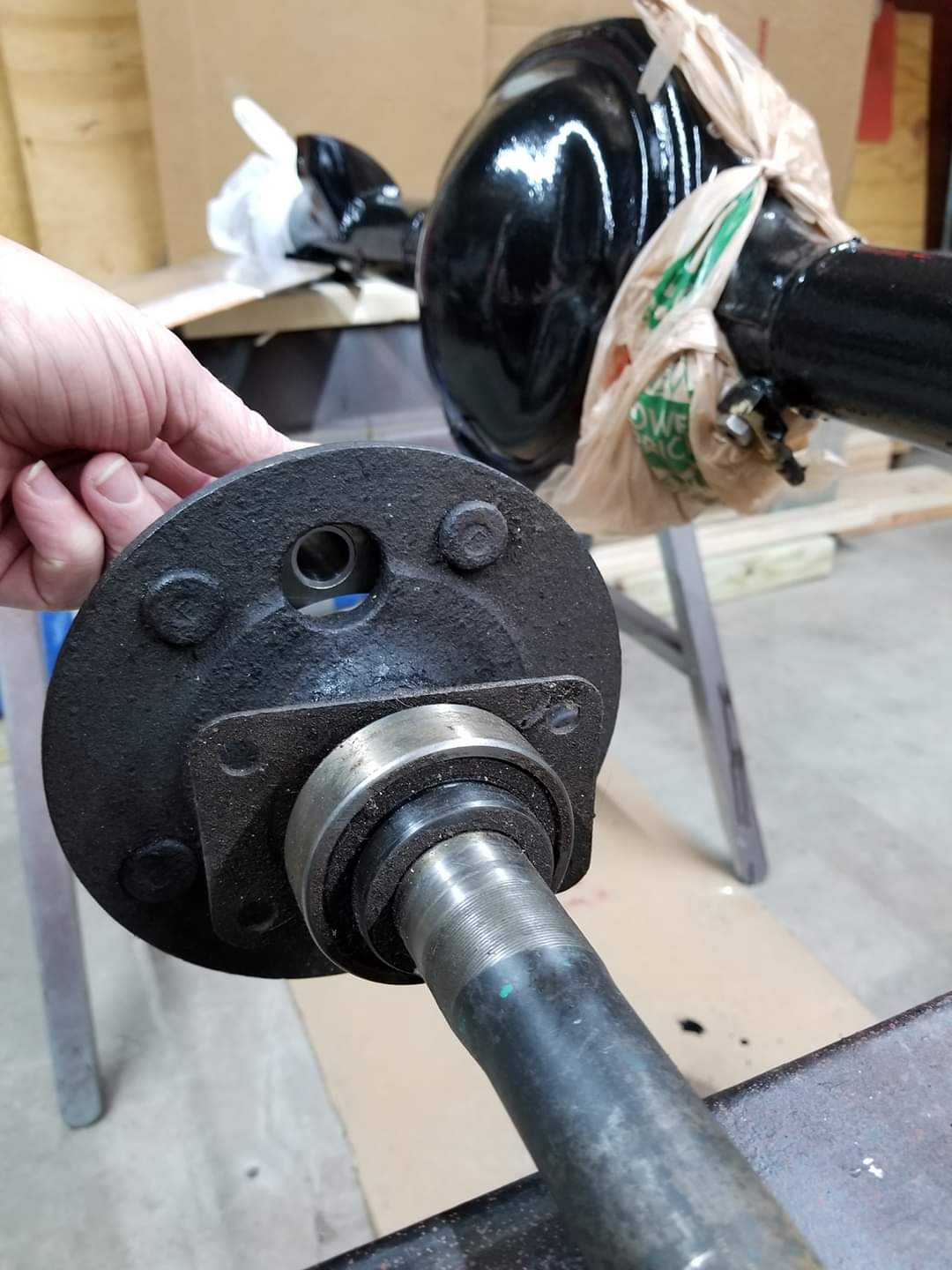

    The bronco only had 2 gear sets available, 4.11 for 6 cyl models and 3.50 for the V8, the axles have the access hole so you may need to weld that up to redrill it to 5x4.5 pattern, 5x4.75 pattern definitely lands in the hole.

    Yes, was looking @ the access holes thinking about drilling for the smaller lug spacing. That way can use the wider, bigger drums for brake upgrade. The 3.50 is my preference w/ the T-10 & no OD. Muchas gracias, amigos!
    Have a plan- pull the rear wheels, plumb bob the drums, mark the floor & measure. Then measure the Bronco.
