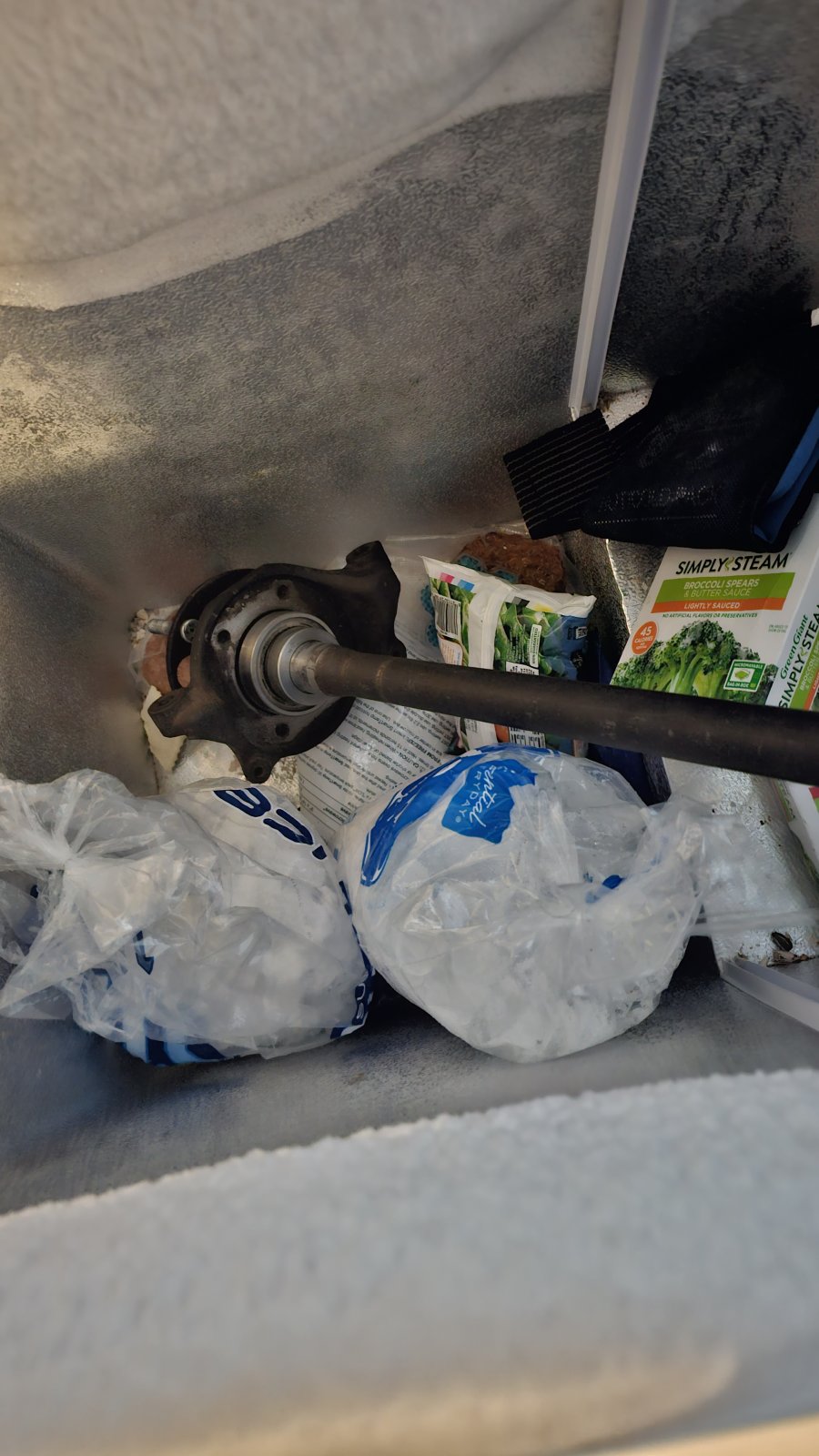

    Don't tell the wife!
    Boiled the sleeve and froze the axle.
    Used the press this time as well.
    Debating on if I am leaving the flange on the sleeve or not.

    If it fits in the lathe, do you have a welder? Or an OA setup and braze it?
  26. Don't worry about the flange, until you need to.

    It was too long to fit in the lathe with the tailstock/center thing. The cutting end of the lathe would not reach the end of the shaft to cut a weldover/cut.
    I got it chucked up enough and supported to sand down the epoxy as level as I could and install the sleeve.
    The lathe was always off limits to me so I was doing my best to not mess it up...lol.

    Well, what you could do if so inclined( and maybe score a meal from mom) is smooth out the hub end, then center pilot it if you have a live center for the tail stock. Then you are “turning between centers” and can approach the cut from hub end in.
