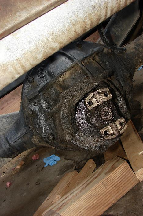

    guys can someone tell me what type of yoke this is? The flange itself is 3.5" across O.D., The I.D. across the flange is 3", Center to center on flange bolt holes are 1.25" of narrow measurement and 2.25" on the wider measurement. hope my description isn't confusing. thanks! the bolt circle is 5 on 4.5" and the rearend id is 1967

    The yoke is for a "mechanics" type u-joint.

    can anyone add to that as i'm not familiar with this type. thanks so far.:D

    When I just did a search for "mechanics type u joint" this was the first result :
    http://www.drive-lines.com/ujs/uj_mechanics.php
    I have seen them used on trucks and older cars.

    they must have used this type of yoke since they had a 402/pg in the truck, they look like they use a heavy-duty u-joint. Can a guy simply change the pinion yoke?

    Yeah you can change the pinion yoke, but make sure you understand about pinion bearing preload, etc before you do. There's a little more to it than just swapping the yoke.

    i should have been a little more clear that i do understand bearing preload and directed the question to the pinion yoke seal as that i what i was thinking but not typing, DOH!:eek: Someone must have swapped things around as this rearend seems to be out of a mid 60's car, did they have this type of yoke? Are these high HP setups? thanks.:D

    The stock 9" in my buddys '57 Ranchero had this type of yoke and '57 was the first year of the 9" rear. Check the diameter of the ring gear, if its less than a true 9" diameter, someone swapped a '57ish 3rd member into your later housing, or changed the yoke. The fact that they stopped using this type of yoke in the mid to late '50's says that they arent a high HP setup.

    It's a more expensive design to make, so that would have had something to do with it being superseded. They are heavier too. They are still used in heavy trucks, so strength apparently isn't an issue.

    I have a 57 9" in my truck and it doesn't have that yoke.

    I have to admit i have never seen one until i posted this thread. Makes me think that the dropout may be a early 9" from the 50' and the housing is from the 60's. damm u-joint is 5 times the price and not very common item that really results in having to carry a spare.

    50's truck yoke from what I've noticed on one or two of our trucks before.
    I'm pretty sure those yokes are decently strong as some friends of mine own a towing company and if I remember right, their heavy trucks use those on their drive shaft yokes too.

    little update on yoke: removed it today and along with the pinion seal and was wondering are all 9" ford pinion seals the same? from what i measured the O.D of seal is 2.93", .371" thick and pinion yoke O.D. is 1.8" and it was a ford seal with no numbers on it. pinion yoke I.D is 1.3", would that be standard 28 spline yoke? thanks guys.

    no, there are a couple different seals.
    Most of them fit a 3" housing bore.

    If you have the casting number of the part it fits into that would help. For example C5AW or something similar. C5A means 1965 full size car

    looks like a national seal 7044NA is the one i need from my research.
