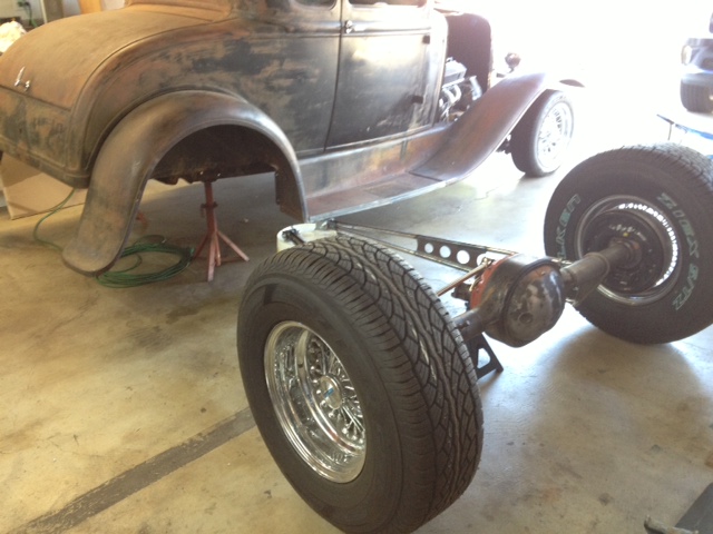

    Ok guys I need some help. I've been looking at 9" stuff all day. And need advice. I bought a 9" that is 61.25 long. Has no axles but came with 3rd member that is 4:11 ratio 31 spline. Paid 75 dollars for it. It is a old style big ford. So 3.5 x 2.375 I need to get axles and brakes. I have juice brakes on the front so I don't think discs will help that much on the back.
    I need to know -
    Best place to get axles for a good price and length.
    Brakes
    What 3rd member I have and is it worth keeping.
    Kasey

    I went with Dutchman for the axles and drum brake assemblies. Fits with no issues and good pricing.

    Will they tell me what diff I have and brakes to use?
    If my calculations are right if I use 2 3/8 drum brakes the axles I need are 33.938
    29.938

    It's going in a 31 ford coupe. The tires are really wide. I forgot the size. It will work fine.

    Make sure you get the brake kit you want BEFORE you narrow, and measure, measure, and measure again. This is my '31 and I woun d up narrowing it to 52" wms to wms.
