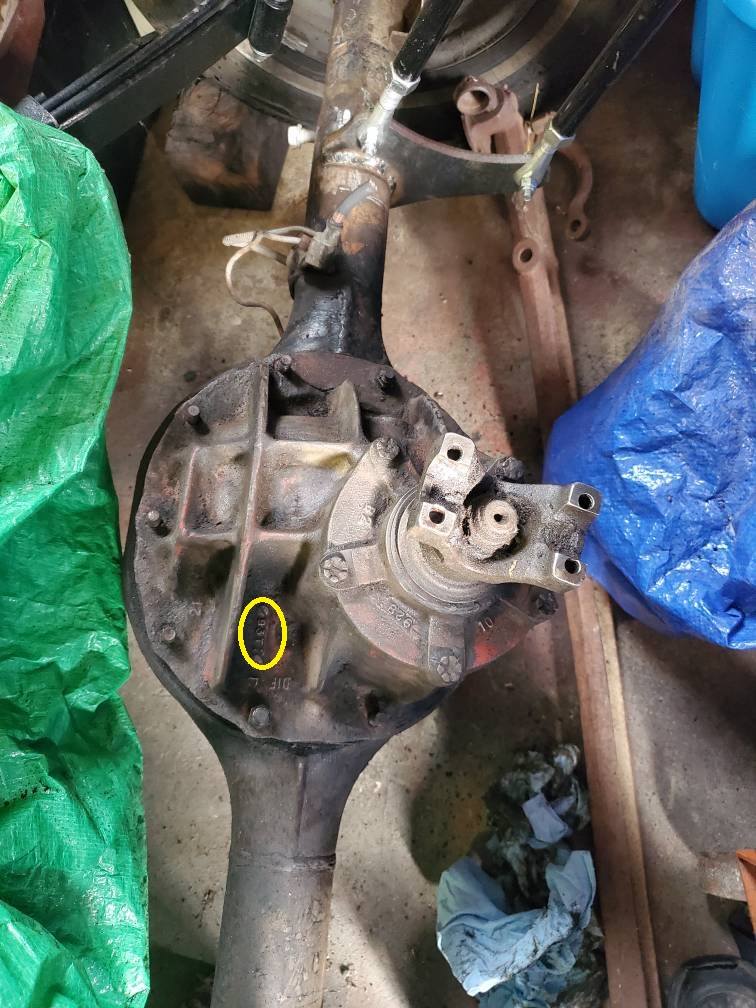

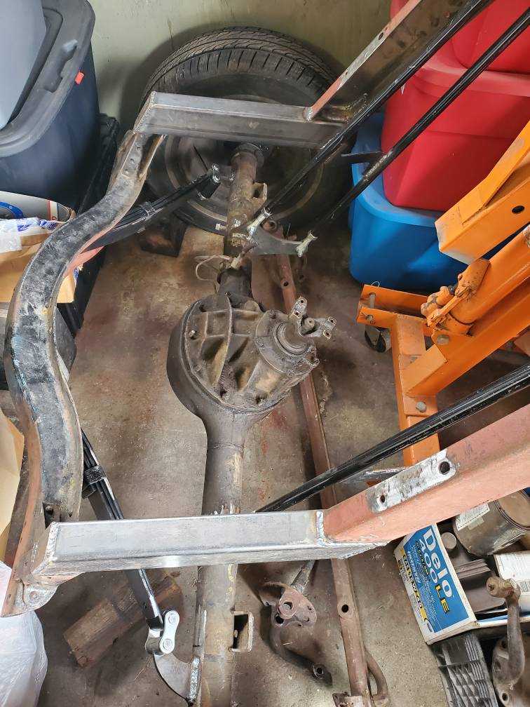

    Have a Ford rear I bought from a friend for my '28 Mod A frame, said it was Mustang. The metal tag is long gone, unearthed some stamped #s and letters, "WAT", 93T, 928 and 82
    Just tryin to find out what it came out of, it's vintage, etc 20210328_174049.jpeg 20210328_164100.jpeg

    what does it say right here?
    It's a relatively early case, it looks like. And it might be pieced together...looks like you're missing brakes?

    This is what is I always called a WAR gray iron case . It is early case as stated . It will be fine in an A Model. You will need to remove it to determine bearing size and axle spline while you have them out also . I suspect it’s rather wide for an A Model . Can you get an image of the rear of the housing ? If you plan on replacing it , determine if your housing has a fill plug . If it doesn’t your case will need to have one , already or drill and tap the boss while you have it apart .

    Says 93T

    I was hoping it might be one of the later style date codes, but no...
    I don't know what that means.
    Anyways, you're probably going to have to measure the axle offset and take it apart and look at stuff to figure out what you have, and what parts you need to make it work.
