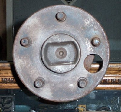

    28 spline axle shafts can be ID'd by looking at the center brake hub area; a big rectangular slot in the center usually indicates a 28 spline axle.
    31 spline axles usually have one small center chamferd hole and two outer holes (one on either side of it). Take a look at the pictures below:
    Finally, everything you need to know about Ford 9" rearends is here: http://www.kevinstang.com/Ninecase.htm
