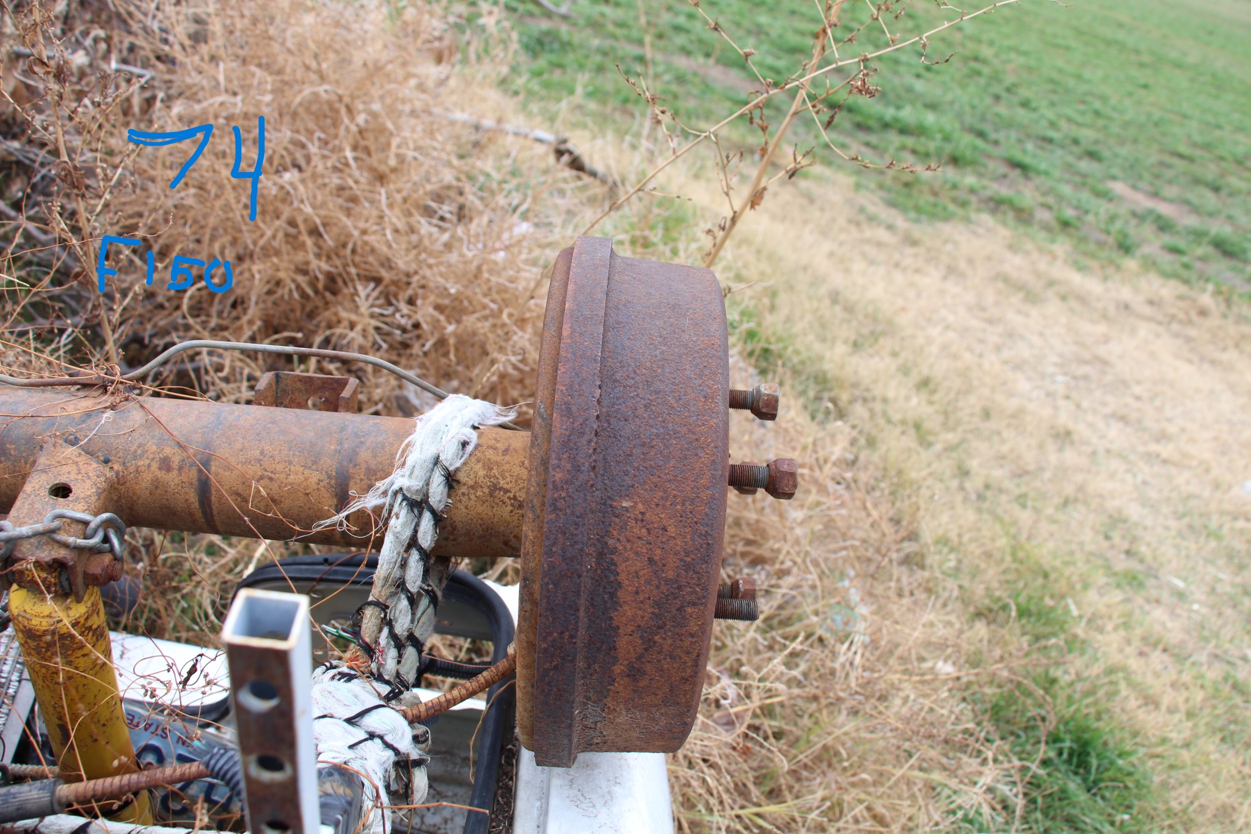

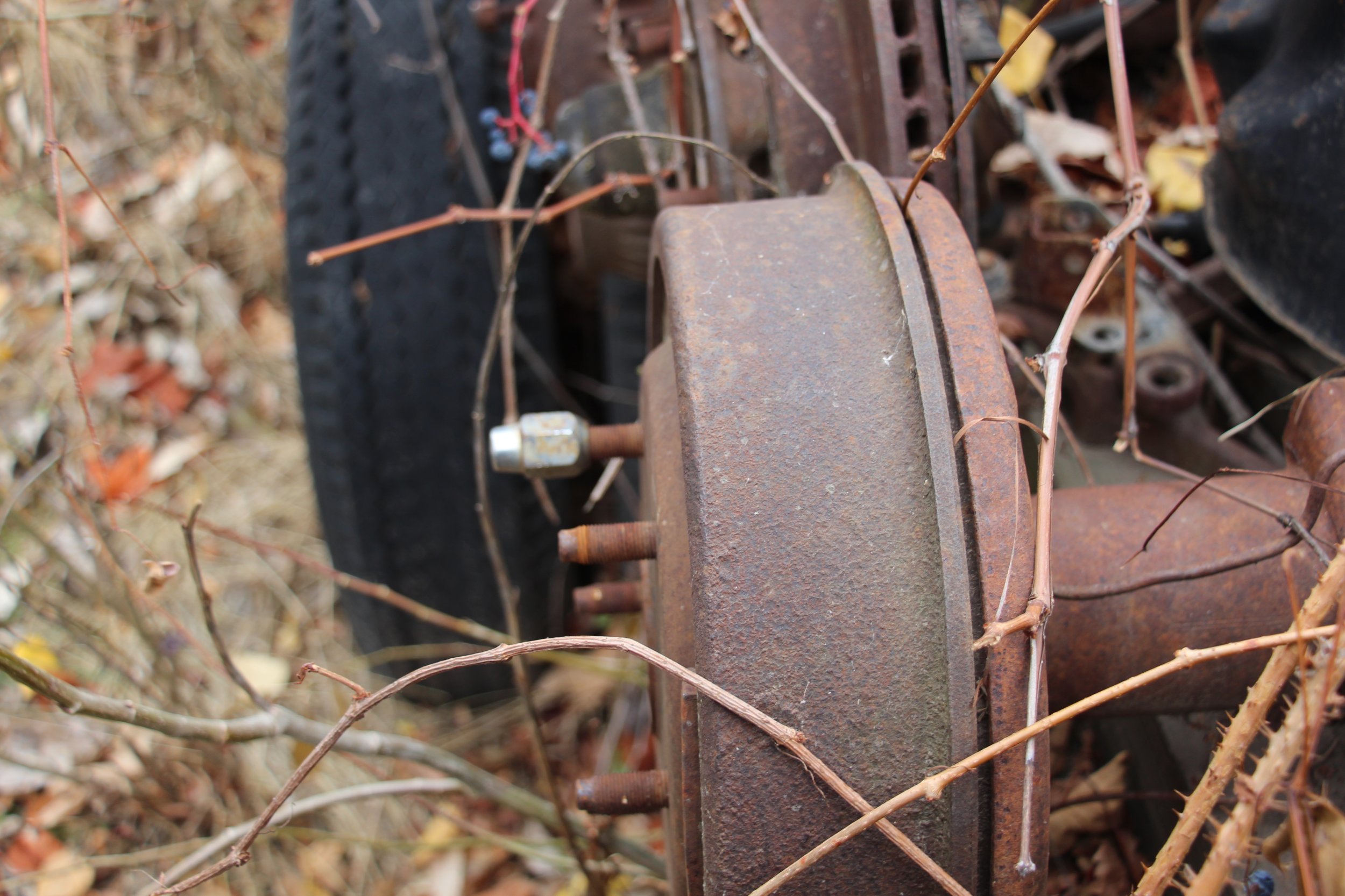

    I went out to take a shot of a drum surface but the one I could get off is too rusted. Looking at two F 150 nine inch rears I have they have different styles as one is like what you have and one has a raised piece and no flange to the outside of the backing plate. IMG_9215.JPG IMG_9216.JPG

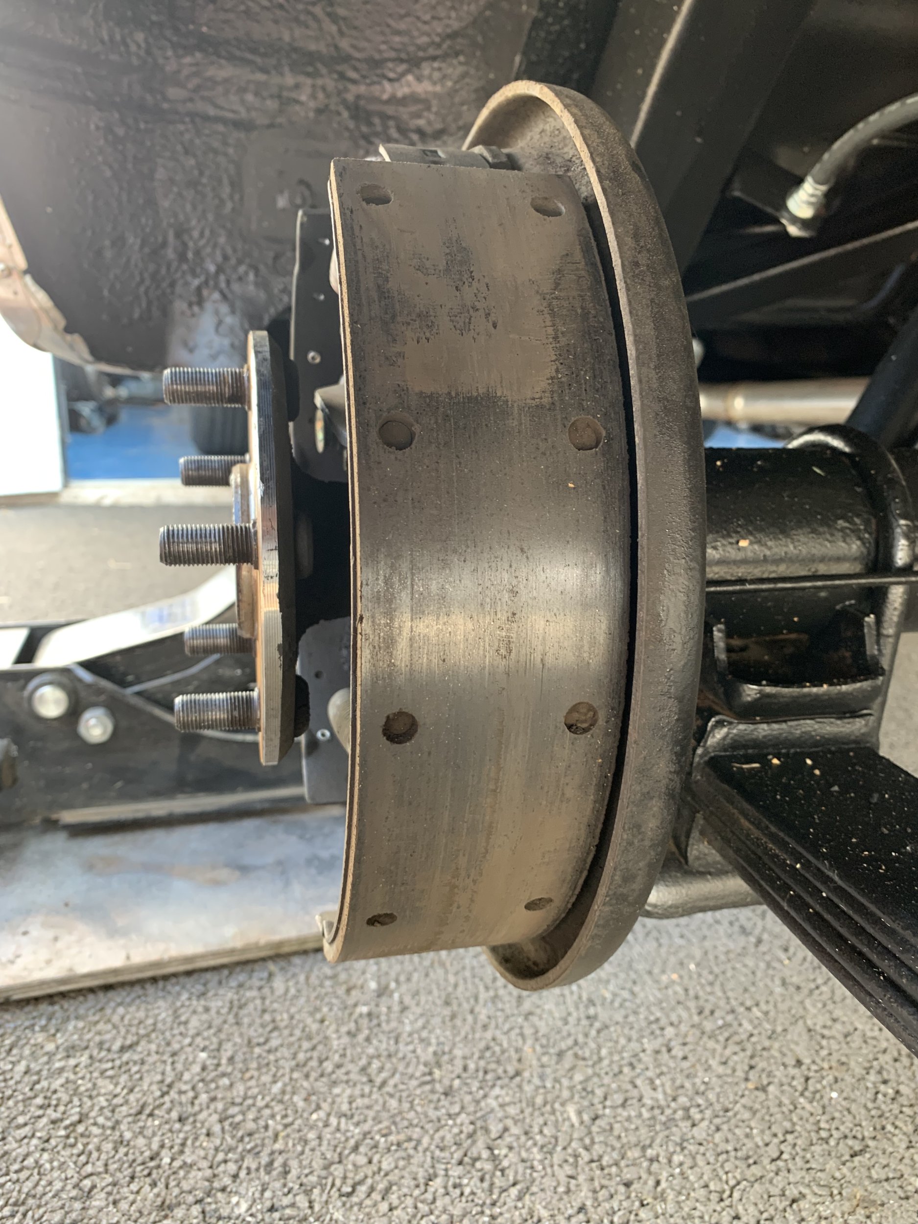

    Might be a bit late. This is the stock 9” rear on my ‘62. If you want any specific measurements I can get a wheel off tomorrow.

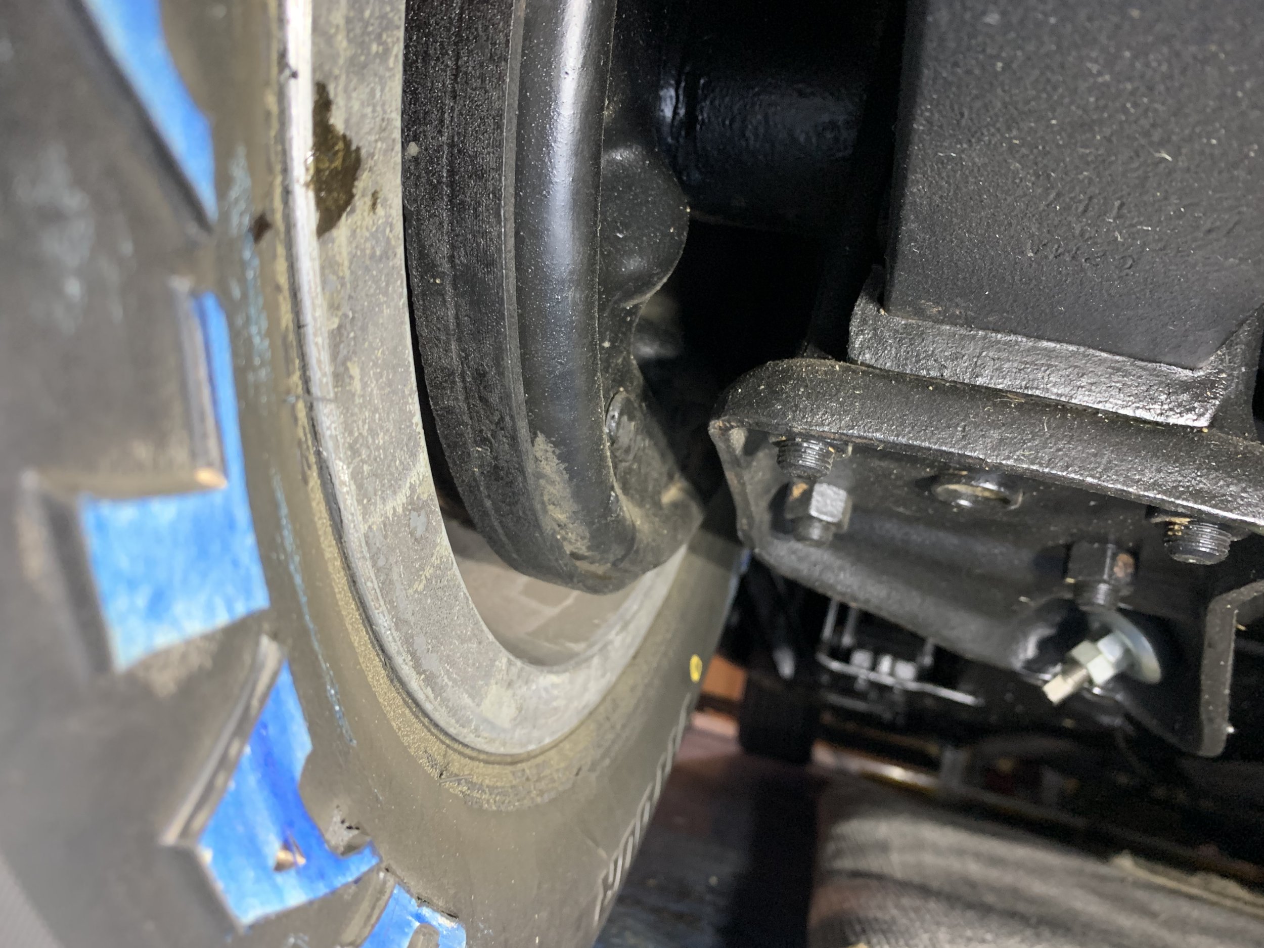

    anothercarguy likes this.

  23. Thanks for the offer of measurements @Oneball ...the ship however has already left the dock on this one. That said, your photo showing the axle flange offset does seem to show that the Versaille axles are pushed outward more than a typical drum brake rear axle.
    Thanks Rick, I appreciate the kind words.
