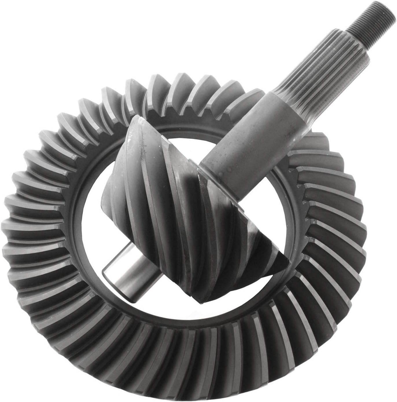

    i am trying to ***emble a 9 inch diff with mismatched ring and pinion. first, what is a starting point for the pinion depth and where is it measured. top of the gear teeth or the top of the part that goes into the bearing? i have looked at tools to do this and i figure it is measured from the center line of the bearing yes. second, when i torque the yoke down, with a crush spacer, there is a lot of play up and down of the pinion. so, i put in a solid spacer and with and without a .012 shim , like the books say, and it gets to tight. now the part i don't get is, the crush spacer is .504 and the solid is .429. how can the solid one get to tight but the crush spacer not tighten up at all?

    If you mean the pinion is from one gear set and the ring gear from another,chances are it will be noisy since they are run in as a matching pair at the factory. As for your preload,you haven’t crushed the spacer enough yet. The solid one needs shims added to it if it’s too tight.It may take a few times to get it right.

    As far as taking a pinion from a 2.75:1 gear set and using it with a ring gear from a 3.89:1 gear set, I've never seen it done and don't see how it could even get a decent mesh

    The tooth profile would be different.

    A mismatched gear set means that the two gears in the set don't match each other. At least that's what it means to all of us! If it means something else to you, then you probably shouldn't mention the mismatch part, you're just confusing everyone.
    As for pinion spacers...on a 9" if I use a crush sleeve, I put it in the press and crush it part of the way to get it started, then clamp the yoke in a big vise, and use a breaker bar with a pipe on it to tighten the nut until the end play mostly goes away. Then I start checking the preload torque with an inch pound torque wrench. I tighten the nut a small bit at a time (with the yoke back in the vise), and then take it out and check preload torque. After you do this a few times you can get a pretty good feel for how to do it, and it's a quick process.
    The solid spacer...you start with it too thick, then put it together and measure end play, then take out just a bit more shim than the end play was, put it together, check preload torque with the inch pound torque wrench, repeat until you get the preload torque right. Again, you'll get to be pretty quick at it after you do it a few times.
    Pinion depth on a 9" ford...I've never even attempted to measure. If you took the original gears out of a housing and pinion support, and you kept track of the pinion shim, and the gears were marked with a "+3" or something, and then you put in used gears that are also marked, you can probably get the right pinion shim the first try, by doing the math shown in the Ford shop manual. I just leave the shim in the housing that was there already, and put it together and adjust backlash and check pattern, then if it's off I adjust the pinion shim accordingly, and try again. Then when I'm happy I set the backlash/carrier bearing preload as the manual says, and check the pattern again.

    In my perception here, there would be two different cl***es of mismatched gears.
    The first wold be, for an example, a ring and a pinion, each from a different 3.73:1 gear set.
    The other would be a ring and a pinion from different ratio sets.
    427 sleeper and squirrel like this.
  28. gimpyshotrods
    Joined: May 20, 2009
    Posts: 24,586
    gimpyshotrods
    Let me see if I can level this out.
    It has been mentioned that "Good example- 3.00, 3.25, 3.55, and 4.33 each use a 39 tooth ring gear. The pinions are 13, 12, 11, and 9 respectively." *I did not check these numbers, but let's ***ume they are correct for example sake.
    If you look at the ring gear from each of these sets you will see that they are respectively marked:
    39-9
    39-11
    39-12
    39-13
    I believe that if you placed those ring gears in that same order across a table, and gave a quick look, you would quickly see why they are different.
    Since they all have the same tooth count on the ring gear, the ring gears all have the same inner and outer diameter, and the pinion location is in the same place on every 9-inch housing (that I know of),
    Those dimensions that I just called out dictate the profile of the teeth on the ring gear. So yes, they should be all the same on the ring gear.
    Now, you cannot put 9, 11,12, or 13 teeth of the same pitch around the same dimension cone section, and have them meet and mesh with the ring gear. In order to preserve tooth pitch of both the ring gear, and the pinion gear, something has to give.
    A 9-tooth pinion gear at the low extreme, and a 13-tooth pinion gear have two very different diameters.
    *These are a 3.00:1 and a 6.50:1 sets, respectively, to exaggerate the differences between dimensions.
    So what does actually give?
    The ring gear thickness.
    Since the Ford 9-inch carrier does not have a carrier ratio break, where the mounting flange on the carrier is in a different place for different ratio ranges, the ring gear has to be a different thickness for different ratios, to accommodate the differing diameter of the pinion gears.
    More teeth on the pinion, bigger cone diameters, thinner ring gear.
    Fewer teeth on the pinion, smaller cone diameters, thicker ring gear.
    It might, and it is a big might be able to turn the adjusters to shift the entire carrier with the ring gear on it to catch the teeth on a smaller pinion, or correspondingly move it away from a larger one.
    I do not see any way that one could get a proper, as-intended tooth engagement with a set that is mismatched by ratio. The teeth might catch, and it might go down the road, but it would be about as far from ideal as one could get, and still be moving.
    I have never even considered it, as that would anger the Gods of Speed, and it is not worth making the sacrifice for $180 for a new set.
