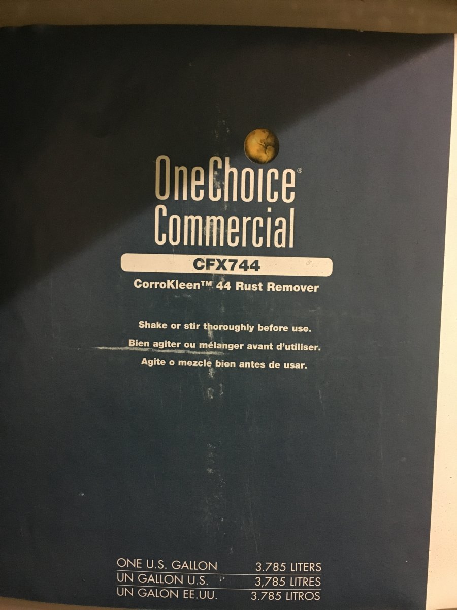

    image.jpeg This is what we use to remove rust and mil scale. Its like jelly so you can brush it on and rinse with soap and water. The thicker and longer left on the better the results. It dose have its down falls the bare metal will flash rust so you gotta get it dry and covered by oil or primer as soon as possible. And the price $50 a gallon.
