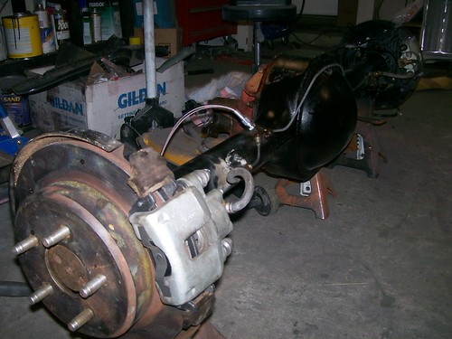

    I did a quick search and did not see anyone talking about the explorer rear brakes already. If someone has, sorry!
    I have done 4 cars so far with explorer rear disc brakes and have been very happy with them.
    I typed up some instructions for the folks at 57fordsforever.com but thought I would share them here as well since there are a lot of people on here with 9 inch rearends who could benefit.
    They sure beat the versaille brakes in ease of installation and one huge added bonus: the emergency brakes actually work well! That is important on a daily driven car with a manual ******.
    Here is an excerpt from that post:
    1. Take off old drum stuff including hard lines.
    2. Slot the explorer backing plates to bolt onto the rearend housing. Mine is a big bearing housing so I had to first drill out the holes to 1/2" and then slot them with a die grinder.
    3. For big bearing only: You have to cut the axle bearing retainer plate flat across the bottom to fit inside the emergency brake. This is no big deal since you have the axle out already. Just make the bottom match the top.
    4. You will need longer axle bolts. I just get new bolt 1 3/4" inch 1/2" bolts (for big bearing) and then ground one side flat to match the originals and used lock washers and nuts. I use the grade 8 stuff just to be safe.
    5. Bolt the axles back in
    6. Put the rotors and calipers on .
    7. Put the brake hoses on
    8. Dril and tap holes to bolt down the brake hoses.
    9. make hard lines from the original y
    10. Bleed the brakes
    11. Put wheels back and enjoy!
    Since then, I have also learned that the 8" is the exact same steps as the small bearing 9 inch.

    What did you use for caliper brackets?
  14. iamflashman
    Joined: May 11, 2007
    Posts: 145
    iamflashman
    The explorer backing plate is a single piece with caliper brackets. No welding required. You just bolt on the backing plate and that is it!

    iamflashman
    The bolt pattern on an explorer (8.8) housing end is the same as the torino style tube end.
    So, if you use the "torino" style tube ends, no modification is necessary.
    Since the rearends I am using are 57 Ford, the tube ends bolt pattern does not match exactly and requires some modification.

    George G
    So I went to my local Pick A Part today and found some '97 Explorers. I see what you mean about slotting the braket holes. The bracket holes measure about 3.5 inchs center to center and my nine inch bolt holes are about 3.25 inches.
    The explorer caliper is behind the axle and the Crown vic calipher is in front of the axle.
    So dumb question. how do you pull the rear axles???? I took off the rear cover from the diff. Then what?

    iamflashman
    on the 8.8? (from memory so if I missed something...)
    1. Remove calipers
    2. Remove rotors
    3. remove rear diff cover
    4. remove the little 5/16 (maybe 8mm) bolt that holds the pin in
    5. remove the pin
    6. push one axle in
    7. remove c-clip
    8. pull out axle
    9. push other axle in
    10. remove c-clip
    11. pull other axle out
    12. unbolt the backing plates from the explorer rearend (4 bolts per side with nuts)
    13. Just cut the emergency brake cable rather than try to remove it, those retainer ears are easy to break and not worth the h***le. Plus, you can reuse the ends.
    14. I also cut the brake hoses rather than try to undo them. I buy new ones just in case.
    Make sure to save all the pieces you can. the e-brake shoes are almost always shot but the hardware is usually still good and that will save you a few bucks.

    iamflashman
    Yep, you have to slot them about 1/8" for small bearing. Not much at all.
