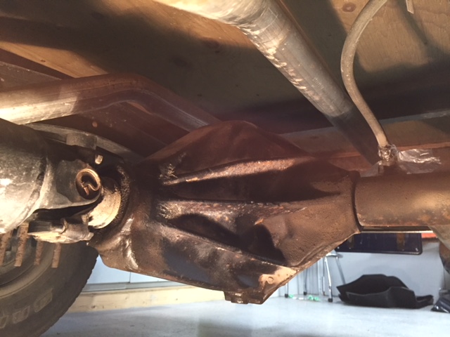

  1. IMG_0432.JPG IMG_0434.JPG 1948 merc truck ,flathead 8 ,3 speed on the floor, Rear end has 373 gears I need more highway friendly gears, I can get 354 for the original but that's it Like to keep original if I can, I do have a 9 inch with 308 gears I can use, Will my flathead carry this... this is my rear end now, I think its a dana 41

  25. the stamp on the axle tube says 373, I already have a 9 inch in my barn like new but it has 308 gears ,and yes that's to tall. so that's what I got ,like to use the 9 because if I change things up front I got the rear already covered , this is good guy im learning a lot
