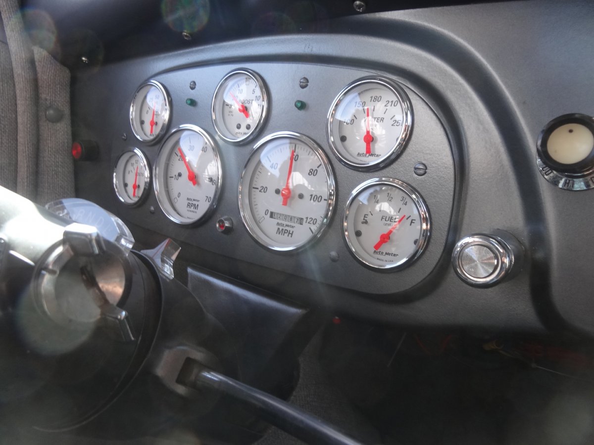

  12. roseville carl
    Joined: Dec 29, 2008
    Posts: 5,214
    roseville carl
    36P/U 3.00 .....28 in Dia tire
