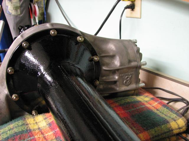

    Quite a while ago I built the traditional black coupe you see below and still have it. I put a 9" rear in it and have regretted ever since. It's practical as all hell but it just doesn't look right. I know it's not a '57 with the helmet rear cover, but even if it was, I'd still be apologizing for it. And if that car was a '32 3 window like yours, I would not have even considered using ANY 9".
    Highlander's right about lots of quickchanges out there...even lots of new ones, but there's not that many nice old Halibrand V-8's that I've seen.
    That's my vote for your coupe...oh, by the way, Dirty Old Man is right about that "Champ" quicky that Dave50 trying to sell ya. The V8 is smaller with only 10 bolts in the side bells. That's a pic of mine going in my next build. It was slipped into a '40 rear.
