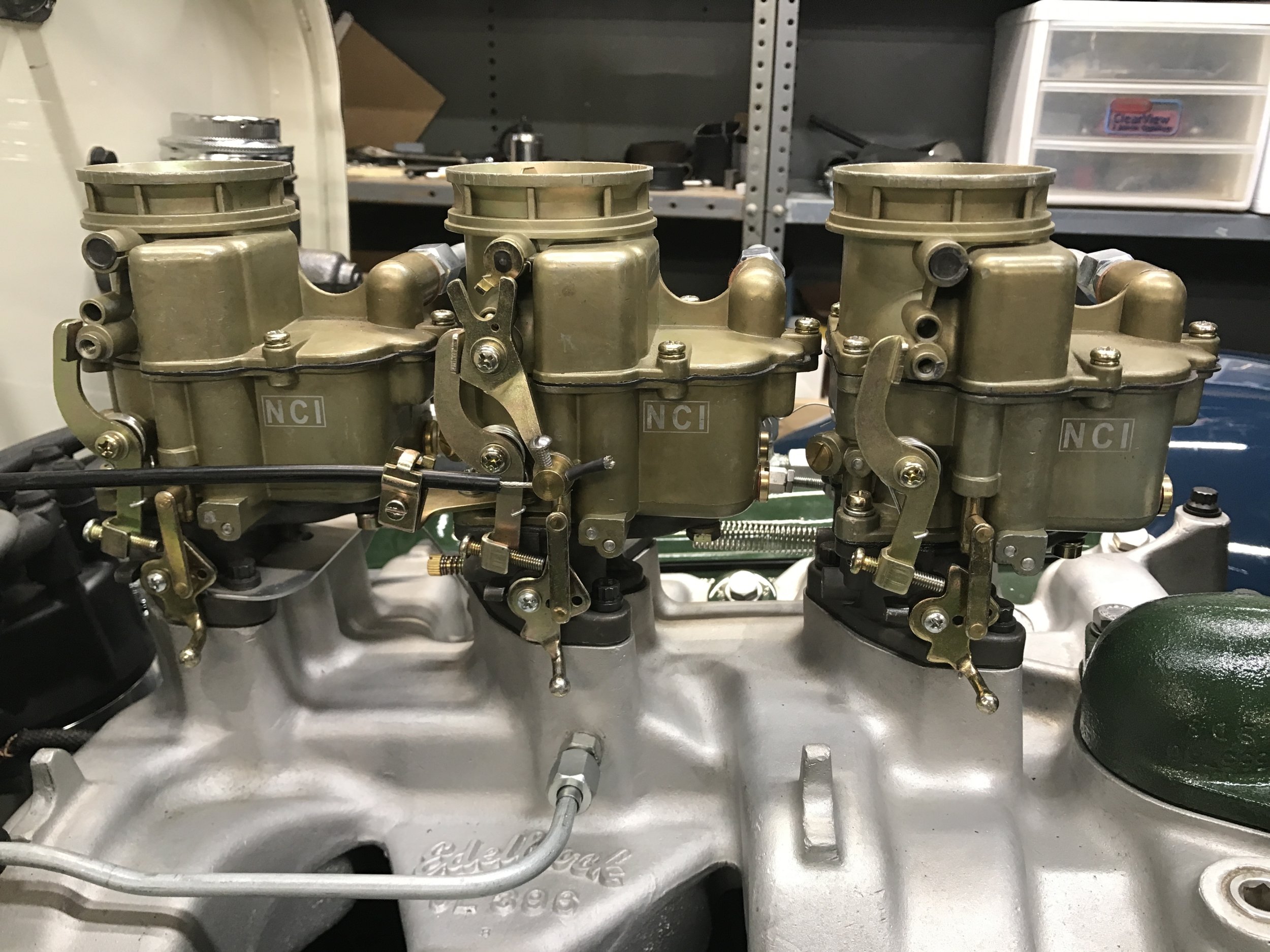

    I have an nci 94 tri power on 324 olds motor. The issue is leaking power valve on idle. I reduced fuel pressure to 2 lbs. checked float level and set it to 1 13/32” ( off of the edelbrock spec) and checked and replaced fuel seat, needle and gasket. Checked and realigned the throttle body ****erflies as they were a little off and causing them to stick. And finally changed the power valve and gasket. I did this in an orderly manner not just change stuff out. Idle mixture screws are set to 1 1/2 turns out. BTW this the primary. After doing all this and still showing gas from dripping from the Venturi cluster. While idling I placed my hand over the secondary carbs and can feel vacuum from them, is that normal? ( I’m thinking no). So I’ll probably pull the secondaries off and check the throttle bodies. Any thoughts? image.jpg image.jpg

  6. nochop
    Joined: Nov 13, 2005
    Posts: 4,653
    nochop
    from norcal

    I have been at the home of NoChop (OP) a couple of days this week helping with this issue so I would like to add my perspective. The issue is fuel dripping from the main discharge nozzles during idle resulting in a rich condition. We cannot reliably adjust the idle mixture and expect to get results until we clear this condition. We set the float level and drop. Replaced the needle and seat. No change. So we are looking at the power valve since it operates by allowing fuel into the main nozzles. The NCI carbs use standard Holley 6.5 power valves like you would see in a 4 barrel so we replaced it with another one (a new one from my stash). Not that we thought the diaphragm was leaking, but that the valve might be leaking fuel when it is not supposed to. No change. We did re-center the throttle valve in the bores because they did not seat correctly. My thinking was that maybe they are leaking enough vacuum to signal fuel from the mains, they close much tighter now but no change. The vacuum at idle is about 12". Thanks to Anthony for helping us understand that the secondary carbs are not supposed to leak vacuum at idle. The secondary carb issue is likely not related to the center carb idle problem, but it does explain why it idles at 850 with the center carb shut tighter than ever.
