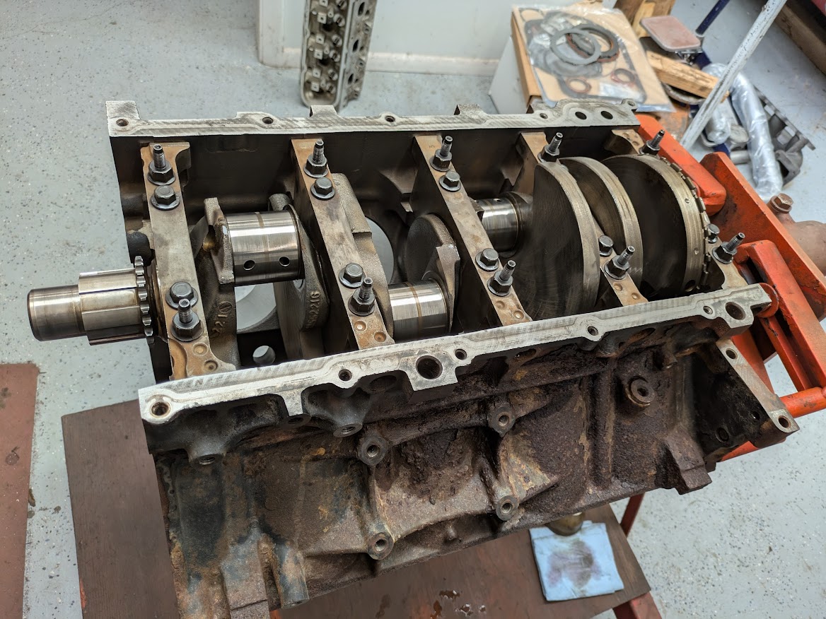

    I need to know, did you put new bearings in it?
    I'm not much of an engine builder so I would put bearings in just so it's one less thing I can get wrong.

    no, I put the same old bearings back in. They're about 1/2 used up.

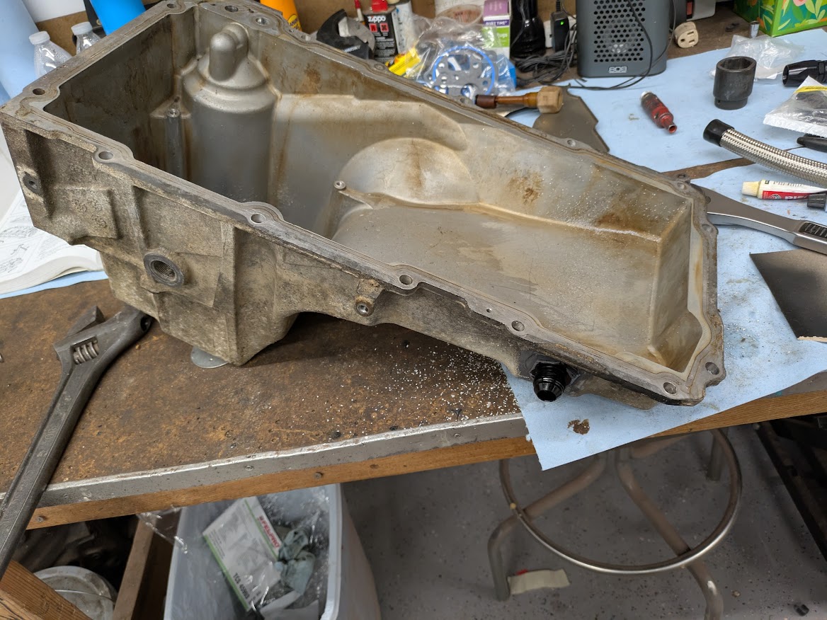

    Drilled a hole and installed a -10 fitting in the pan, for the turbo drain.

    Thanks for the bottom end shot. Now I can see why those LS´ can handle almost any amount of boost that´s thrown at them. With all those bolts in the main caps the crank just can´t go anywhere...
    Sharpone, 41 GMC K-18 and porkshop like this.

    yeah, it's pretty sturdy. Also the way it's sealed, is quite a departure from the old ways.
    and I get to tighten some of the bolts with an angle gauge. Learning new (to me) skills.
