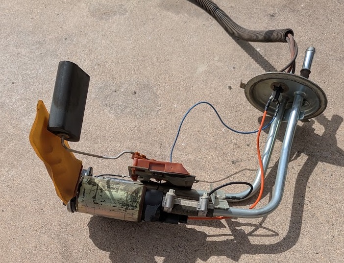

    Installed the new fuel pump. I decided to go with a 340 AEM. It's a bit longer than the stock pump, and came with a strainer that has an open bottom. Problem is installing it all the way down, so it fit the hanger and original lines, pushes the strainer against the bottom of the pan in the tank, choking it off. I ended up removing a brace, cutting the fuel line inside, and raising the pump up another 1/8" at the slide adjustment. I think it'll work. Also added the new fatter wire pigtail inside the tank.

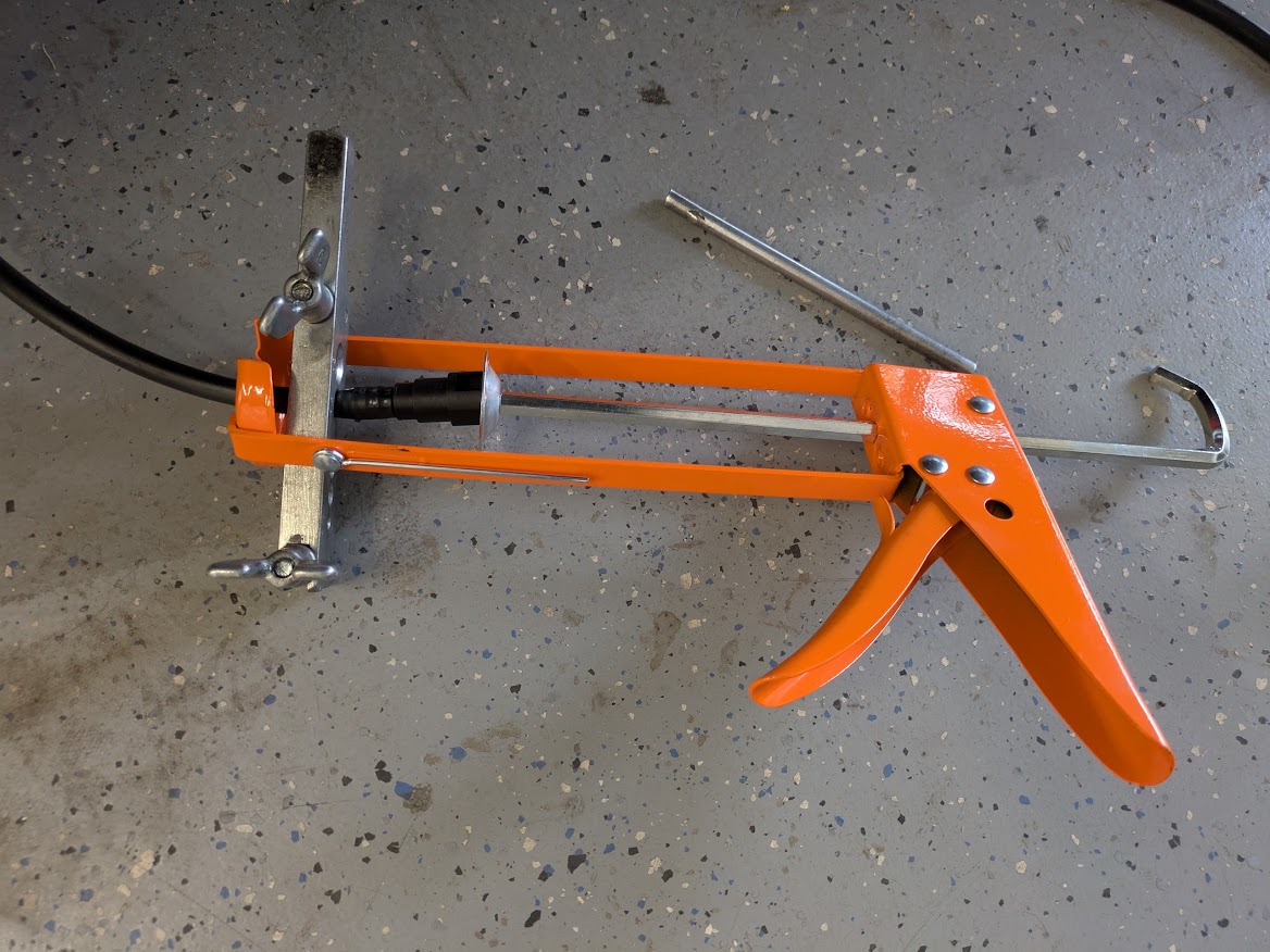

    the trick for making nylon fuel lines...
    Just Gary, dwollam, Rawrench and 12 others like this.

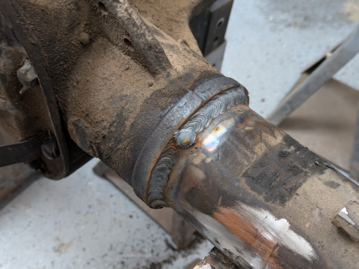

    Working on the rear end today...welded on the perches, welded the center to the tubes, working on the traction bar mounts now.
    Welding the tubes on is a fun adventure, there seem to be a lot of ways to do it. I picked the easy way...got it mostly clean, got it a little warm with a torch, turned up the heat on the MIG a ways, and made four quarter p***es in a row (weld 90 degrees, skip to the opposite side, then back to the end of the first weld, then the last quarter). I don't weld as art, I do it to hold metal parts together, so it's not pretty, but hopefully it's strong enough. And didn't get too bent out of shape.

    Weld looks good,
    I would think the tube was slipped into center section ,
    Did you weld just for
    insurance /strength?
    Or did you install the tube in center section then weld ? Because you shortened or centered ? If so mybe 2 plugs on each tube
    My experience with cast-iron to steel or cast to cast-iron ,after welding ,slowly decrease temperature over several hours to keep from cracking,
    I am No professional !!
    porkshop, 41 GMC K-18 and Sharpone like this.

  15. squirrel
    Joined: Sep 23, 2004
    Posts: 60,989
    squirrel
    There are a lot of rumors about 8.8 rear ends....the center is supposed to be cast steel. the tubes are pressed in, and a few rosettes, but the guys who go fast with them and do rock crawling with them have experience with them twisting. I saw it happen to a GM 10 bolt many years ago at the drag strip, the results are really ugly.
    You can tig weld it, you can preheat a lot, and control cooling, and you can stick weld it with nickel rod, there are all kinds of things guys do that are the "right" way. But there are also a lot of guys just mig welding them and they seem to hold up ok.
    dwollam, Rawrench, porkshop and 4 others like this.

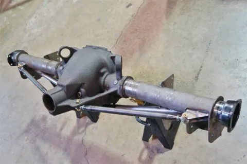

  19. squirrel
    Posts: 60,989
    squirrel

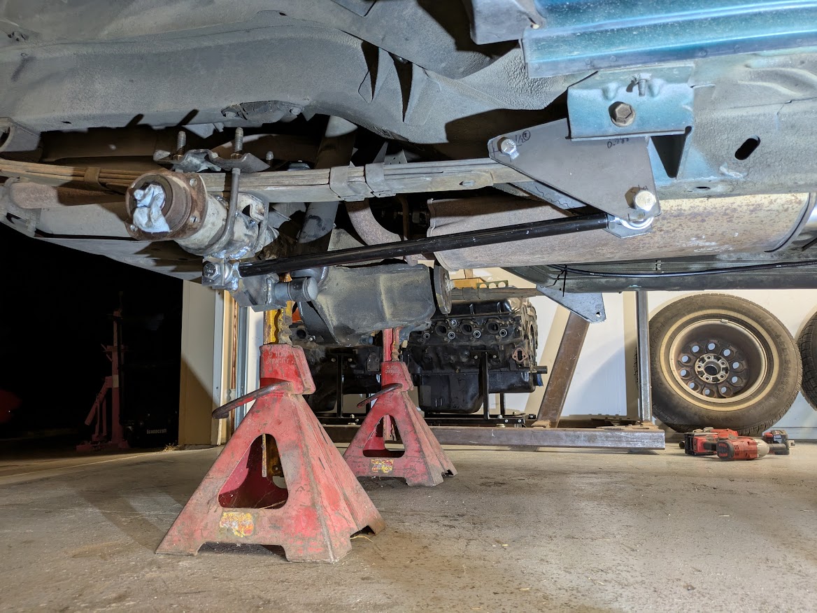

    I lucked out the Explorer and Cherokee have the same track width, within an inch. But the pinion is offset and puts the driveshaft at an angle side to side, and the rear yoke is right next to the original muffler, which I really want to keep.
    Got the rear in, no brakes or axles installed yet, but got the traction bars in place. Still need to make a few spacers to center the front joint between the plates.

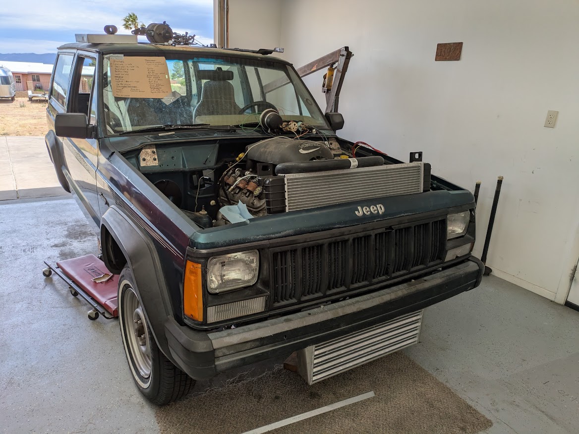

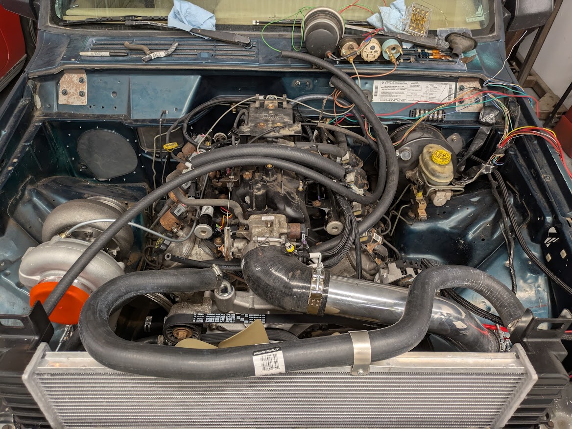

    Tinkering continues. The cooling system is almost done, I still need to mount the surge tank, which is going between the fender and brake master cylinder. I need to connect all those wires, there are really only about a dozen, it's not bad. I got the maxi fuse holder today for it. The firewall holes are all covered with sheet metal riveted in place. Transmission cooler in, rear brakes in and parking brakes working, I still need to finish mounting the hoses back there, and bleed the brakes. The EFI wiring is almost all connected.
    I need to make a shifter, put in a driveshaft, plumb the wastegate, install the blow off valve, build the exhaust that connects the stack to the old muffler/tail pipe, and a bunch of other little things.
    but it's making progress. In a functional, but ugly way :)

    Hey @squirrel
    Hey Jim, I know this is going to sound like a very stupid question, but I will ask it anyway!
    Is this going to be run/driven with out a hood?
    Or will there be some kind of unique, one of a kind, semi cobbled together, in a typical more than cool squirrel style unit, to protect all of your excellent fabrication and installation?

    No hood. It's all gonna hang out in the breeze.

    Gotta love that particular element of the Mighty "CHEEP" road warrior machine!
    I would ***ume the radiator and the lower unit, wont be adorned with any hardware cloth mesh stone guard's to try to protect those units from stray rocks and other "FOD" from out of the universe at large?
