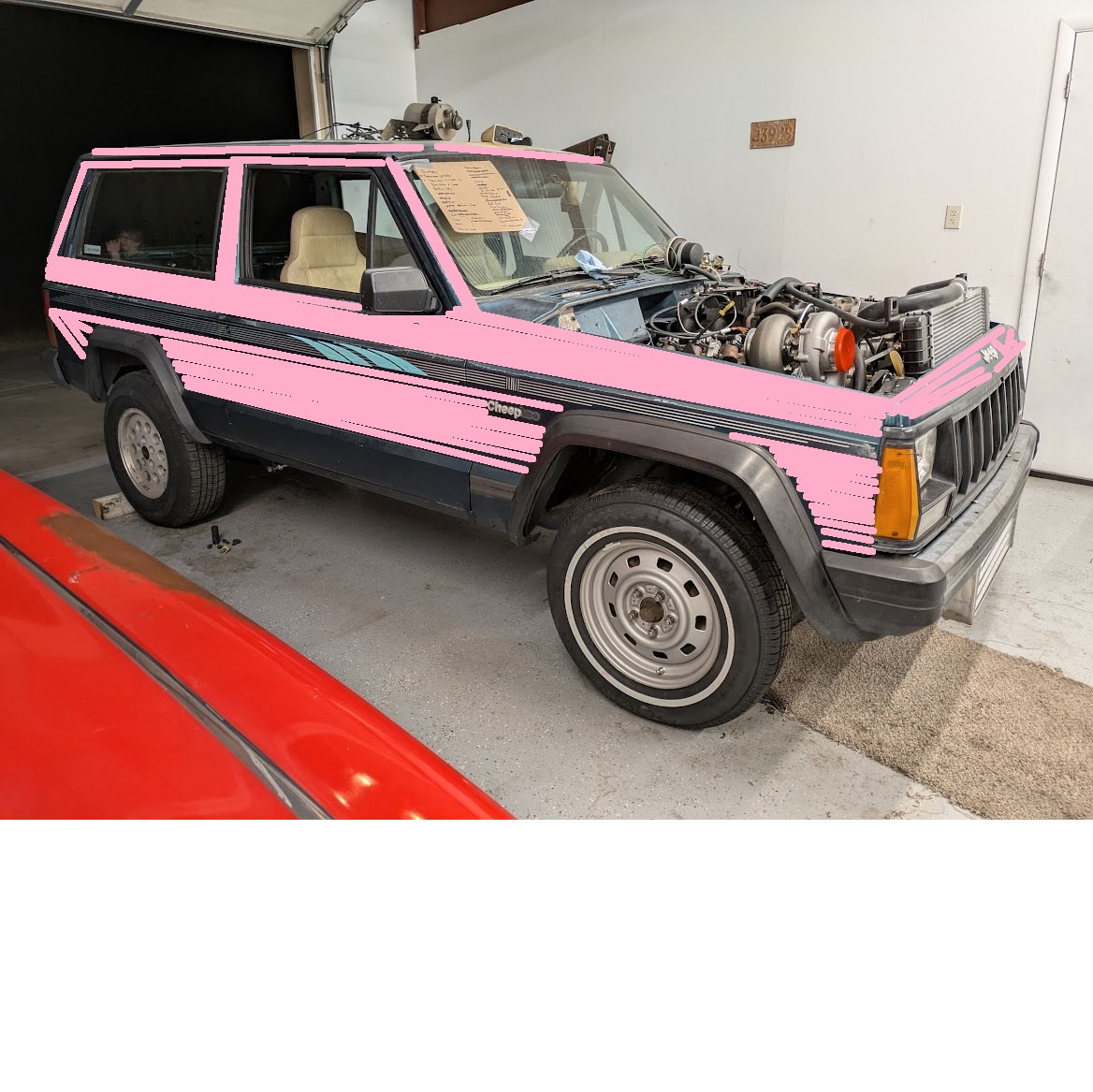

    I know what the goal is per the cl*** Cheep will be running in. However I’m having a hard time accepting this build vs your other 1/4 mile racers (never mind the Lemons, those are neat). Too “Road Kill” for me.
  2. squirrel
    Joined: Sep 23, 2004
    Posts: 60,992
    squirrel
    Since Roadkill is gone, someone has to take up the mantle!

    heh...I have a strict no paint/cosmetics policy with this one. But I am fixing the driver door so it closes, and the window will go up again, and even adding the extra bonus vent window that this base model didn't get.
    Oh....roof rack! but you had to be at the Duct Tape Drags to get it

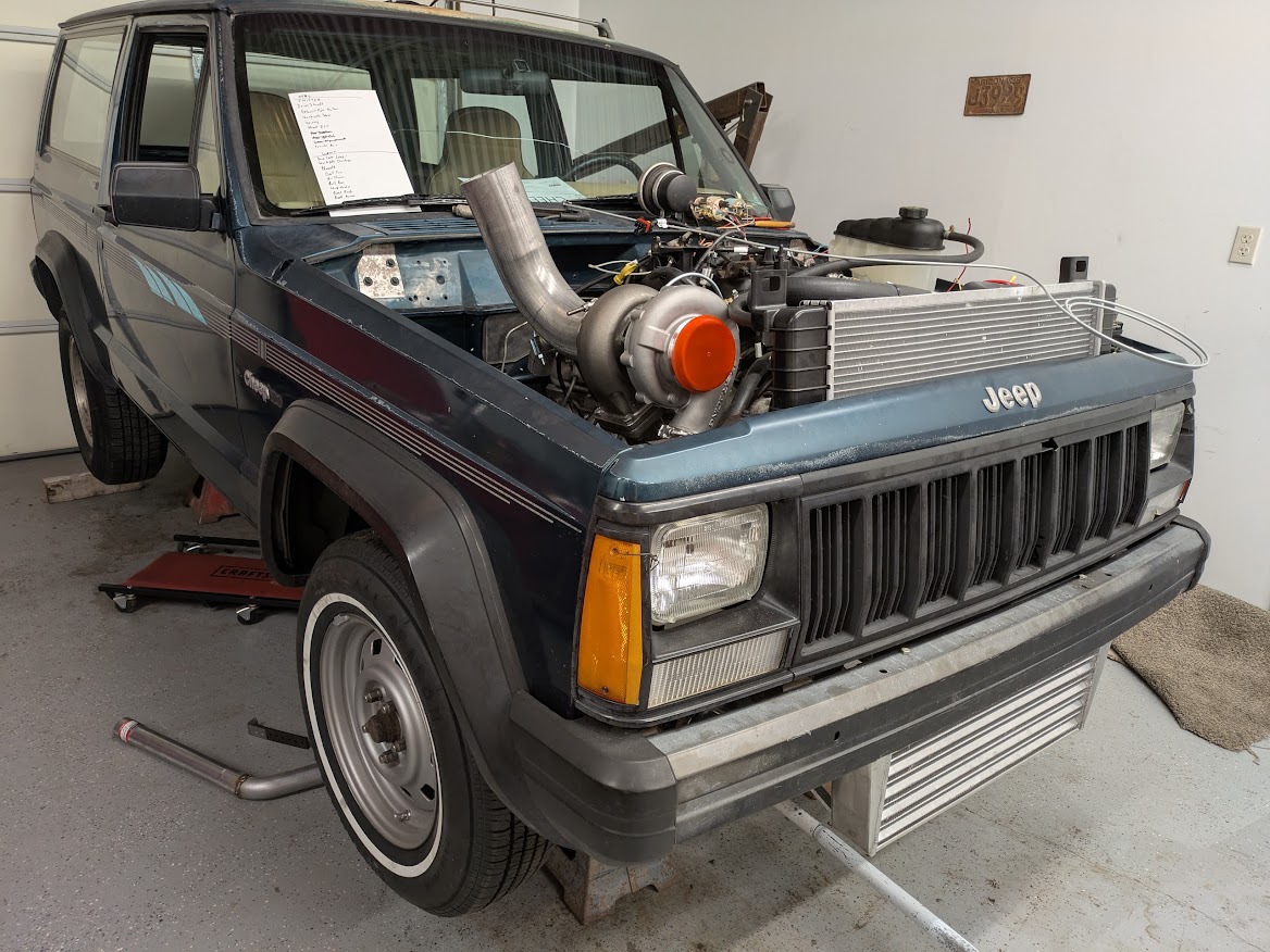

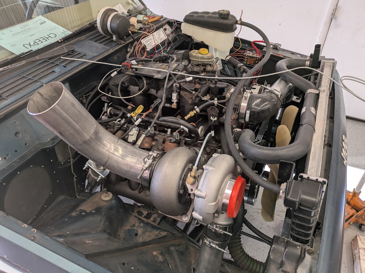

    Got the exhaust almost done, just have to put the down pipe back in and clamp it. And make the block off plate for the stack. The only other kind of time consuming fabrication project is building a shifter. Unless I can find one nearby for a reasonable price.
    it's looking rather ****y with the huge tall truck cooling system...but it might work?
    Got the brakes working, the wiring is about done, except for the computer stuff. There's water in the cooling system. Still need to test the fuel system for leaks.

    The Cheep looks great, the roof rack will fit it perfectly too. I think it needs a cow catcher like the old steam trains had, below that inter cooler!
    It should fit into the duct tape drag format really good, and be a bunch of fun.
    That was the goal, correct?

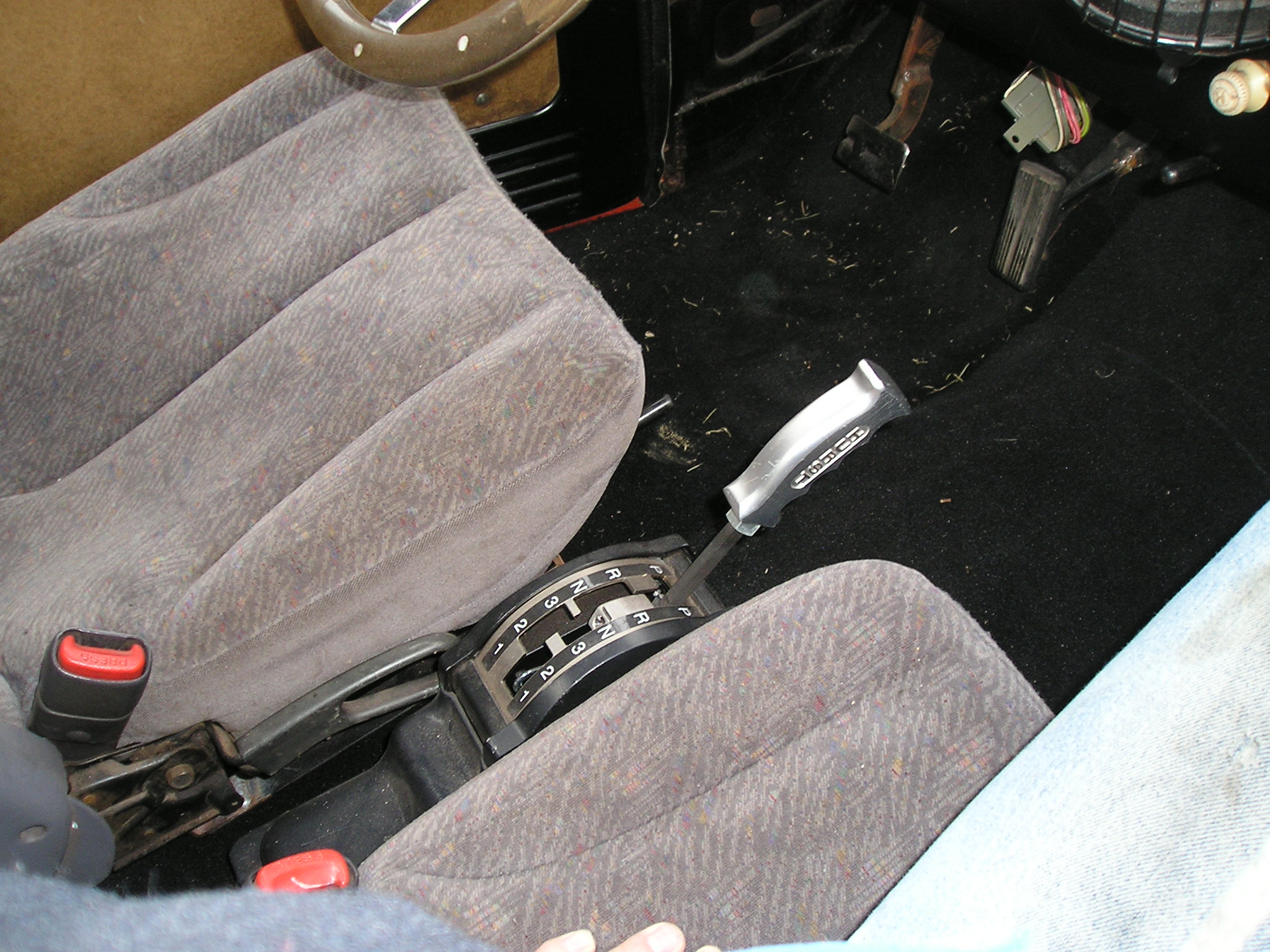

    I'm surprised there isn't a Jeep with floor auto shifter in a yard near you. That era 4.0 Jeep should have had a OD auto trans with a floor shifter that could be adapted to the GM trans.
  16. squirrel
    Posts: 60,992
    squirrel

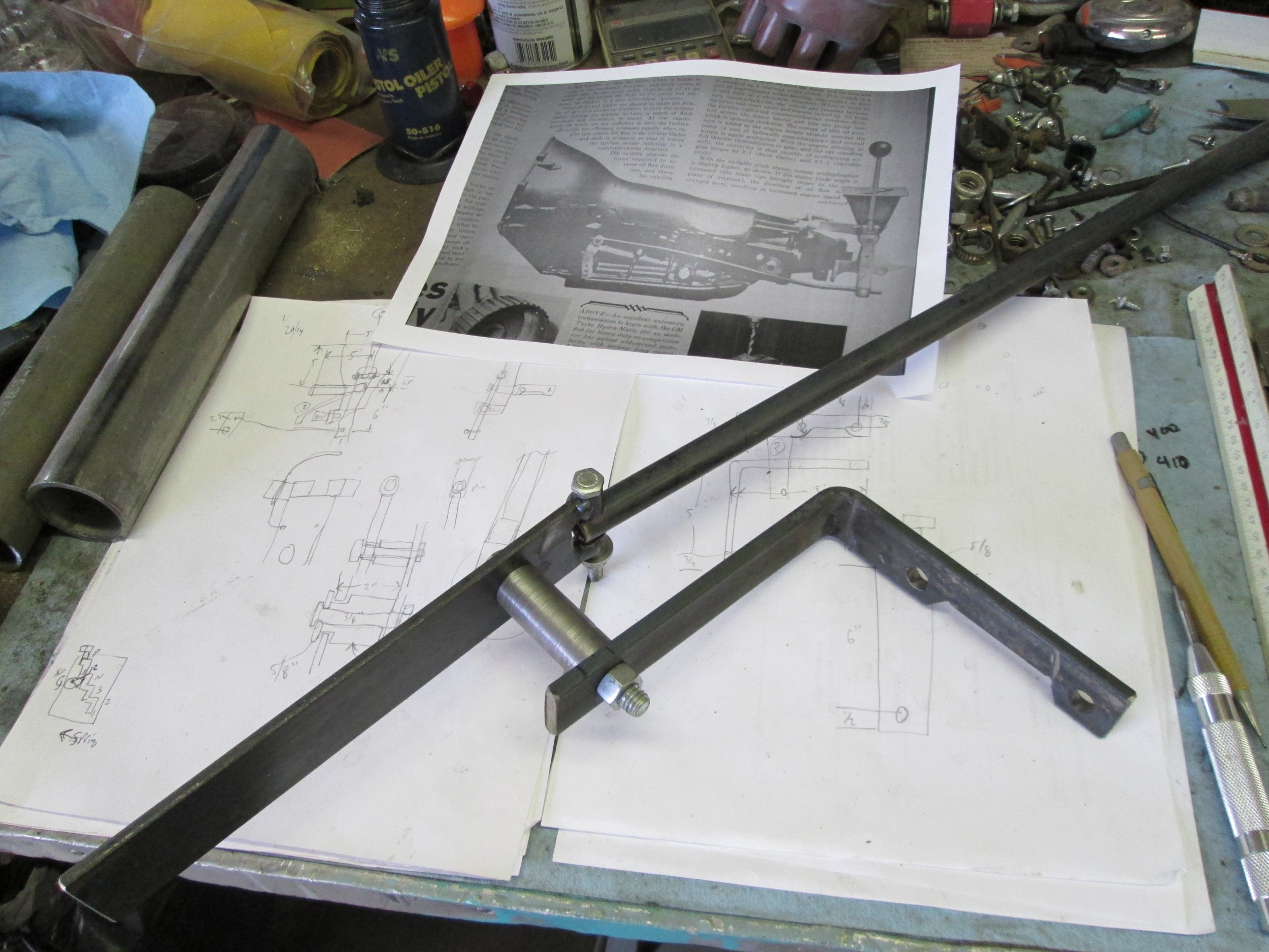

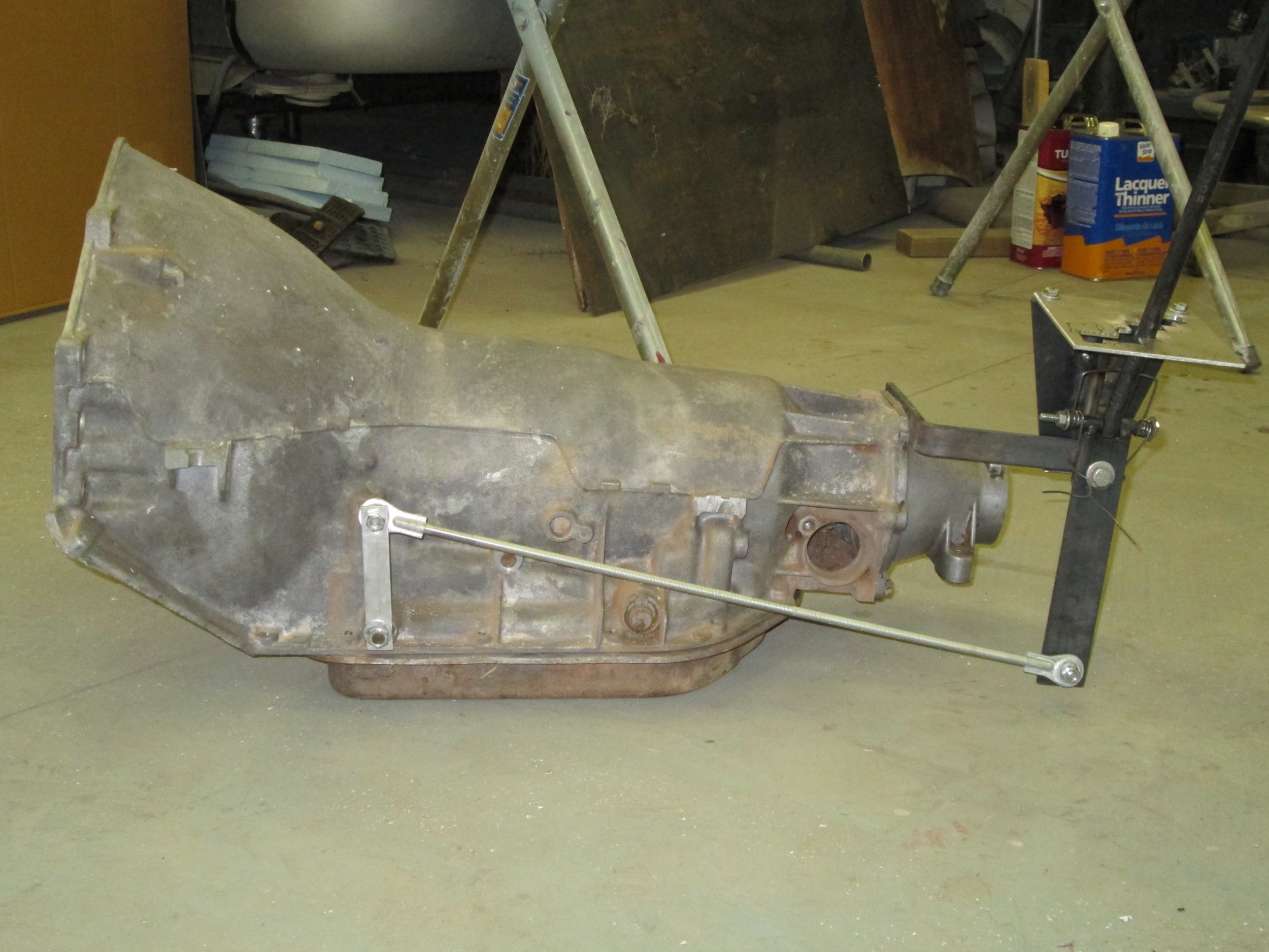

    I got most of a floor shifter from a Cherokee at the junkyard, but I haven't really looked at it to see if I can make it work for me. It's a cable shifter, but didn't have the cable, so I have to get one and adapt it to the transmission (which I should be able to do). But the plastic rod inside the lever is broken off at the top, and the handle was off and looks kind of beat up.
    I was planning to modify the transfer case shifter to work like the shifter I made for Plan II. I think I could probably do it in a few hours, just need to get my brain back in gear.... (never miss the opportunity for a pun)
    I could also do some research and see what other shifters were used in cars that I might find at the local junkyard Monday, and that could be adapted.
    although making it work for racing can be a challenge...I need to be able to bang it into 2nd and 3rd, without going into the next gear, or neutral. That's why making one with a zigzag gate is probably what I'll end up doing.

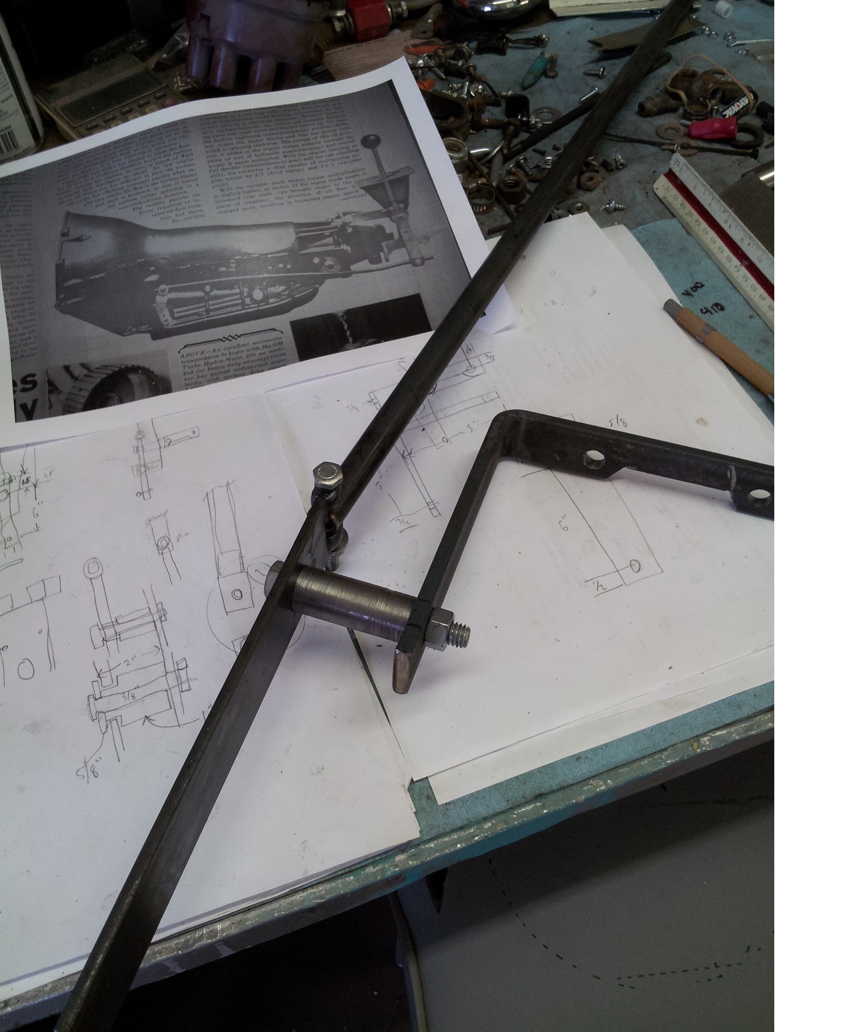

    sample pictures of the Plan II shifter, as I built it:
    NoSurf, Thor1, dwollam and 12 others like this.

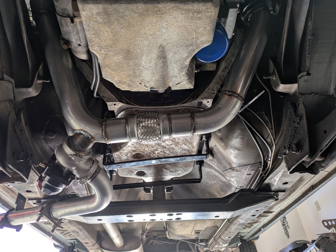

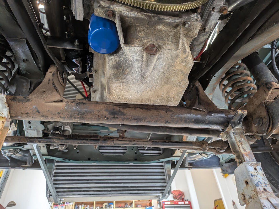

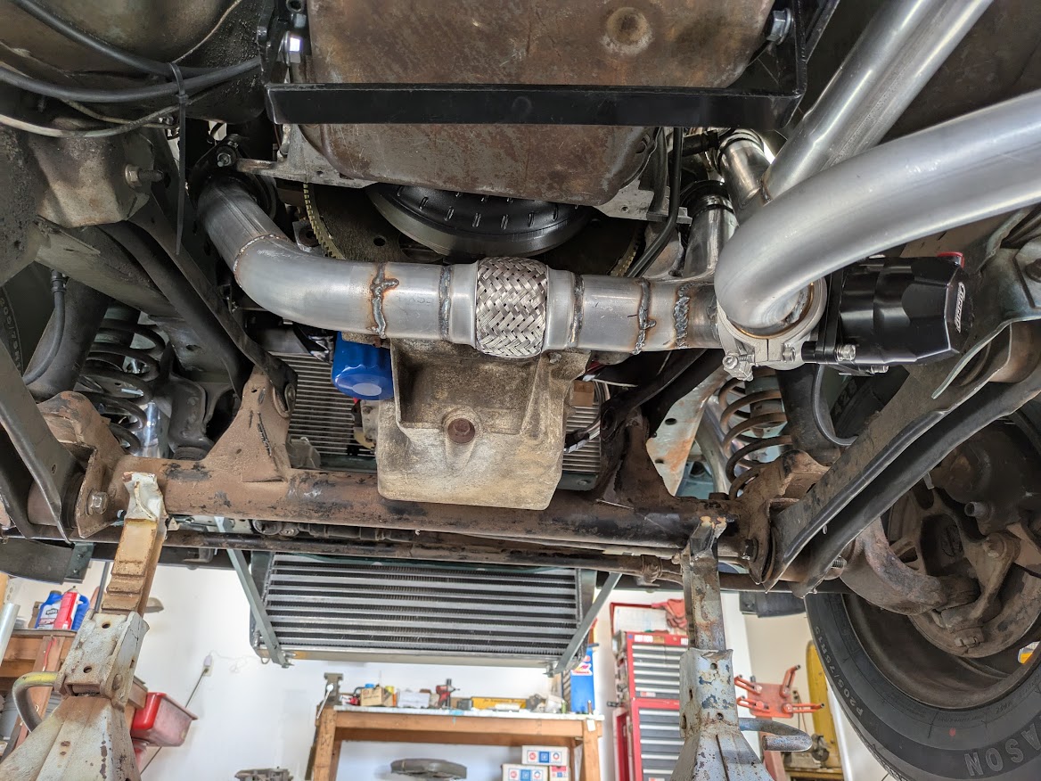

    a few pictures of the underside, so you can see what's going on. No shifter or driveshaft yet, need to get some more hangers on the exhaust pipe. A few more wires/lines to connect on the engine.
    swap14.jpg todo02.jpg swap15.jpg swap16.jpg swap17.jpg swap18.jpg swap19.jpg swap20.jpg swap21.jpg swap22.jpg swap23.jpg swap24.jpg
    Thor1, dwollam, Rawrench and 11 others like this.
  21. Driveshaft to muffler looks like it will be tight
    41 GMC K-18 and Sharpone like this.
  22. squirrel
    Posts: 60,992
    squirrel
    yeah, if it's a problem I'll get a smaller muffler. We'll see.

    The wastegate is now plumbed, and the exhaust hung so it feels like it won't rattle.
    I spent a while on the shifter, it's working but still needs the gate, lockout, and NSS. But that can all happen with the car back on the ground, so I'm going to swipe the driveshaft out of the truck, see if it fits, and if so get it in and set the car back down, and finish up the wiring.

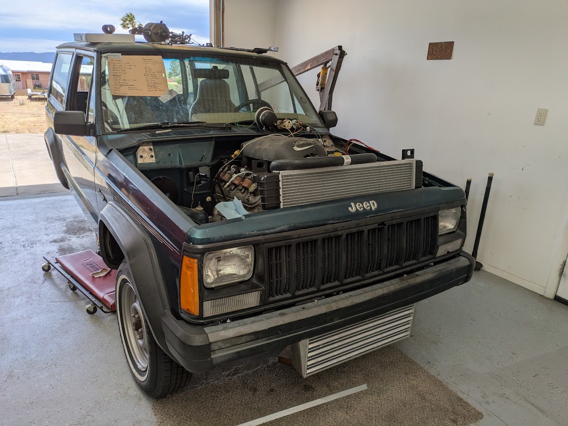

    Anyways, got it all wired up and running, and went for a little drive. One of the sensors is wrong, making it run rich, so I'll try to fix that tomorrow. But it does run, transmission works, brakes work, posi traction works, etc. It's a blast to drive! and gives my kid something like a video game to play on the laptop...
    have a little oil leak at the adapter where the oil cooler went, the plug I removed and reinstalled needs a new seal, and also the transmission cooler lines are leaking, I don't think I got them tight enough..and exhaust pipes are kind of in the way now. I'll try again in the morning when it's cool.
