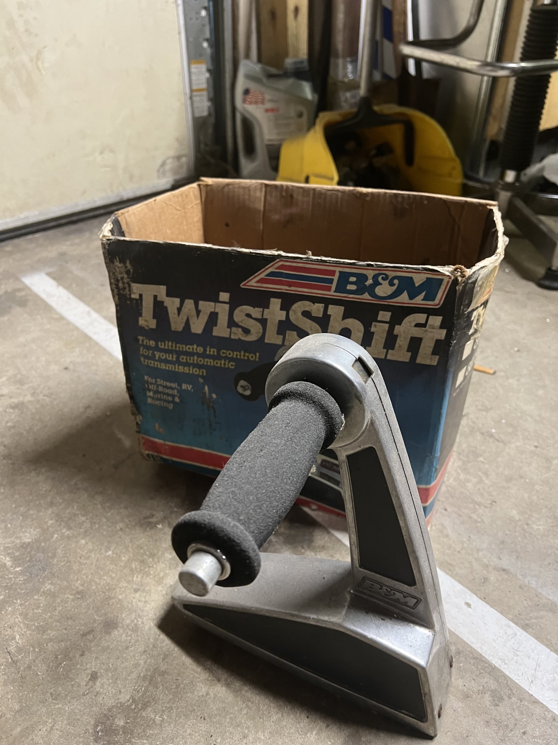

    My racing partner had what he called a "can of cures". He had a few of them. Things removed from junk cars, shifters. Automatic and stick. Clutch linkage, brake and clutch pedals, linkages, etc.
    We outfitted a few stock cars with shifters from that jumble of junk.

  4. 19Eddy30
    Joined: Mar 27, 2011
    Posts: 5,150
    19Eddy30
    from VA
    @gene-koning , my self had one of those
    Winters a few year after on market ,
    It lasted only week or so after loosing a race because I forgot to slap over for gear change ,
    Over years there been so many shifter made in 80s up by Hurst ,B&M with ratcheting ,springs Ext that are just
    Gimmicks, Lot of play, Loose & long gates. Same with Stick ,
    I have a hand full of Hurst 1/4 sticks
    Front & rear exit on cable , whats Nice about 1/4 stick , there is a tab part that can be removed for Glide on 3 speed use, B&M Pro Bandit nice for tight fit , contact air / electric shift & nice for Dragster &well built , I also have a Precision shifter , over 25 years old ,
    Well built may be 3/4 wide or less ,it can be set up for may trains Option
    2-4 speeds , handle can be flip forward / Reverse , same with cable , air /electric.
    One a complaint about is P-R , I need to change gates to my liking ,
    Another on from Australia early 2000s Lowee or something like that , simple well built ,
    I try to set shifter up so No reaching ,less effort in arm movement,
    Same with chute Lever /deployment,
    I see so many Racers Reaching & Searching For when Needed ,same for Fire Suppressions,
    @squirrel this could of been installed ?
    & when coming to Tunning @ initial start up & so on , are you doing your self or another ?
    1Nimrod, Deuces, swade41 and 2 others like this.
  5. DDDenny
    Posts: 23,425
    I gotta admit, I've never seen one of those shifters before, don't even recall seeing them advertised in magazines, not a good design though for those with carpal tunnel syndrome.
  6. squirrel
    Joined: Sep 23, 2004
    Posts: 60,992
    squirrel
    that's a wild shifter!
    I'm about 3/4 done with my shifter, so I'll just finish it and not try to use something else.
    So far my and my kid are doing the tuning, learning the basics right now. How to sync files, set up the sensors, how the IAC works, we're looking at timing now, we got the data logging going so we can see what the numbers look like under different conditions, etc. Lots to learn! but having a lot of experience with engines and a little with fuel injection, we're starting to understand it.
    What's the first destination when you get something on the road?

  9. 19Eddy30
    Posts: 5,150
    19Eddy30
    from VA
    @DDDenny , now curious I will have to look at the box to see if there's a date on it, off my head thinking 85ish ?
    @squirrel , I was just giving my Opinion on shifters, my self I have made a few & modified,,
    Just letting others know try to stay with simple workings ,& Quality.

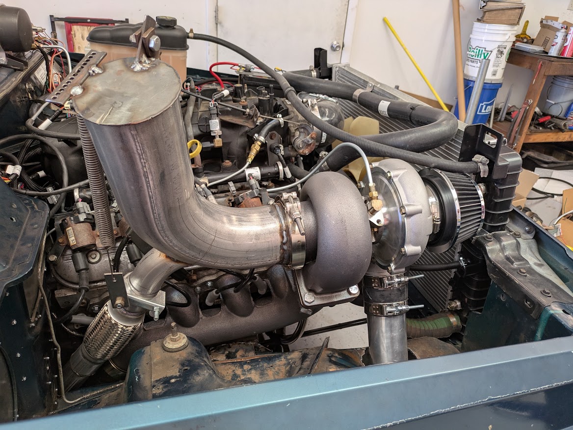

    That exhaust would get you arrested in Australia!

    Is that a flapper cap on the end of the exhaust pipe ?

    The exhaust is still a work in progress, I'm trying to make an "automatic cutout" that will route exhaust out the tailpipe until it's making more than cruising power...then let it out the stack. First trying free things, then maybe I'll end up with a boost actuated or electric or cable operated one.
    We can get away with some crazy stuff here.

    I run a Precision shifter in my FED. They are a very nicely made product.
    Could the Aussie shifter be made by Ken Lowe? He is a US drag racer who moved Down Under many years ago, still does a lot of racing parts.

    Went to the dump (to get rid of garbage) and weighed Cheep...right at 2900 empty. Not too bad.
    I think the exhaust is going to work OK like this...and the flap can be quickly removed for racing, if wanted. It stays closed until the throttle opens a ways, then it just opens a bit. Not very loud, but you can hear it. Oh, kid found an air cleaner when we were at the parts store this morning. I think that will work fine and also easily removed for racing.
    People keep telling me the intercooler is too low. But it's not as low as this guy's!

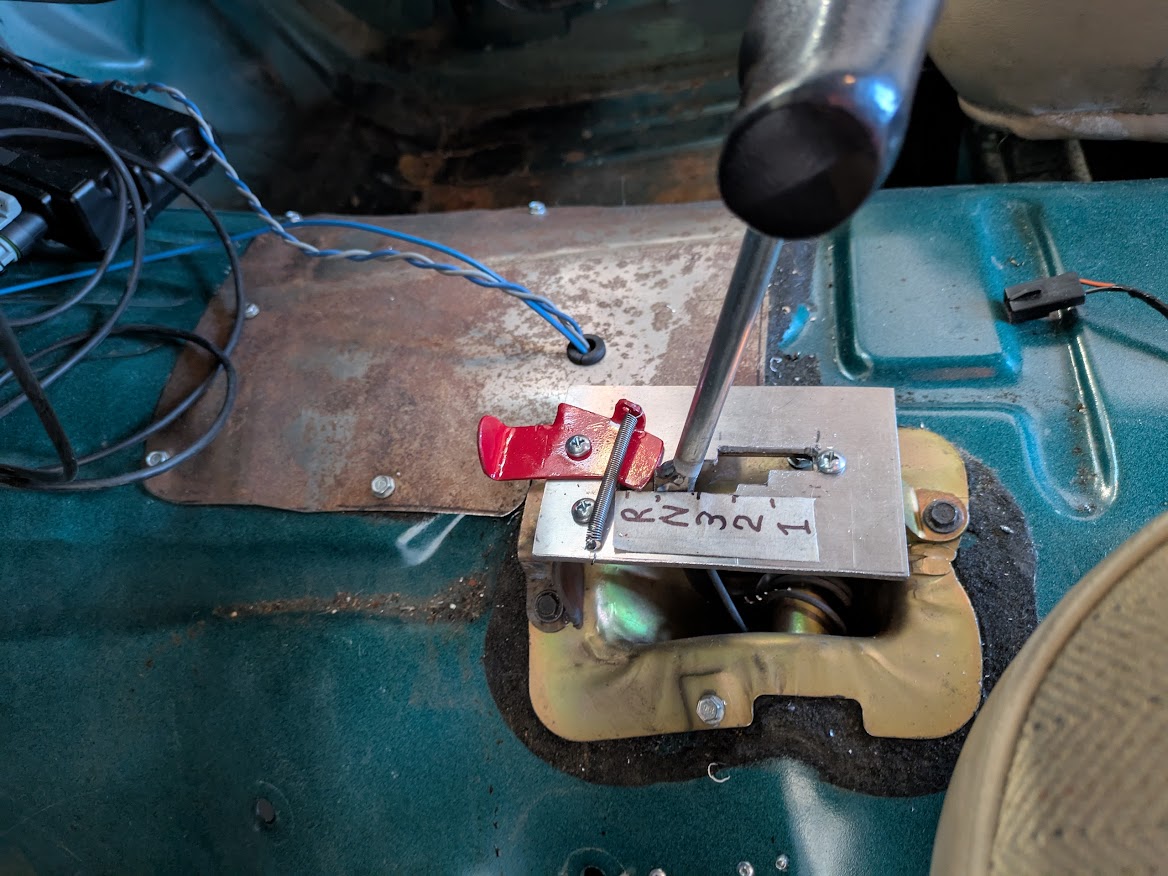

    I finished the shifter, it has a reverse lockout now. The Neutral switch is underneath the floor, acting on the bottom of the shift lever.

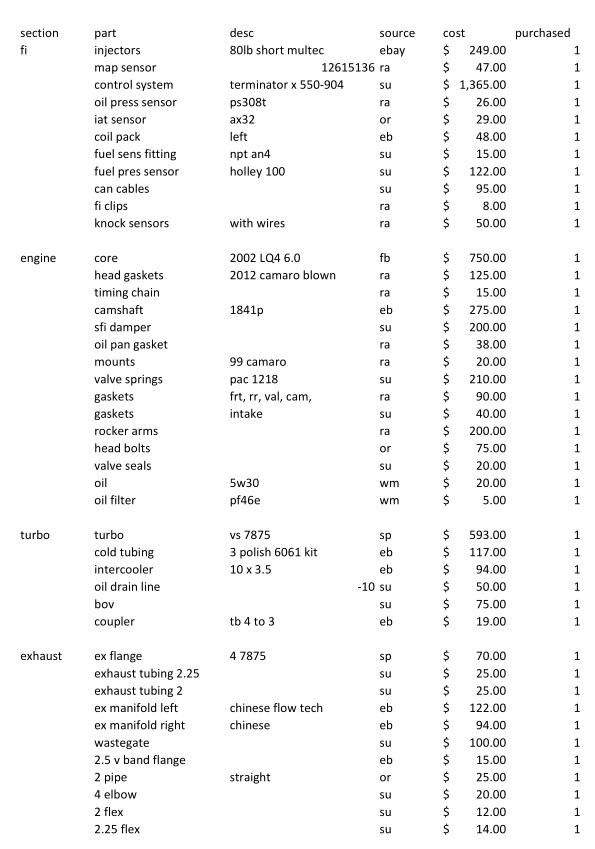

  25. squirrel
    Posts: 60,992
    squirrel
    I also hope it doesn't land hard!
    Trying to keep the part purchases and fabrication to only what's necessary...but my idea of necessary is of course different from everyone elses! I'm even getting a new windshield tomorrow, since it has a crack all the way across, and things like that make the cops want to stop you if you're driving an obnoxious hot rod.
    Oh, I'm going through all the receipts, since I think I have just about everything bought. Looks like I probably won't make it under the $9k goal, but won't miss it by much.
    There's a weird "beyond 1320" event at the drat strip in Tucson this weekend, I might try to go up there and see what happens. Just to get my feet wet, as it were.
    There's also a Friday night drags at Firebird (about 180 miles away) on the 30th, which I should probably try to go to, since drag strips kind of shut down for the summer here, because it's too damn hot.
    Thor1, porkshop, 41 GMC K-18 and 8 others like this.

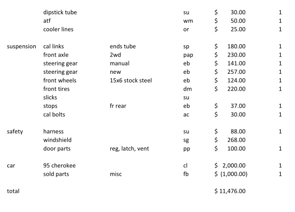

  26. squirrel
    Posts: 60,992
    squirrel

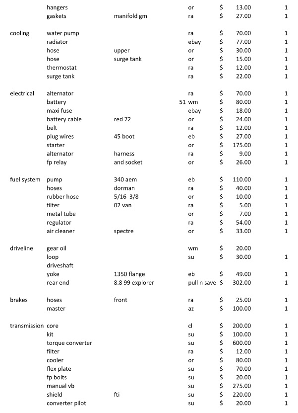

    actually the cost is pretty close...but it also hasn't gone fast yet, so the goal isn't quite met :)

  29. RodStRace
    Joined: Dec 7, 2007
    Posts: 10,875
    RodStRace
    oil and filter 25
    ATF 50
    gear oil 20
    harness 88
    windshield 268
    No coolant listed
    Fluids and safety.
    These are costs but usually not applied to the budget for these things, I'd guess, at least that's how gr***roots does it.
    You might even be able to ignore brakes (125) and suspension for the same reason.
    Just like the roll bar (TBD), shaft loop (30), SFI damper (220) and trans shield (220)?
    Also, I don't see the cheap electrical fuse panels on post 371.
    Nice detailed price list, but you knew we would be checking the math, right? :D
    As for the hood, You could do the roadkill thing and leave it uncut but strapped to the roof rack! Adjustable spoiler! :)
