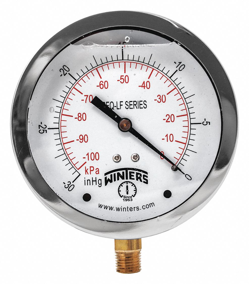

    @gene-koning and others, this is a basic outline of what you are looking at. I am not an EFI tuner, but have looked at a few of these.
    Across the bottom is engine RPM. Simple, idle (500) to the left, up to 7000 RPM on the right.
    The left side is Manifold Absolute Pressure in kilopascals. What most old school recognize as vacuum in In.hg. It's actually low pressure, not vacuum.
    To convert kilopascals to inches of mercury (inHg)
    1 kilopascal (kPa) = 0.29529983071445 inches of mercury (inHg).
    That's going to mess with your head, but that's the numbers.
    Here's a pic worth a thousand words.
    Zero is atmospheric pressure. -29.5 inHg. or -100 kPa is total vacuum or no pressure.
    So typical near stock engines develop around 18 inHg. at idle, no load. That's around -60 kPa.
    Look at the chart Jim posted. 500 and 600 RPM haven't changed. This probably means it's not idling that low. But look at 700. the red cells are all way under 50% VE from -42 to -70.
    Think about an engine idling at 700 RPM with a light load or big cam developing 13 inHG. to snapping the throttle closed (high vacuum) up to a bit over 20 inHg. That engine is CHOKED OFF, not efficiently pumping the air. So Volumetric Efficiency (VE) is low.
    The computer can do a basic calculation of 5.7L engine turning 700 RPM = this much air, but it needs to know how much the exact engine, the throttle and exhaust all affect this calculation. So it knows it's not 100% efficient, but needs a percentage for each amount of RPM and use the MAP sensor to judge load.
    That will allow it to calculate the actual amount of air entering, and using that Air volume to calculate the Fuel needed for proper Air/Fuel Ratio.
