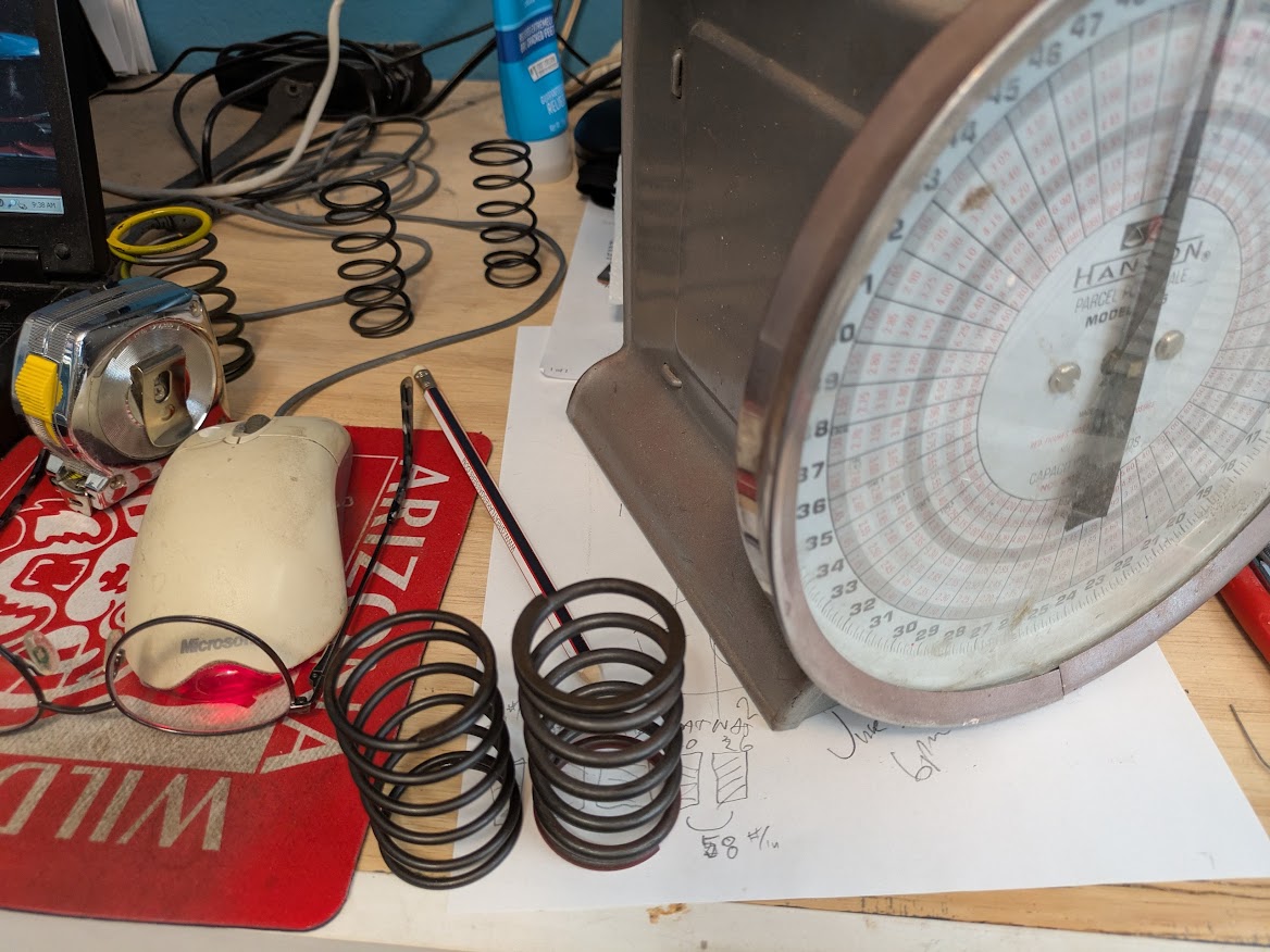

    I played with wastegate springs today, trying to get a feel for the numbers of how they work. Installed height, seat pressure, lbs/in, piston area, valve area, etc. I think it all adds up, if I figure it was getting about 3-4 psi exhaust back pressure at the wastegate at 5 psi boost, then that would be enough to open the valve with the soft springs that were in it. I put in the next heavier set of springs that should end up roughly around 10 psi, it might be 8, it might be 12. I'll see when I go for a drive, if I have enough road, that is! And there's one more heavier outer spring that should get it up around 15, if my math is right. But I don't want to go there quite yet.

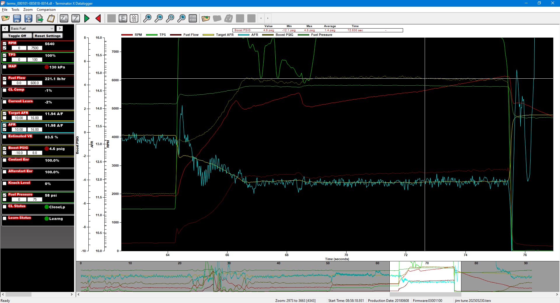

    Anyways...back to racing...I found the datalog from my 11.44 p*** Friday night. The file management system is taking me a while to figure out.
    you can see I got off the throttle a bit when it was getting squirrely in second gear. But otherwise it looks kind of like it should?

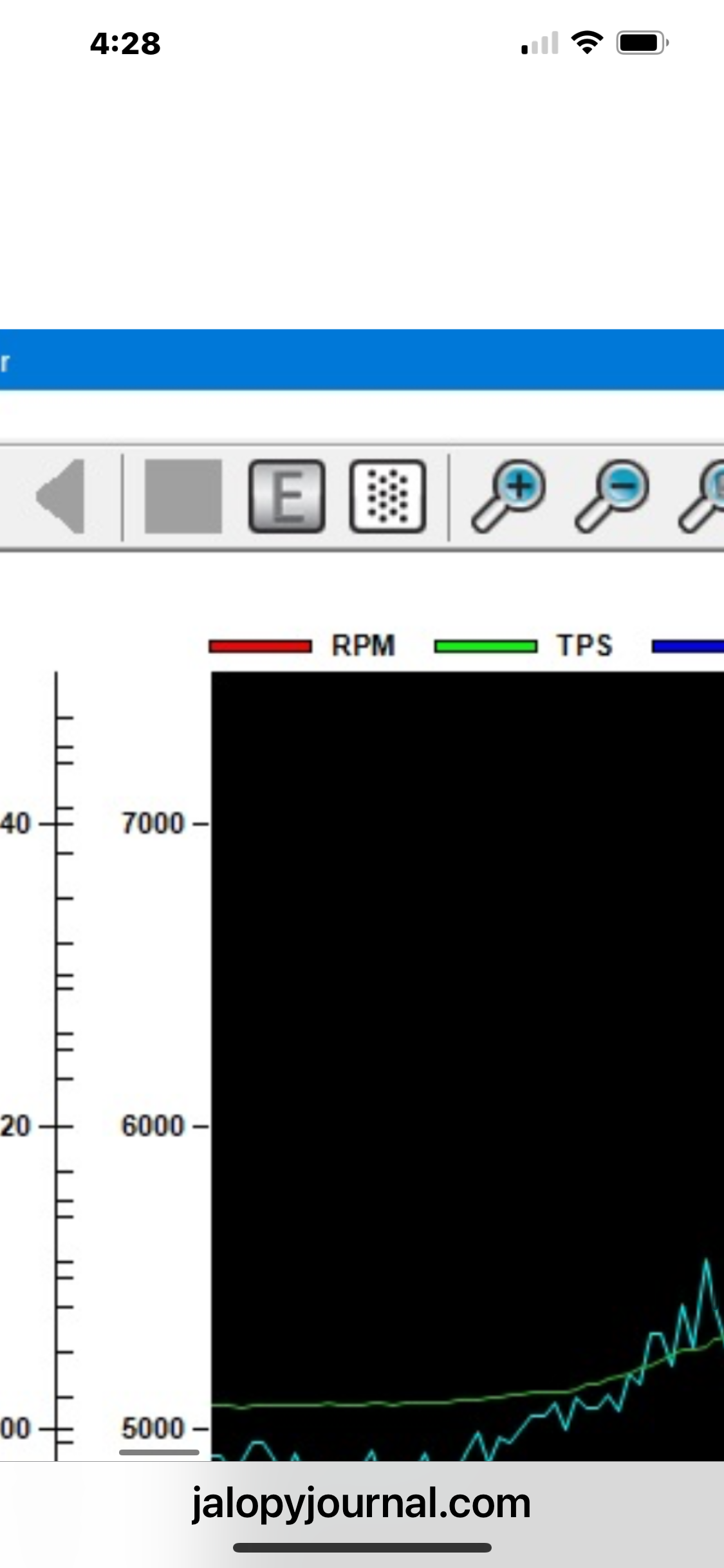

    Its been several months ago for me but I stumbled upon it I believe it's under one of these two drop downs
    To change to PSI , & I believe
    Its where you can change Chanel's to be seen in graph..
    It's easy but I cannot remember,

    Again, peanut gallery. Seems the data shows boost. It also shows Target AFR which is a good 2 UNDER the Actual AFR. I get the feeling the computer isn't using the boost signal to enrich the fuel curve properly. I'd be leery of running that much leaner under boost.

    Thanks for pointing that out. Made me look again! but it turns out the difference is the scaling. If you look at the left column, you see that the box is checked for AFR scale, but not Target AFR scale...and the two are set to have different start and end points! When I set them the same, you see the two are overlapped pretty well.

    Just a pic of my screen that I took some time back , Maybe it will show / help to
    Locate the drop down for PSI & other , still playing with , I was dealing @ time with Lean bog @ first hit , then Rich .

    Thanks, I finally figured out what you're saying and how it works. I forgot that boost psig and MAP are two different things. That configuration table also appears in the gauges thing I was playing with a few days ago, I didn't realize it's a different one, that works the same way in both places.
