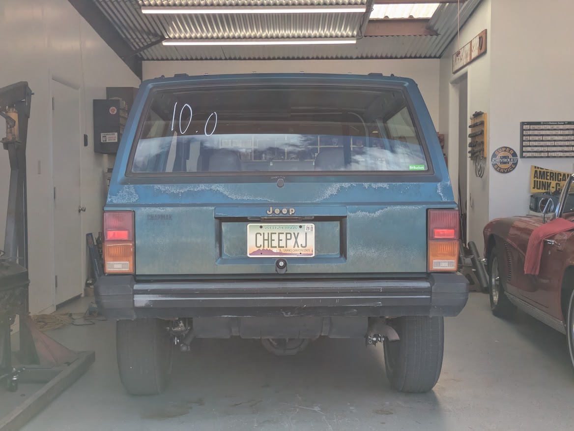

    yeah, we'll see what happens.
    new tag came today

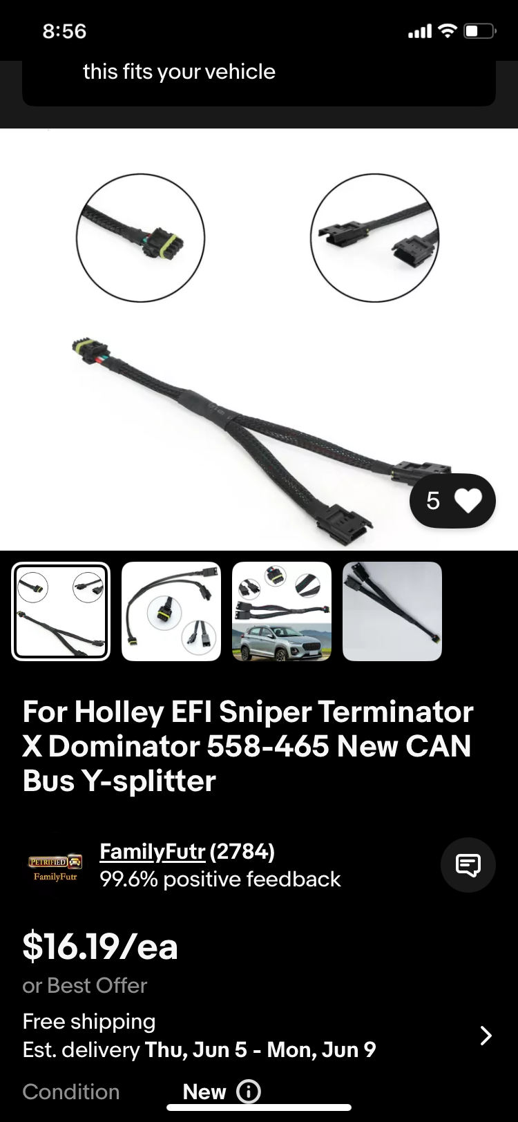

    https://ebay.us/m/MBQaHH
    Jim here’s a splitter cable so you can run the small screen and laptop. IMG_5606.png

    thanks, I have the cable already, it's just a matter of not being able to deal with a laptop while driving. I use it all the time when I'm stopped, to load tunes and save tunes etc. and my kid has datalogged with it while driving. I just need a way to mount the computer so it stays put and is accessible. The small screen has that going for it, but not much else.

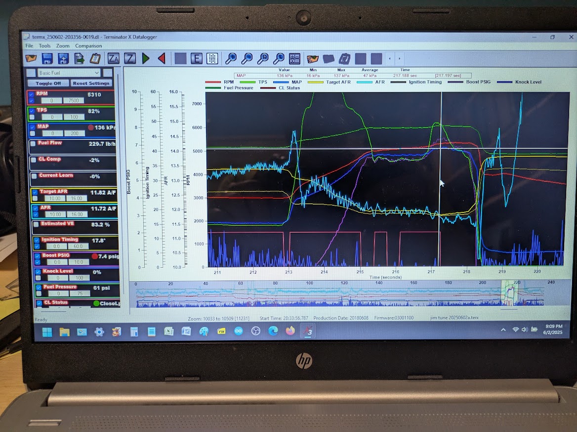

    Here's a datalog snapshot from the drive I took a little while ago. When I open it up at 60 mph, about 3000 rpm, it doesn't spin the tires. But it gets going faster than the speed limit pretty quickly.
    looks like it got close to 8 psi boost.

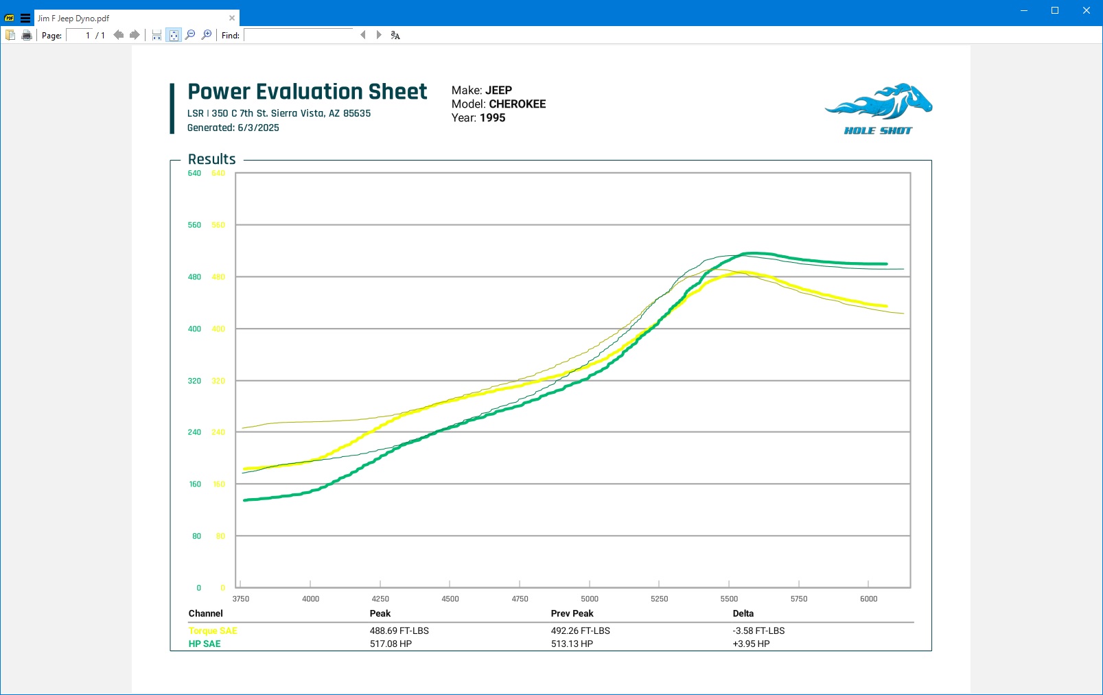

    The dyno session was fun. Didn't change the tune at all, but learned a lot.
    here is some data from the last pull

    Impressive #'s Jim.
