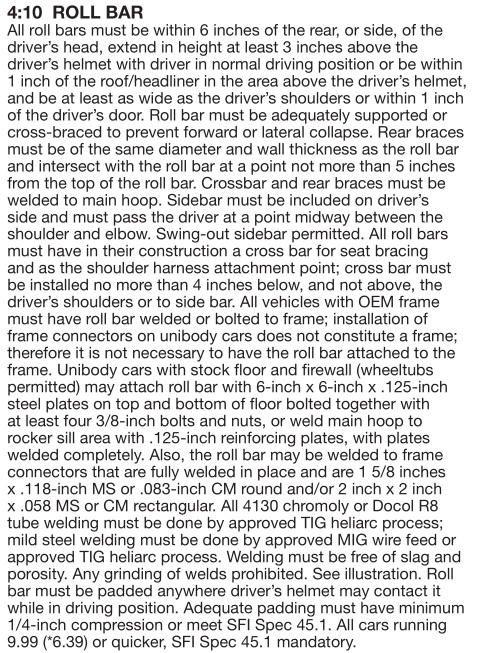

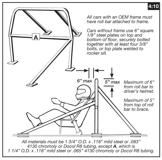

  16. Jim, I believe the Lakewood style bolt in bars are still legal. One back brace and an added driver side . No, you don't need a p***enger side bar. All that extra stuff has been added over the years for rigidity.
  17. Denny, Nope .Not required for 11.49 to 10.0.
    Unit body just has to have welded in floor plates.
  18. squirrel
    Joined: Sep 23, 2004
    Posts: 60,988
    squirrel
    You can bolt the roll bar ***embly into the car, if it has 6" square plates on the bottom, and you can put a matching square plate under the floor. Which is not so easy to do on many cars, but probably is possible on this one. I just welded them in. You can't really install/remove it because the downbars all get in the way of moving it, once it's all welded together. And the bars have to be welded together, as far as I can tell.
    Thor1, Tickety Boo, dwollam and 4 others like this.

  21. General info , for those interested.
    Somewhere in that guide, it mentions padding, where ever the driver could come in contact with the bar, i.e. on the side bar and on the driver side of the main hoop . Also a head rest, but usually a high back bucket seat will suffice.
    Once you have a bar, you'll need a 5 point racing belt, whether or not the ET requires a bar in the first place.
    rod1, 41 GMC K-18 and squirrel like this.

    Padding is only where the helmet can contact the bar, so the side bar doesn't need it.
    I built head rests into the roll bar/cage on the older cars I had with low back seats. This one has high back seats. And it also mentions that you have to bolt the seat back to the lower cross bar, which I did.
