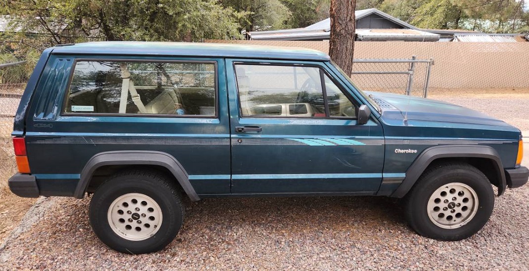

  6. Those 2dr XJ Cherokee's are lighter than they look. There's more than a handful out there that are turbo LS powered.

    The 2 door XJ is also kind of tempting the value thing...a trashed 4 door would be better, but the 2 door is about 50 lbs lighter.

    The XJ was available 2 or 4wd, the suspension was the same, but the 2wd had a "dummy" straight axle, with different spindle ends in the knuckles. Removing the guts from the front axle gets you most of the way there. And I've been thinking about other ways to deal with the front end, including a dropped axle.
    One big advantage is that there's a lot of room in and under for stuff, no need to get into the floor pan to add an overdrive, etc. And you can fit exhaust, and lots of other things. Roll bar would be easy to install.

  20. Definitely want a cage in the XJ as the unibodies are known for being a bit flexy. Doors often pop open when offroading in stock XJs.
    Suspension would be pretty easy since they are coil springs. Throw some double adjustable coilovers on all 4 corners and maybe some tubular link bars front and rear. An Explorer 8.8" out back, same wheel bolt pattern and perfect width. I even think there are bracket kits out there to swap 8.8" into XJs.
