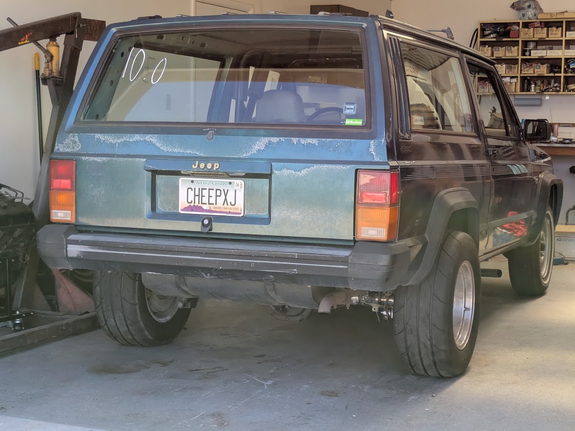

    I got some new boots for the back, and wheels too. 15x8 wheels with 3.5 back spacing, and 255/60R15 drag radials. The wheels are cheezy cast "modular" with the fake rivets around the outer center, so they were cheep.

  5. RMcCulley
    Joined: Aug 20, 2023
    Posts: 349
    RMcCulley
    Nice license plate!

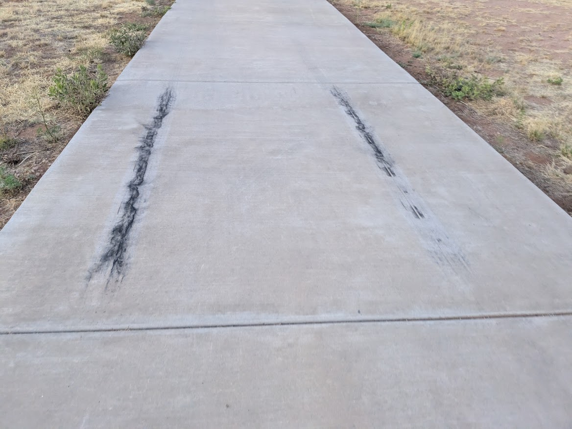

    I took the line lock out of the Vette, and put it in Cheep.
    And had to do a little test burnout to make sure it was working.
    Then of course, get it warmed up and see how the new tires grip on the street. Pretty well, actually.
