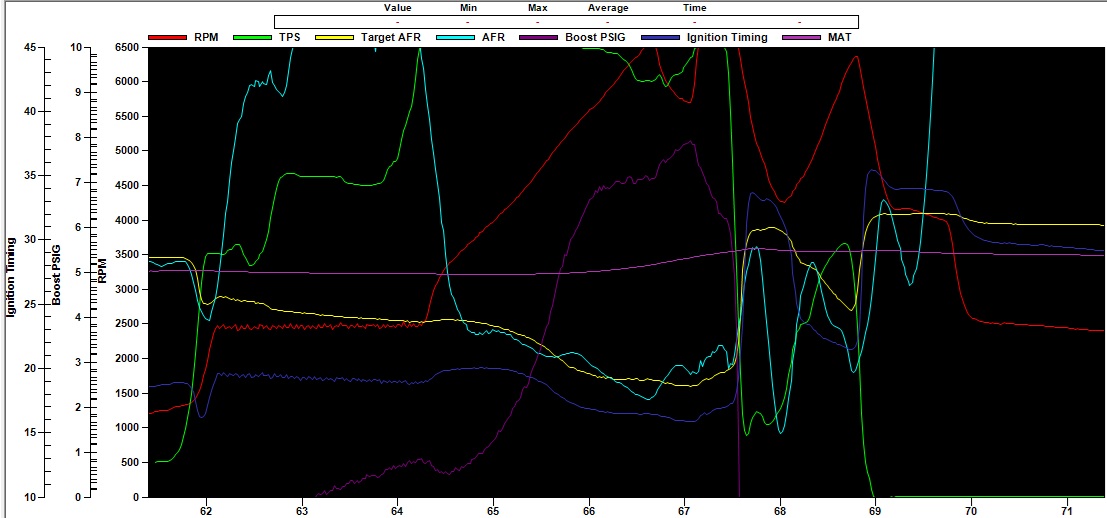

    figure out what this is saying

    RPM went off the chart. Looks like 62 to 64.5 along the bottom shows a 2450 stall or limiter.
    AFR and target AFR don't seem to be in the same scale. Misfire during stall? They are close during the run, but not before or after. I'd expect the center top to bottom to be stoch (14.7) or Lamda (1.0) and you want richer during the run.This is reflected by target, but actual goes super lean during the stall.
    Boost looks okay, developed a bit during stall and it rose with RPM.
    MAT is not looking useful. If you can get wheel speed or knock, they might help more.
    I ***ume 67.5 along the bottom is where the stuff hit the fan.

    I think that was the time that it went "zing!" and I ended up cruising to the turn off.

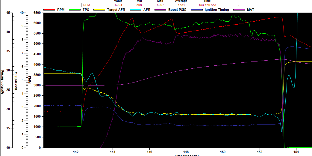

    I was thinking about it this morning, and sure enough, the log from Tuesday told me the transmission was going away, I just didn't see it.
    here it is...look at the red line showing RPM as it drops after the first shift, it takes a while to settle into place.
