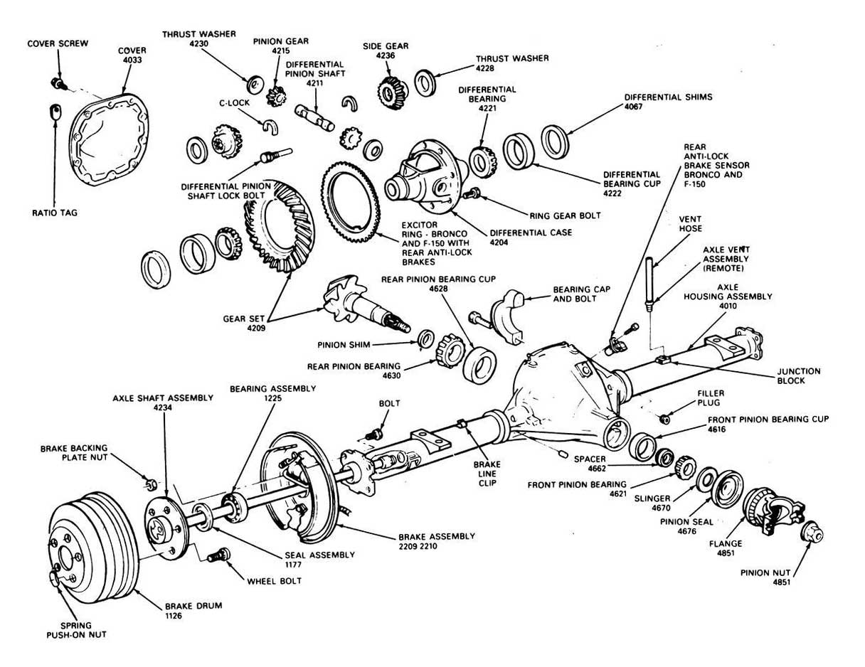

    Anyways, to the rearend. With the car running 126 mph, it's close to red line through the lights. So I'm working on installing the 3.27 gears to replace the 3.73 that is in the 8.8 Ford rear now.
    But I can't get the pinion out! I removed the nut, then pulled off the flange, then put an old nut on the threads of the pinion gear. Beating on it really hard with a big hammer, it has not budged.
    now what do I do? :)

    Front bearing seized to pinion? Can you get the front bearing out with a hook?
    The view looks like normal parts in normal positions. Only other thing is the spacer wedged or stuck, but that should still allow the pinion to move around...

    Reading old posts on mustang forums, it can be a real ***** to get the pinion out of the front bearing on the 8.8.

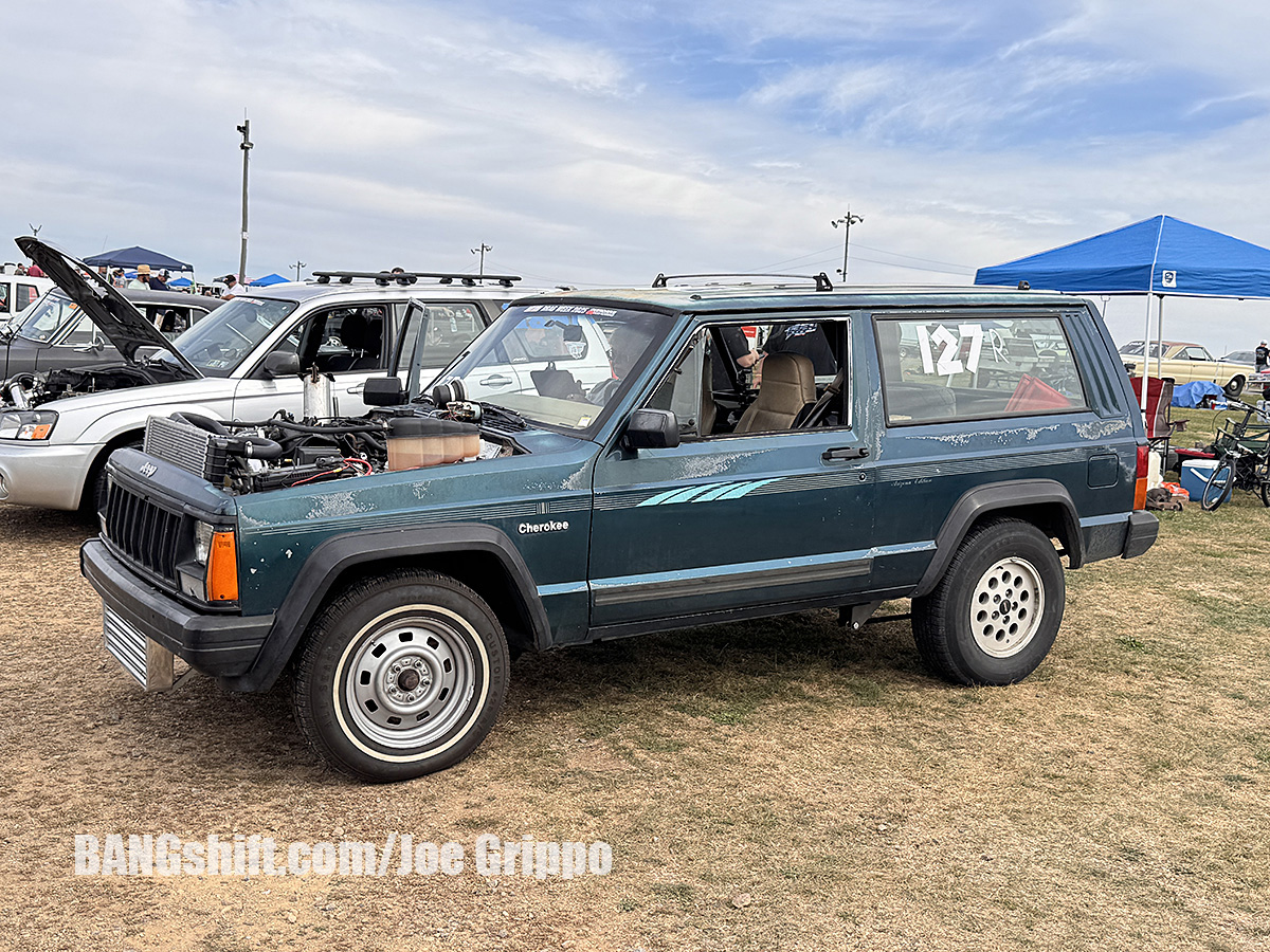

    Hey Jim what did you think of the kids Eagle wagon with the 4.0 AMC/mopar/Jeep turbo setup? I see he ran a 9.51 on the last day of DragWeek…

    Oh...the Eagle wagon, killer car! I love it
