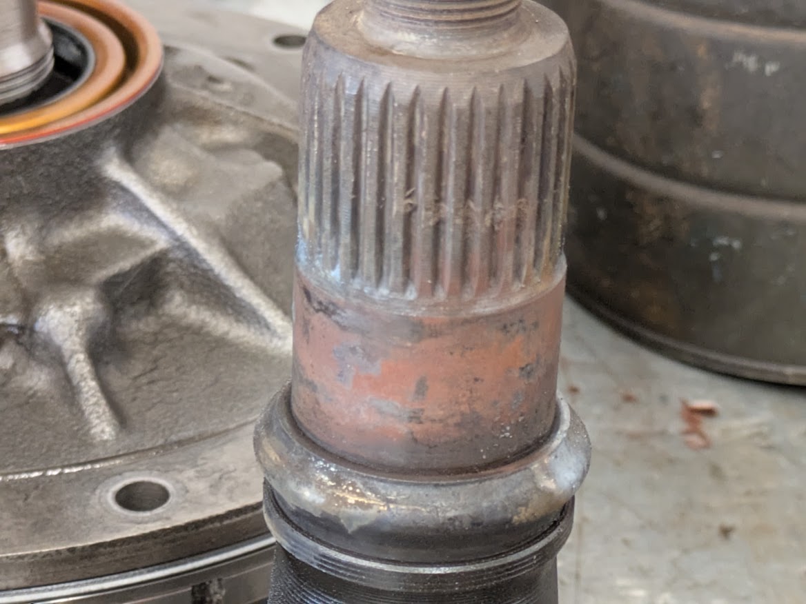

    A closer look at what was holding the bearing onto the pinion.
    The new used pinion is in great condition in this area. Strange.
    Also, the rear bearing pressed off easily.

    Oxidation of the **** Doc?

    Looks like the signs of brinelling to me.
    https://en.wikipedia.org/wiki/Brinelling

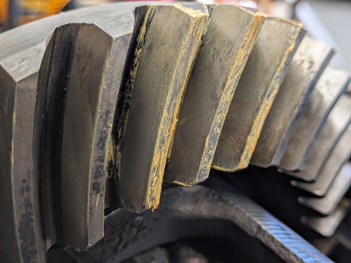

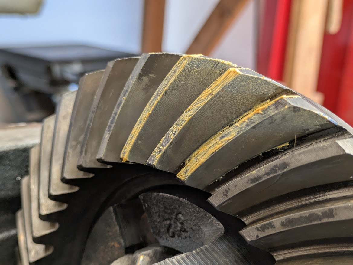

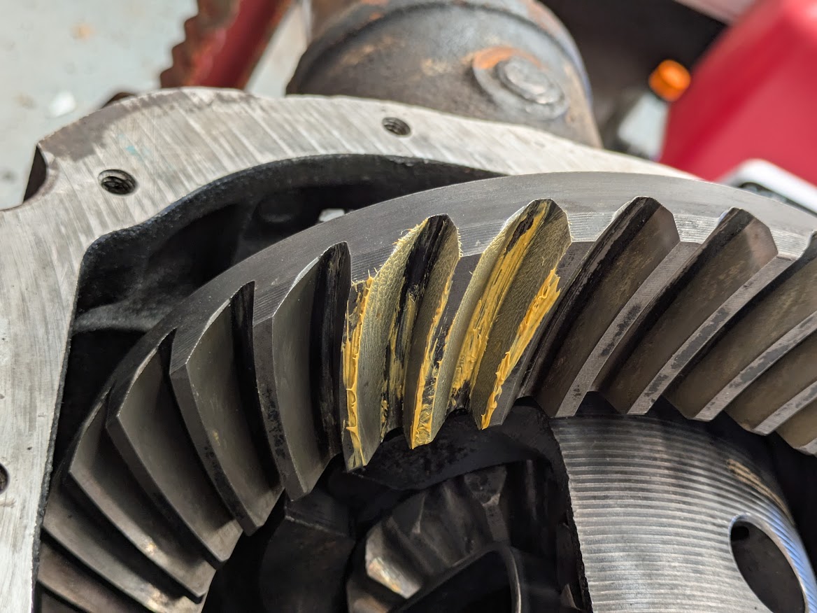

    back to work...first try with the rear end setup was pretty bad, using the shim that came on the 3.27 pinion. So I tried the much thicker shim that was on the 3.73s in this housing, using the original side shims, and get this...I think it'll be ok. But I'll do some more staring at it, I might try some different compound to see if I can get a better imprint.

    this is the final pattern, after setting the pinion preload. Backlash is about .011

  17. I usually have good luck reusing the shims out of the housing. Im having a hard time reading the pattern with that marking compound
  18. Just saw the update, looks good

    Yeah, it turns out the shims that were in the housing put it right where I want it. Thanks
